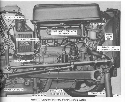

My dad's Ford tractor (4000 or 4100) can't remember for sure, but anyway his steering arms & brackets keep breaking. This tractor has the aftermarket power steering kit on it. Does anyone know where to find parts for these tractors? Around here parts are getting hard to find, even at tractor grave yards.
He even mentioned converting it back to manual steering, because the power steering setup usually breaks several times a year. The parts have been replaced at least twice in the past couple of years, about $300-$400 each time for just brackets and arms. Usually when it breaks we weld it up until it can't be welded up anymore. It is at that point again. Any ideas?

Is the attached photo similar to your steering system? Can you be a little more descriptive about the type of breaks in the steering arm? Can the arm be welded or reinforced? What type of shock mounting does the hydraulic ram have? Remember on standard steering the steering wheel will move - sometimes violently- when a wheel hits something. With addon power steering, the hydraulic cylinder holds the arm fixed, so it has no choice but to break under shock load. I'd suggest your Father either go back to non-power steering or figure out a way to shock mount the third-party steering. Otherwise, if he makes the steering arm stronger, something else might end up breaking. /forums/images/graemlins/shocked.gif /forums/images/graemlins/frown.gif

The picture is similar. The power cylinder is on the left side (from operates seat) of the tractor.
There is a L-shaped bracket that the power steering cylinder mounts too. It has broken several times and has been rewelded many times. There is no room to gusset the L-bracket which would definately help handle the stress on this bracket. The L-shaped bracket is two flat pieces of steel welded into an L. One piece is about an inch thick, and the other is probably closer to 5/8 or 3/4 of an inch, can't remember for sure. Usually this piece breaks at the weld, but it has also broken at the bolt holes that hold it to the tractor. It has three bolts that bolt it to the tractor.
The steering arm on the left side continually breaks, also. It attaches to the spindle and the tie rod & power steering cylinder attach to this side (from the best I can remember). This is a cast piece which continually breaks around the keyway for the spindle. This is the second or third steering arm. Depending on the break they can sometimes be welded. We tried welding it this time, with no luck. The steering arms are getting harder to find around here.
