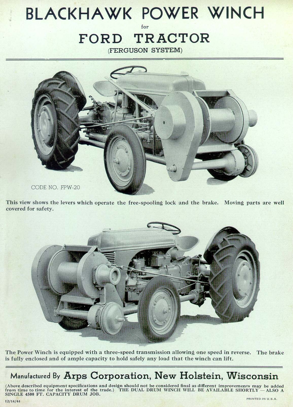

Anything is possible but it might take some doing to get the pto shaft to the front. On my 4000 HD forklift it has a universal hooked up to a front crank shaft pulley to operate a pump which could also be converted to a shaft. You would also have to check if the rotation is the right way for your application. I know the later ford ran a sweeper broom off the front but not sure of the hook up.
