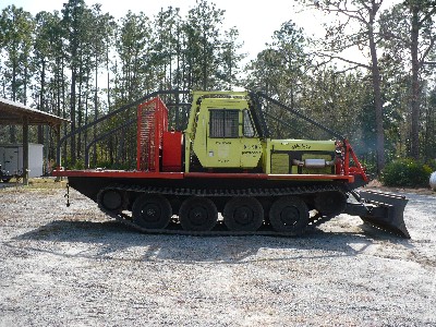

Considering trying to purchase this '95 Foremost Nodwell 240 at auction. Haven't seen in it person but listing says it has minor leaks etc but otherwise very operational. Currently waiting for some answers to specific questions concerning the unit...hours, known issues, maintenance, repairs done etc. Parts and service are available so this is a plus. They appear to be very heavy and well made but don't have any personal experience with one.
Has anyone been around or operated one (or any of the other Foremost models) that can offer any opinion on build quality, durability, weak points etc? I really don't have a need for this machine but if the price is right and I don't find anything too concerning with it, I am probably going to bid on it. Any thought or information would be much appreciated.

No, looks like a fixed blade. Looks like a beast. What are you thinking about using it for?
