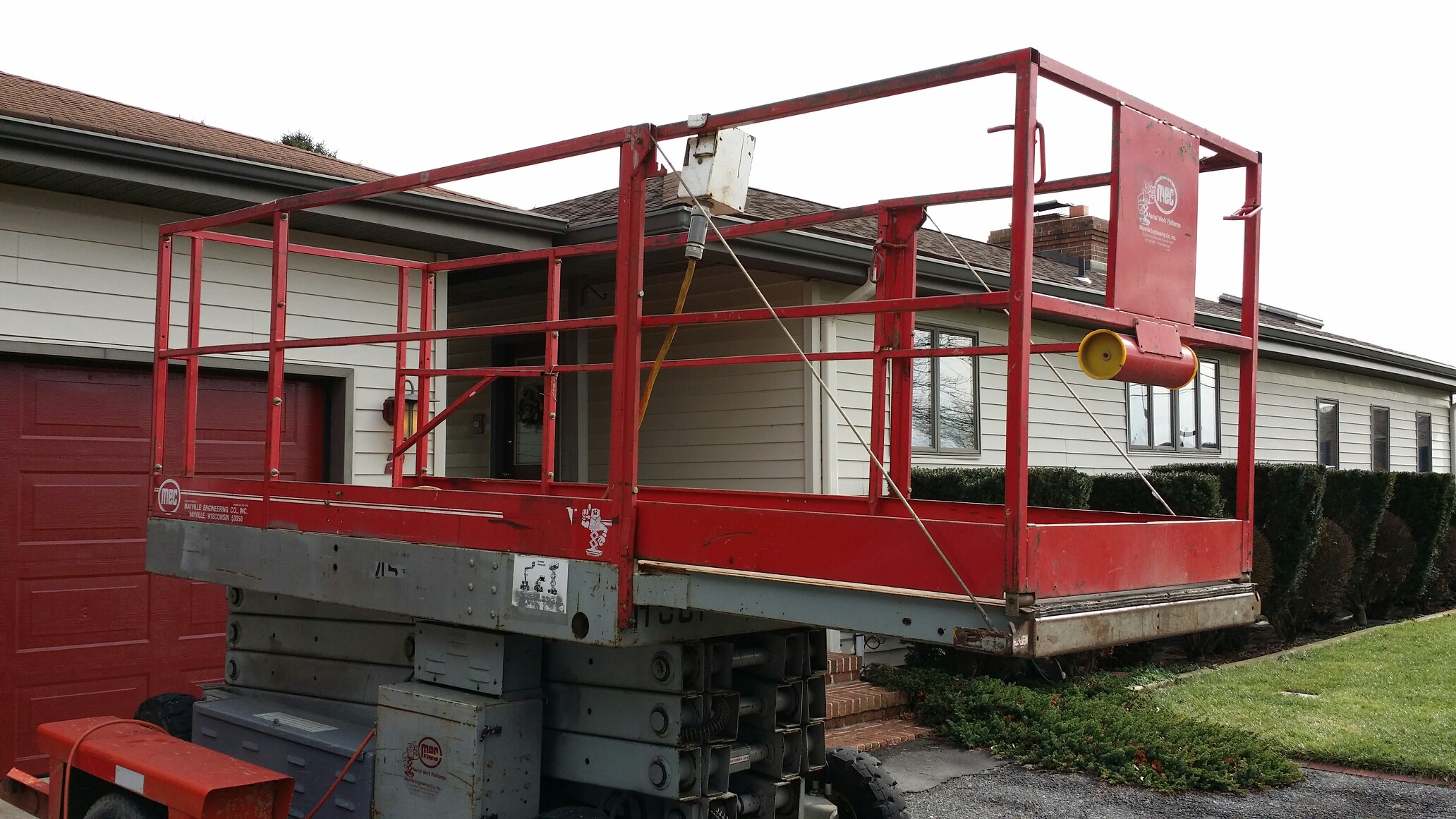

First off without knowing what the manual says I would hazard a guess that you should be checking the batteries once a month for proper electrolyte level at which time you will notice if the connections need attention. That's all a wild guess without knowing what your manual says which should have a maintenance schedule you should be following.
Not sure how many batteries you have but I had a good size scissor lift that used six 6v batteries and that is what I did regardless of how much action the lift saw in any month. It was once a month inspect batteries, clean connections as needed, and charge. If the lift was used then charge after use at end of the day.
I would imagine your forklift would not be much different with regard to battery maintenance.
