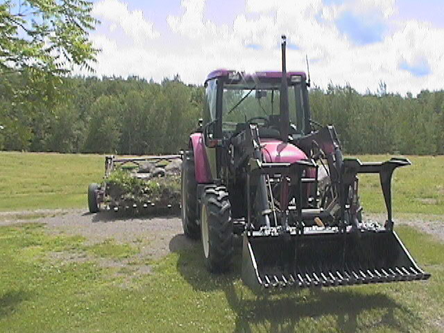

Here is a gadget that makes your tractor a skid steer loader.
Will it Fit My Machine
No recommendation to buy there but site has good educational content. SS attachments range from really light weight to indestructable. You want to match the tool to the loader, the tool should bend before the loader arms do. It's easier to beat on the attachment to straighten rather than the loader.
Handling logs with forks are easy, even better is a grapple so the logs cannot roll. I have a grapple on a SS rock bucket with proprietary QT plate welded on in place of the SS QT.
You could order SS attachments with no attachment plate & weld on the Deere QT plates.
I bought an old Deere SS earlier this year & it has a old pre universal proprietary QT system on it. After getting a really good deal on a couple of SS attachments at auction I simply brought the machine and attachments to my local blacksmiths shop. Next day I had a steel plate that matched the Deere on one side & universal SS on the other. Instead of levers, pins & springs it uses (2) 1/2 inch bolts. $178 and do not loose breakout or lifting leverage.
pix of rock bucket and rock picker pulled behind..
