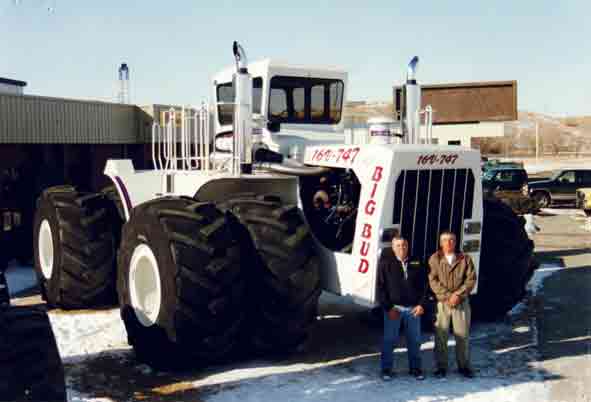

You can never have too big of a tractor, so when you decide to get a new one...get one of these:D:D
Can you get a belly mower with that?;)
EDIT: When my house was being built, they delivered sheetrock on a flatbed truck with one of those little "tag-along" forklifts on the back. The driver was hauling full pallets of sheetrock and lifting them up to the second floor. I asked him what the maximum lift was and he said it was around 6,000 lb. It's easy to think our CUTs should lift more, but a speciality forklift can run circles around most of our tractors. They do one thing and do it very well.:)
   / Forks lift capacity /lifting 1/2" plywood bundle?
#9
Nice machine- but where does one get attachments?! and what is the gallons /mile spec on that rig?!:eek:
   / Forks lift capacity /lifting 1/2" plywood bundle? #10
You could probabally special order a 150' batwing mower. Sure it might use 5 gallon of fuel in 5 minutes....but think of it as gallons per work done. 5 gallons in 5 minutes to mow 5 acres isn't too bad:D
