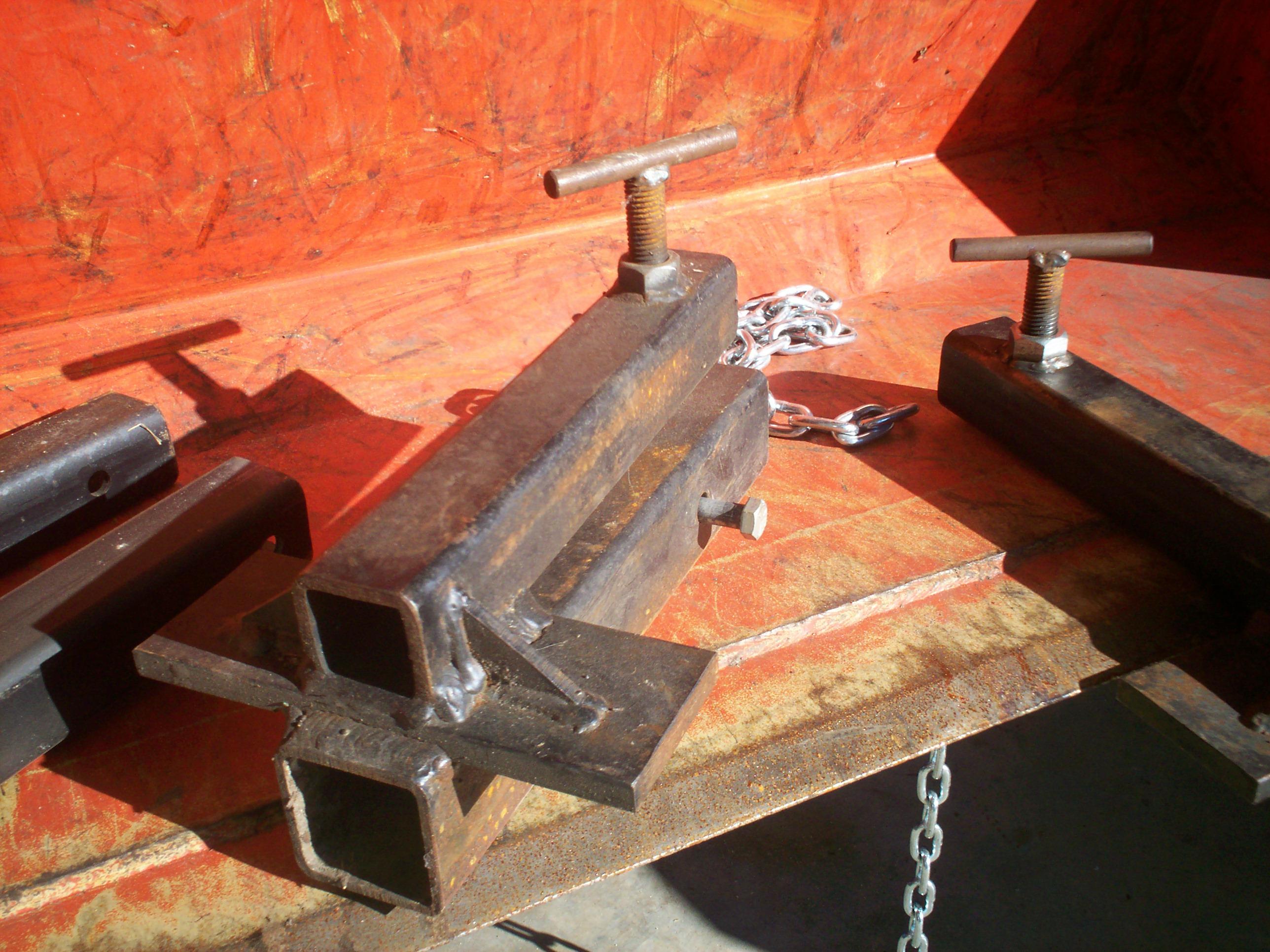

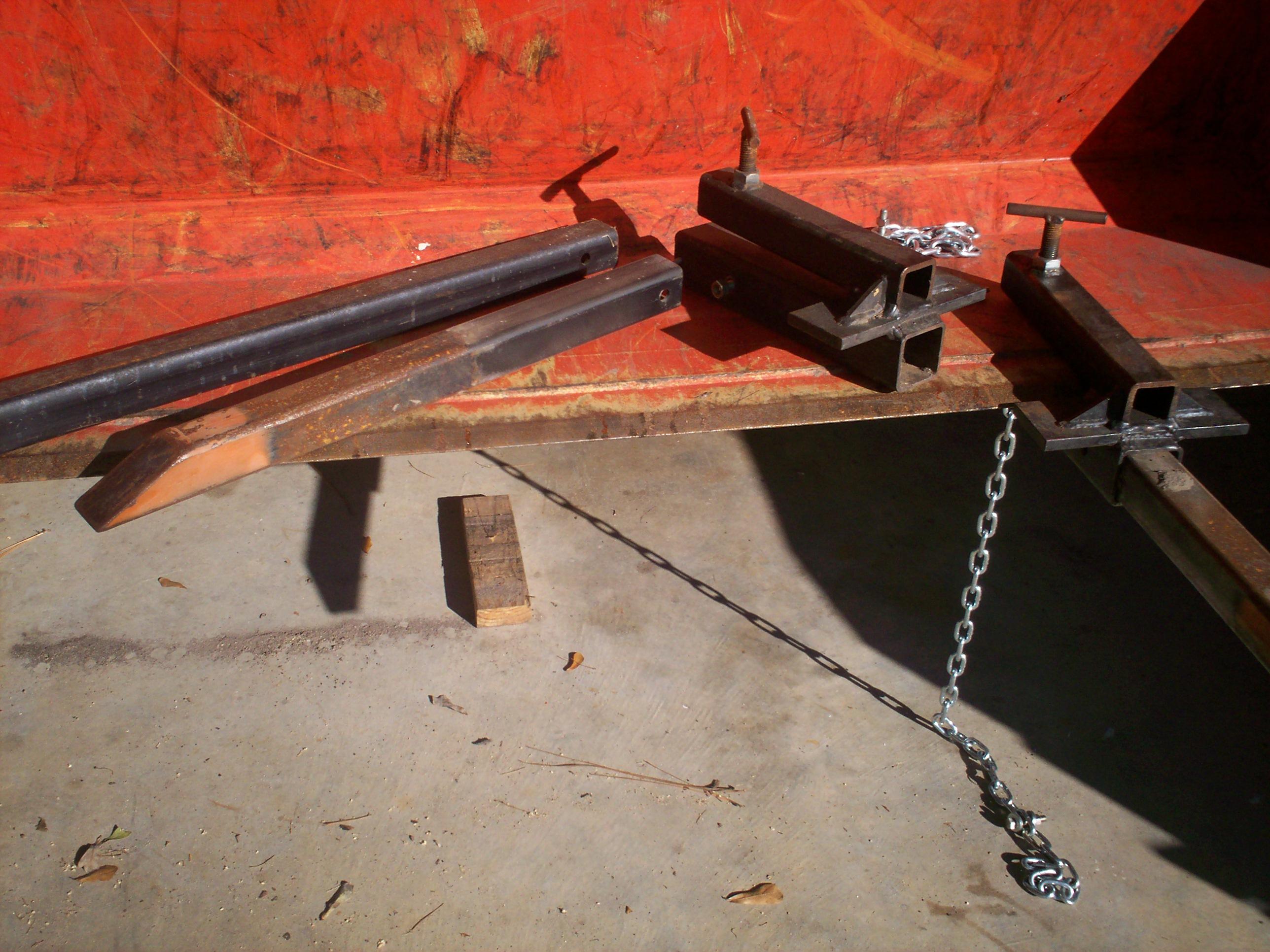

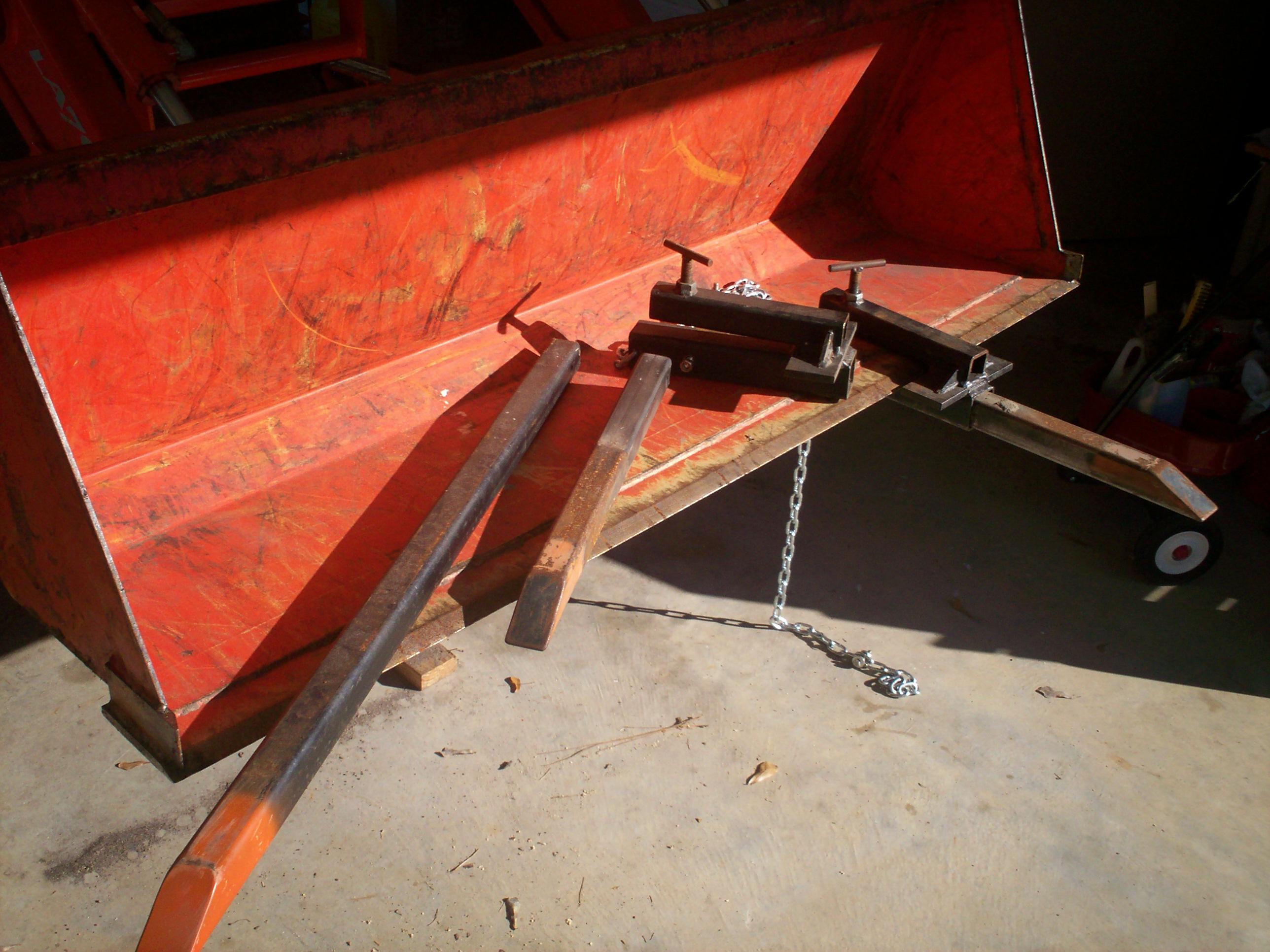

I recently read a thread on adding forks to a FEL, but now that I have pictures of my attempt, I can't find the thread.
My 2 in. receivers slide over the FEL cutting edge and secures tight with a twist bolt and chains to the back of the bucket so the receiver can't slide foward.
Once the receivers are attached anywhere on the bucket, I can insert the 18 in. or 36 in forks which bolt or pin in the bottom/back of the receiver.
Any device which fits a 2 in. receiver can be used, such as the truck's trailer ball attachment which I failed to include in the pictures.
The 18 in. forks are used for logs,etc and 36 in. forks for pallets and such.
Hope whoever had the previous thread still has an interest.
Thanks.

I like that and if you had a few more you could have a tooth bar, Check out my gallery, I build some things also
