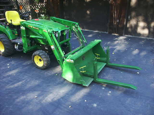

Another view
   / Forks #2
Where did you get the yellow clamps that seem to hold it in the bucket?
   / Forks
I welded long nuts onto the rear and used all thread with welded on steel rods for the handles. I also put a lock nut with rod handles on. Painted them yellow.
