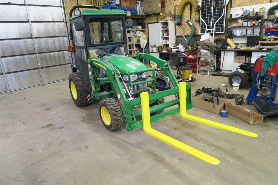

I have a similar pair of forks; I made a frame that will fit on the 3-point or the FEL. It's extremely handy.
Today I used it to lift one end of a 20' container while I dragged it 400 yards to another plot.
I can't count the number of jobs I've done with this over the last 10 years.
Those forks are really tough; the frame had to evolve a bit before it was strong enough not to bend when I did silly things to it.

IF you have to lift the weight of the bucket AND those forks, you won't be lifting much else!
SR
yes to above. the lifting capacity of your size tractor will be greatly reduced having forks extended over bucket, not worth the time & effort to modify attachment.
suggesting salvaging the forks & if you want forks, do it right. good luck

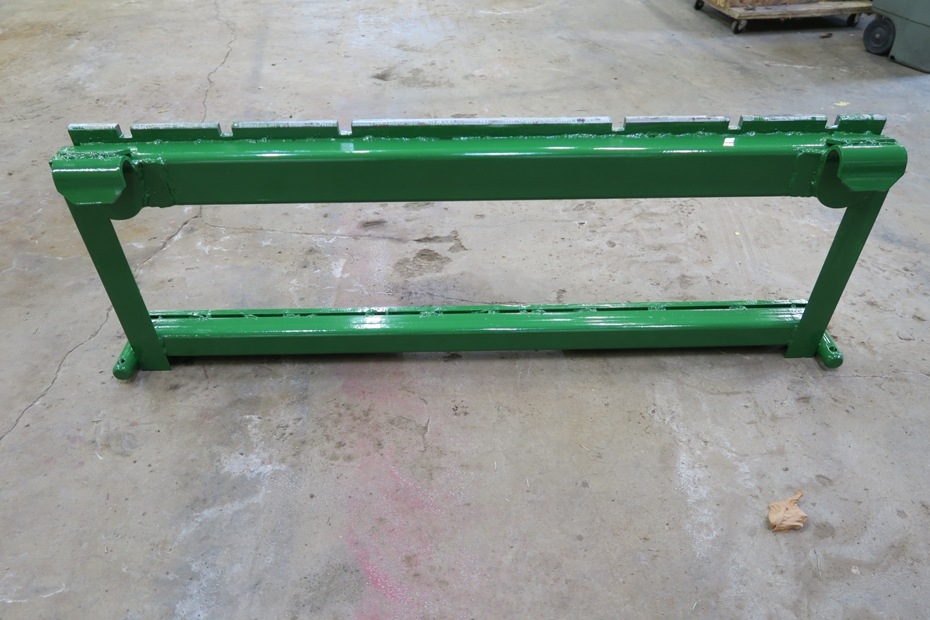

I have a blank skid steer plate with 2 pieces of heavy angle iron welded on. You could use regular flat iron if you needed just takes extra welding. The top one has groves cut for the fork locks. It works well, adjusts a little stiff but the forks do not wiggle. Mounted a camera on the front of the tractor to see what I am picking up.
/ Forks #13
That's a pretty small tractor to put forks on. A skid steer plate would be really heavy. If your bucket is a quick attach, you could build a fork frame to attach to the loader arms.
