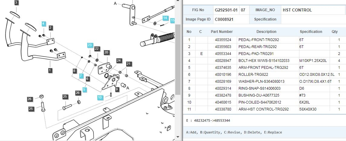

my tractor move forward ok slow . reverse it just movie slow very slow . what is the problem with it
   / forward& reverse #2
Not knowing your model or transmission is it possibly in low range?
   / forward& reverse #3
Is the linkage tight (no loose parts) , adjust correctly and the travel of the petal/linkage unimpeded.
Note reverse is slower than forward by design there is stud that limits reverse pedal travel.
   / forward& reverse #4
You probably have a broken roll pin in the pedal linkage. They sometimes break and you get excessive free play in the pedals. Replace it with a 6mm bolt instead of a roll pin and it won't happen again.
have not worked on this any more it at my cabin up north the 6mm bolt what lenight is it thank you for your help have not found rollpin yet my tractor is apart have not found the pin yet just work on it when i am up there going back north again soon thank for your help
   / forward& reverse #8
Click on the picture below. Number 10 in the picture
   / forward& reverse #9
When did you last change the HST filter?
