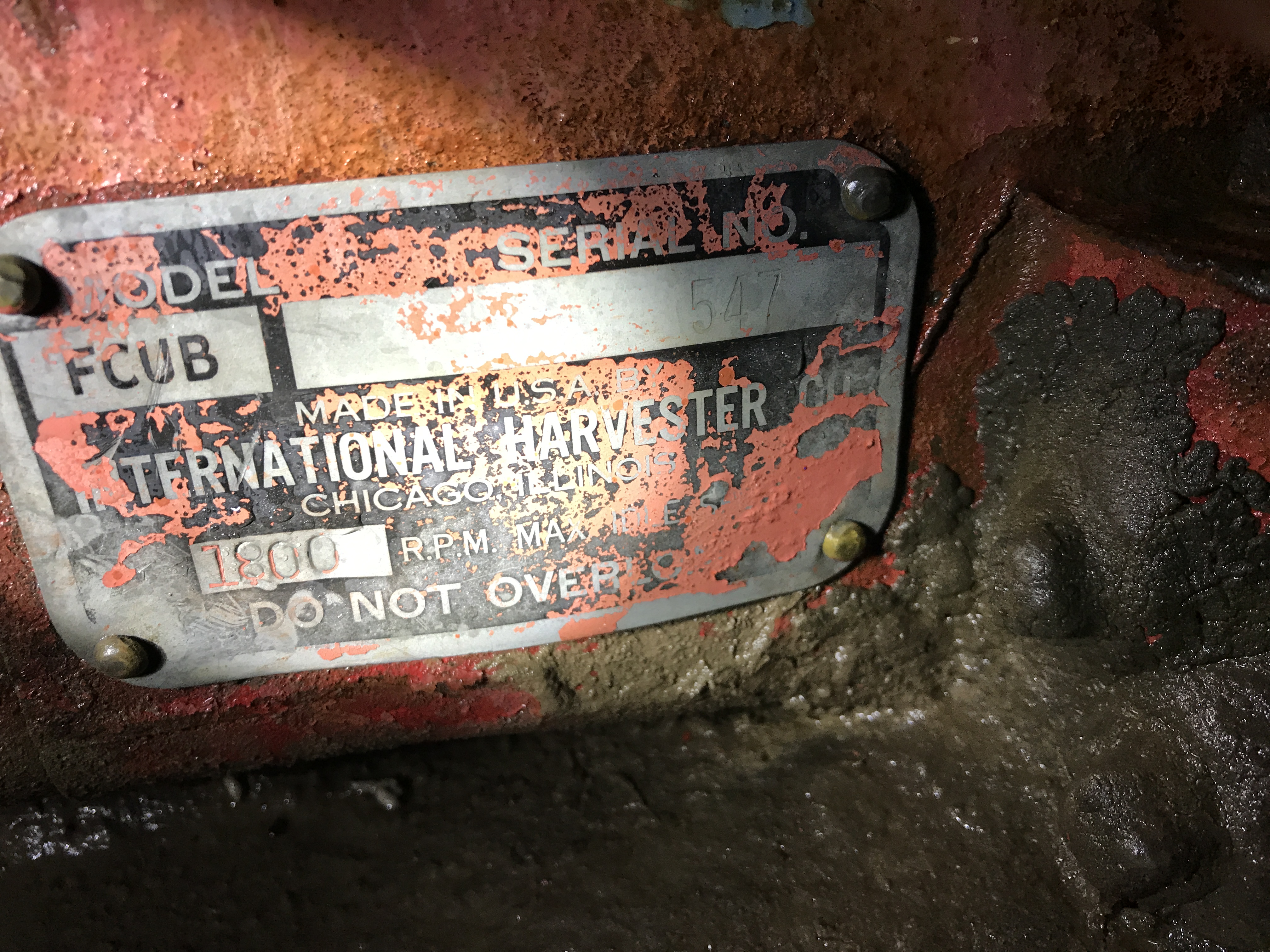

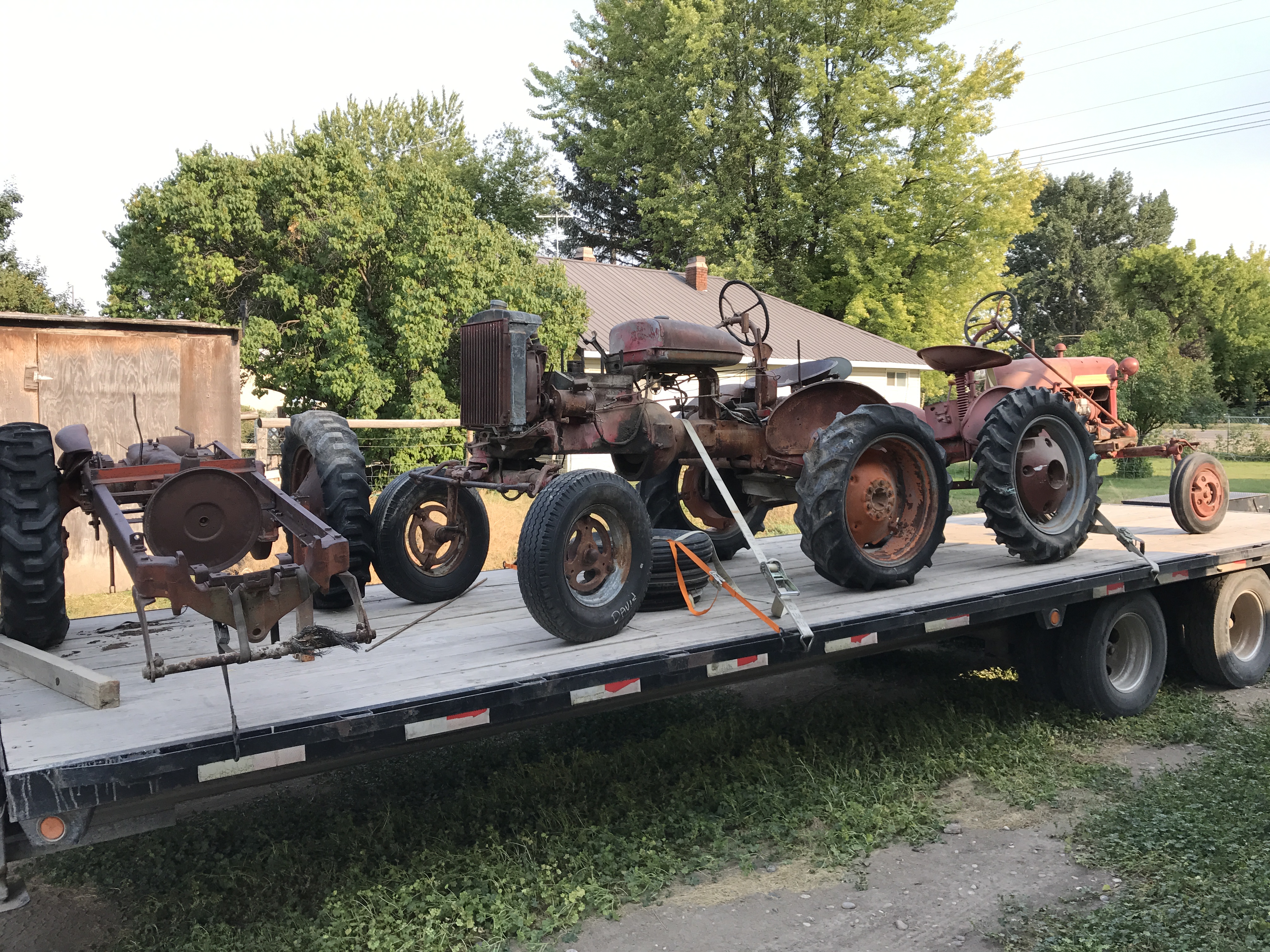

I bought an auction lot a few weeks back. It was "everything under the loft area" in a large workshop on a farm. There was all kinds of stuff in that pile, and underneath everything were two tractors. One is a Farmall A that is in pieces. I think I have most of the pieces spread out in various boxes that I brought home from the auction. The other is a Farmall Cub that looks to be mostly complete. As near as I can tell all I'm missing is the muffler and the carburetor, and I think I have the carburetor in one of the boxes of parts that was included in the pile of stuff.
I'm planning to just part out the A, but I'd like to get the little cub running. I've always thought it would be fun to have a cub. I have a very small place (~1 acre), and a cub seems like it would fit in nicely. As with any project I do, I'll likely need help, encouragement, and advice as I go through the process of resurrecting this old tractor.
The cub is serial number 547. If I have things figured out right that makes it the 47th cub ever built. That also makes it 70 years old this year.
I've included a few pictures below of the cub on the trailer when I brought it home. I also have a picture of the serial number plate taken by flashlight last night. I'm open to any corrections if someone can tell me that there are two more digits somewhere before that serial number that I don't see.

Nice find. Does the cub have a hydraulic lift?
   / Found a Cub Under a Pile of Stuff
Yes. I have no idea if it works or not, but the pump is there and the little rocker arm that raises and lowers.
