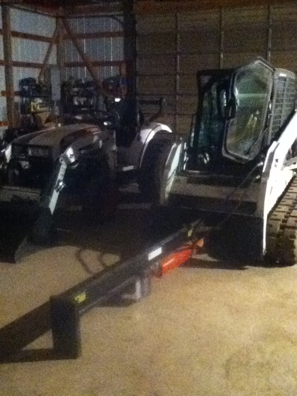

Been four days and 13 hours later no bolts gone and still running great. I think it was just poor dealer ship assembly. Photo from cutting and splitting about 5 cords of wood.
