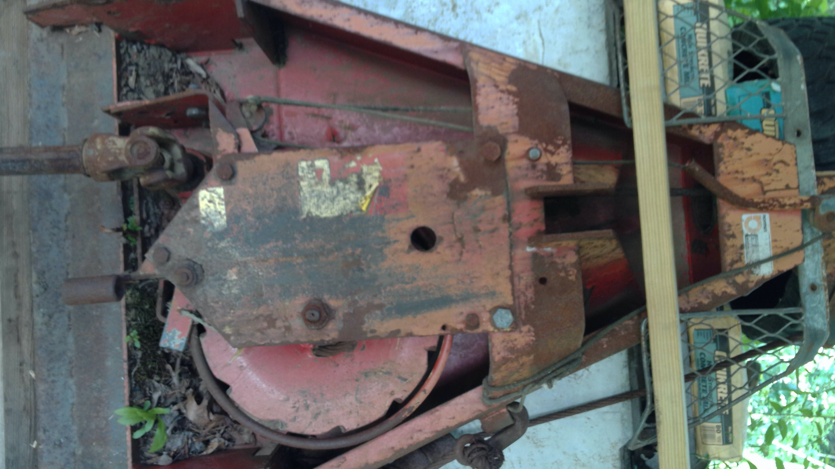

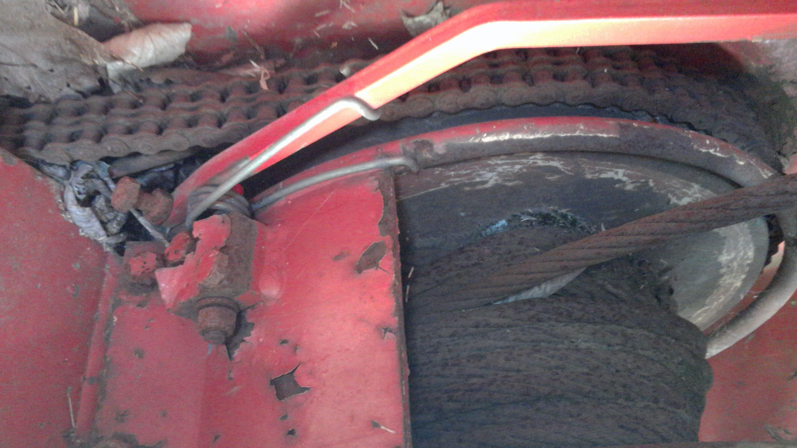

   / Found myself a Farmi 6 series Winch
Here's some pictures for general condition as I got it
Top priorities I think are
-repacking the bearings and looking for any wear items in the drive/drum assembly
-maybe put a new cable in
-addressing the 3ph attachment. Maybe as easy as bushings...

Darn nice find!!! That's on my wish list but they are never for sale down here. Cable doesn't look too bad. Congrats on the purchase!!! :thumbsup:
