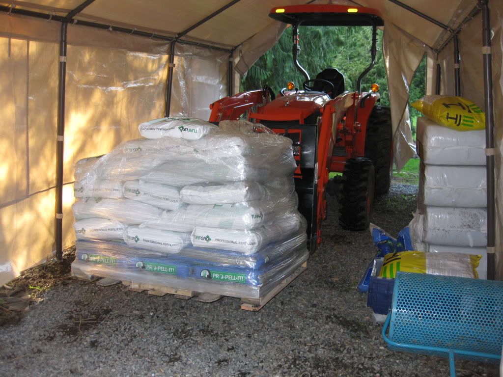

Here's an LA854 lifting about 2400 lbs (400 for pallet forks and that's 40 bags of ice melt (50lbs each).
I only got it about 6 inches off the ground and it was hard to turn the wheels but I got it under shelter. In this pic it's about 4 inches off the ground. Just had to snap a picture. there's a 6' bb on teh back but the wheels aren't loaded yet.
