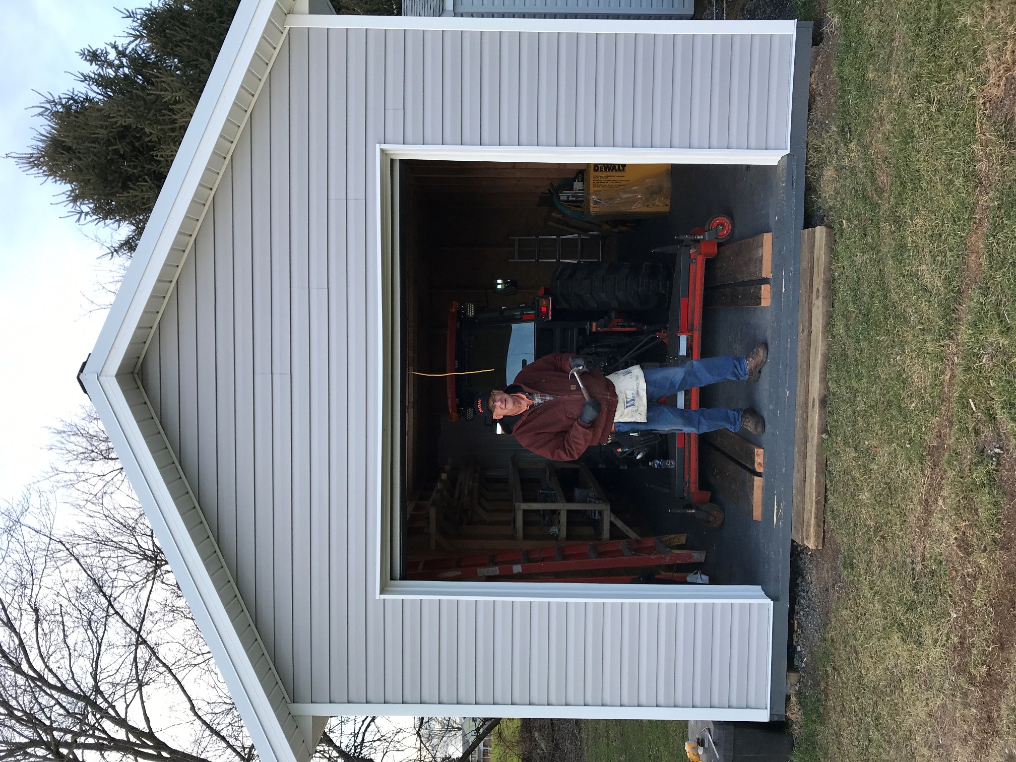

That is the LAST PIECE of vinyl siding for the top of the gable end.
This was a one month project that took three months. I'm not really complaining. I'm blessed to be able to scamper up and down ladders at 70. Shed is frame construction and has vinyl siding and a textured bronze-colored metal roof.
Base is asphalt millings with 4x6 PT sleepers. Then a 2x4 on 16" for floor framing and 3//4 PT plywood. Originally there were going to be two layers of 3/4 PT plywood, but concern about trapping water prompted a change to a few 2"+ fir planks to help spread the load. These were given two coats of waterproofing.
I'll probably come up with something inside to stack some implements, but it feels good to be done with everything else!

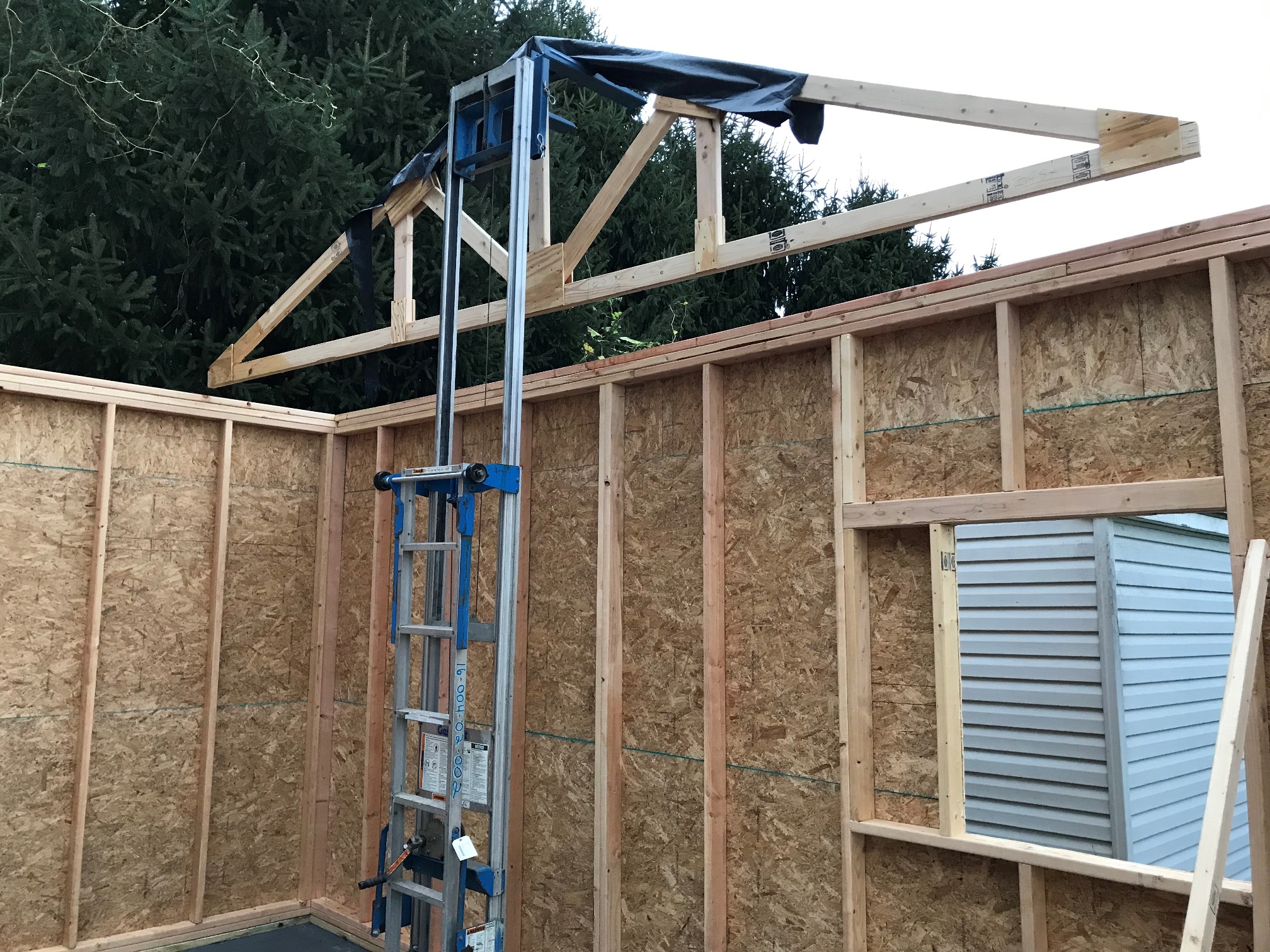

Nice work! What is that rig used to lift the truss?

s219- That rig is typically called a material lift. There are many varieties, heights and capacities, both manual and powered out there. You see a lot of commercial HVAC guys use them to lift large ducts up and hold them in place for installation.

The lift is something I borrowed at work that as dstig1 said, is used for lifting ductwork. This one is too small for most of our projects but it was the perfect size for the shed. With the forks flipped it only goes a bit over 12'. According to the tag on it, the last time it was used on a project was in 2009.

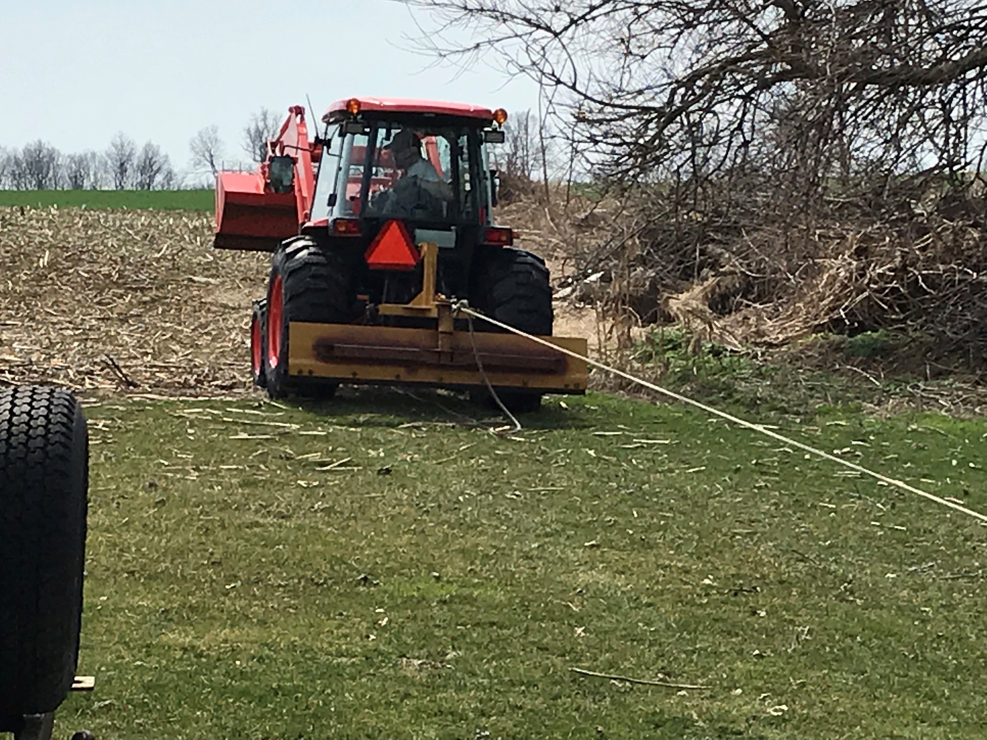

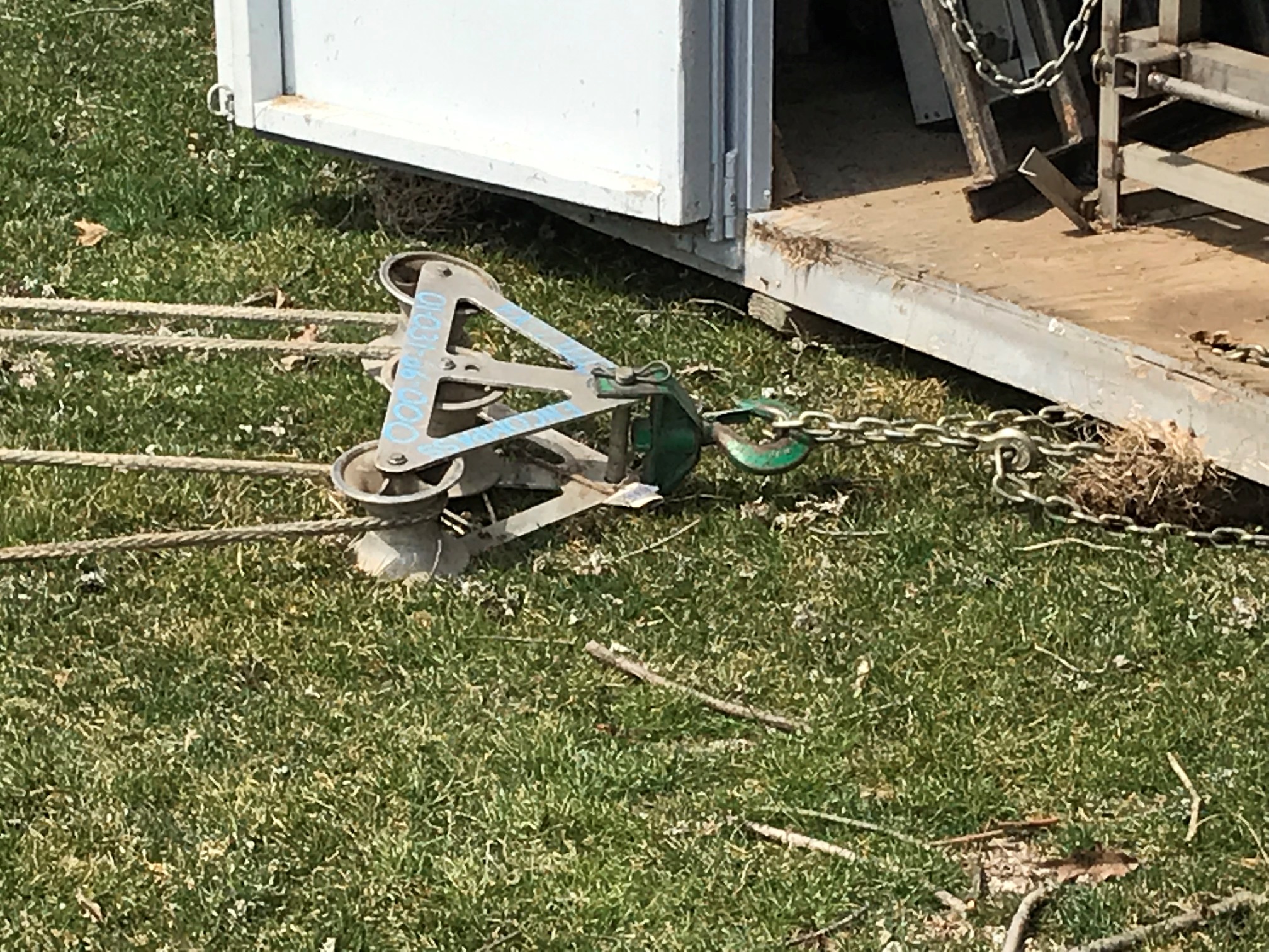

#2 Son got a kick out of piloting the L4240 early last Summer when we pulled the smaller shed out of the way. It took a good strong rope, a decent anchor and a few pulleys.
