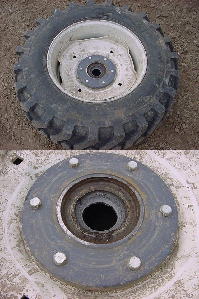

After hundreds of FEL loads at full weight capacity over bumpy ground the grade in the front yard is beginning to look nice. Dug in some french drains over Memorial Day weekend. Did some mowing this morning and decided to smooth out the back fill over the french drains. Was just about finished when the left front wheel fell off /w3tcompact/icons/shocked.gif/w3tcompact/icons/mad.gif At the time I was just back dragging the FEL across the yard while turning the wheel. This is not supposed to happen. I bought the NH loader in order to avoid this problem or over loading the front axle. /w3tcompact/icons/frown.gif
My guess is that the axle was weakened doing all the heavy FEL lifting a few weeks ago (still is a defect and should not have happened) but am not sure why it broke now. Of course I expect NH to fix it under warranty (its a little less then two years old).
Attached are pics of the front axle.

Here's a couple pics of the inside of the wheel hub.

Dave, in my opinion, no amount of loading your FEL should have caused this problem. Your axle must have been defective./w3tcompact/icons/frown.gif/w3tcompact/icons/mad.gif This problem might occur if you leave the tractor in 4WD and do a lot of work on pavement, but even then, you should see tire scuffing rather than a snapped axle. Keep us informed of what your dealer says about the repair.

I agree! I also think the casting must have been weakened/defective. Since I have supersteer I usually leave the unit in automatic 4WD (sensitrak) and am 99.9% of the time working in dirt or gravel.

Just talked to the dealer closest to me and they were very apologetic about my problem. (The original dealer we purchased the unit from has since closed) The lady in service said that it is definitely covered by the warranty and they will either pick it up or do the work onsite. They are checking their schedule to see what they can "bump" to get my unit back in service ASAP! /w3tcompact/icons/grin.gif Starting to feel better. Maybe I'll go ahead and get the rear remotes installed now also...
