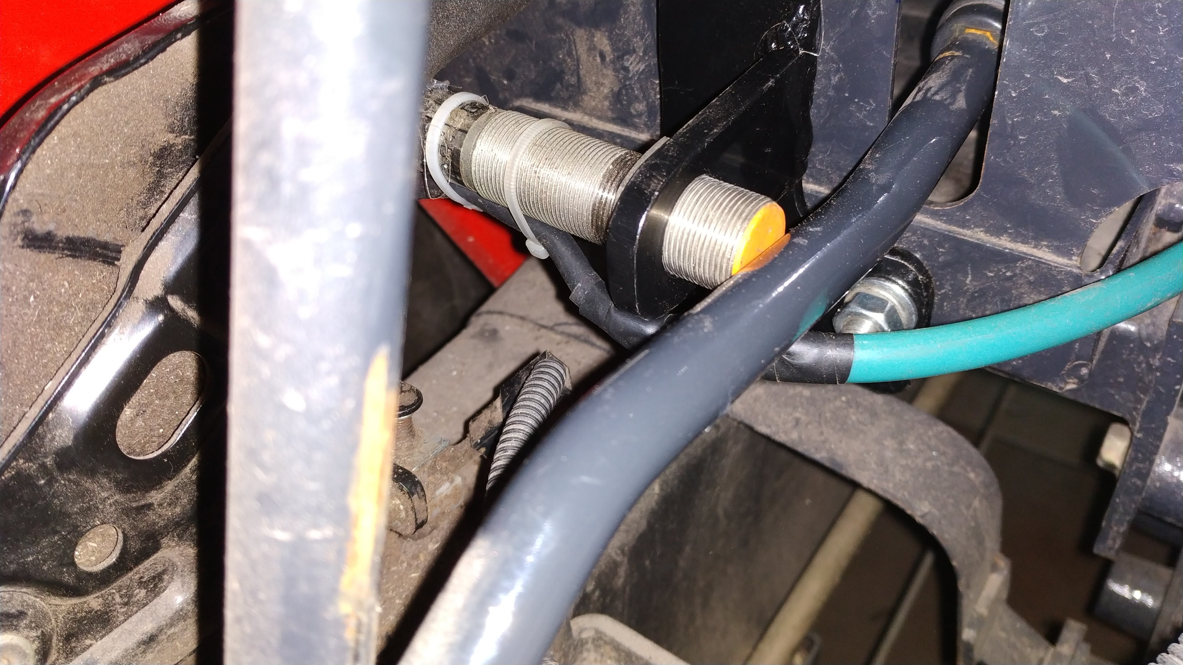

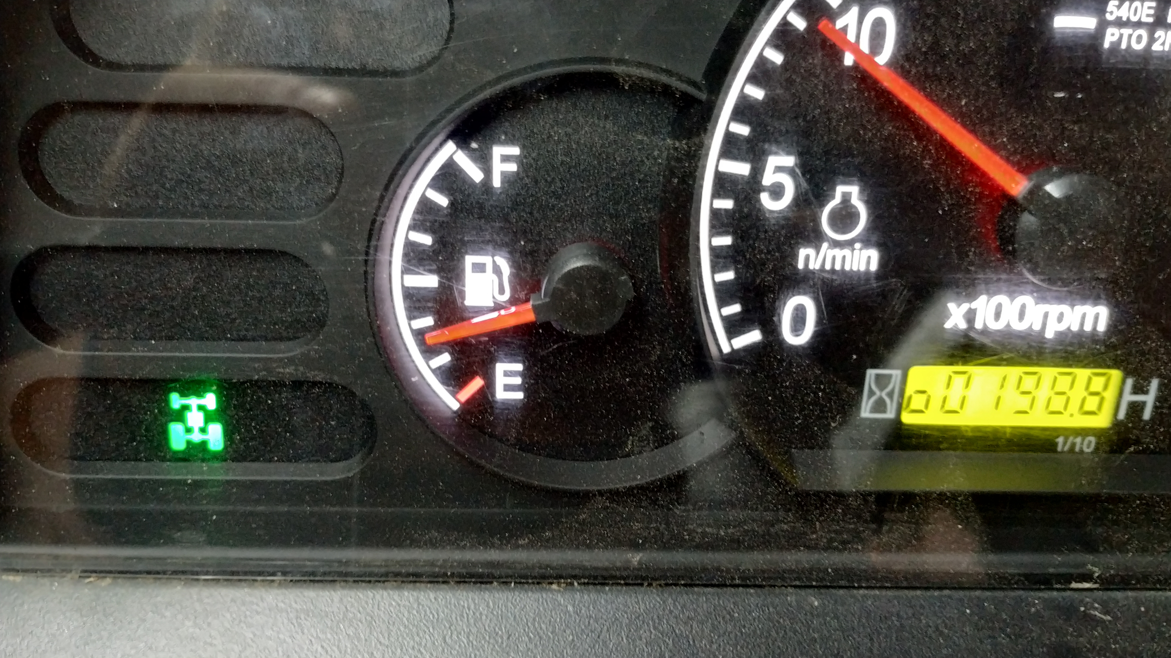

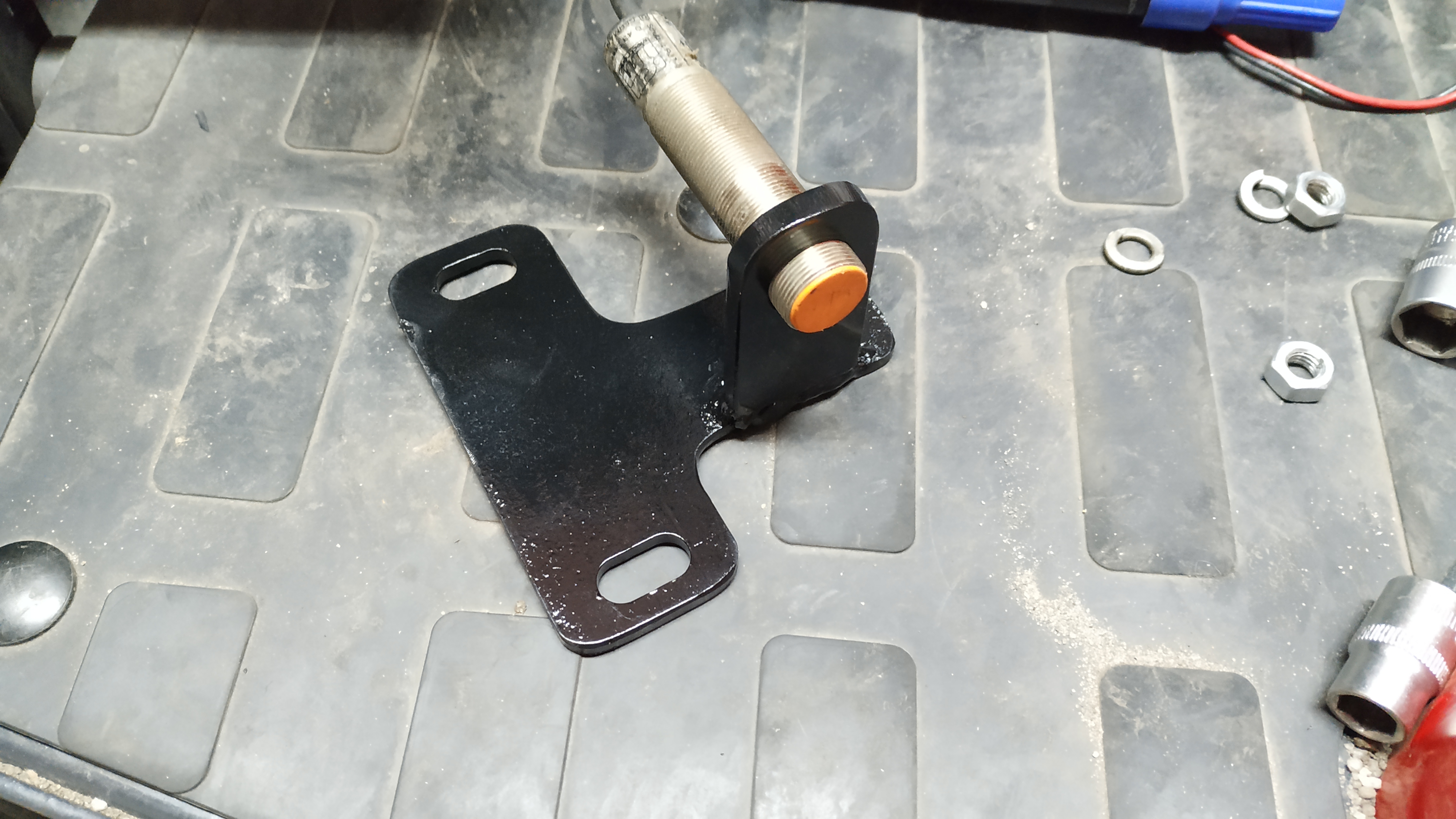

Not on a Yanmar, but I did it on my Branson. The dashboard already had a light, so I just figured out the pin out of the dash to see which pin was for the 4WD light. Then it also said if it needed a positive or negative signal, in this case, it was positive.
Then used a proximity switch on the lever, made a bracket and wired it. Worked great. I also added a 200 mA fuse, just in case something shorts out and doesn't burn anything on the dash board.
The proximity switch:
Mounted in place, with the lever in front of it:
And the dash with the light on:

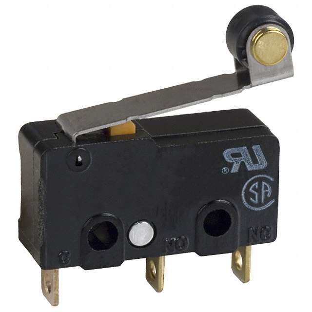

Mercury tilt switch is not a good solution, IMO. How much does the lever or linkage angle actually change, between 2wd and 4wd? Is it more than the rollover angle of your tractor, or even the maximum slope you're likely to encounter? And what about the fact that the thing is bouncing around in use?
The proximity switch is a great idea. If that's a bridge too far, consider a standard $2 lever switch of one type or another:
