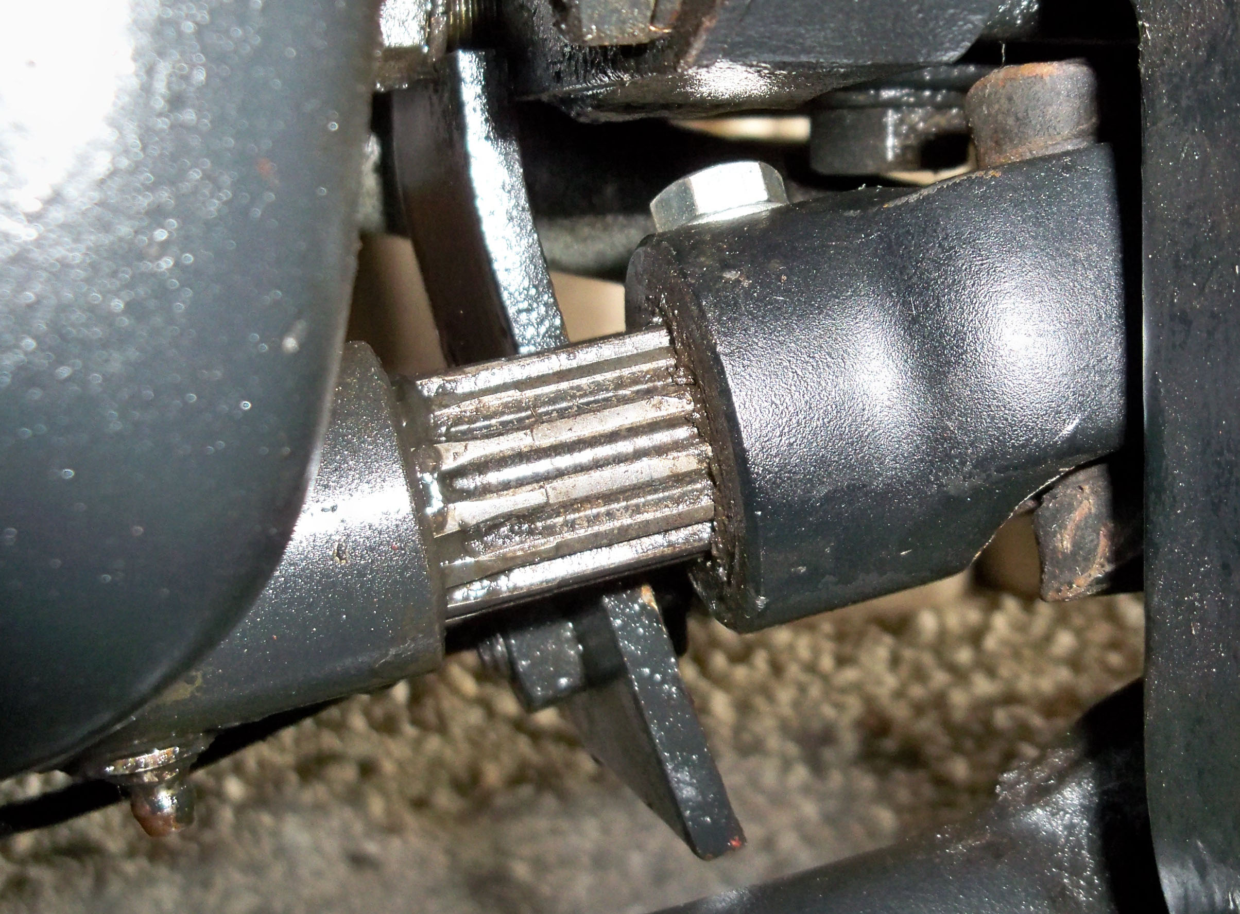

If your tractor is equipped with Super Steer you should inspect the yokes threaded pins. These pins retain the yokes onto the splines. The threaded pin is threaded into the yoke while the pinned end extends into a bore on the splined shaft. This pin was missing and had to be replaced on my TC40D.
If this threaded pin is missing from the yoke you could damage either the yoke shown below or the splined coupling in the drop box. The damage would occur when these respective components travel off the splines.
Mike

Thanks for the replies.
It is not a super steer.
