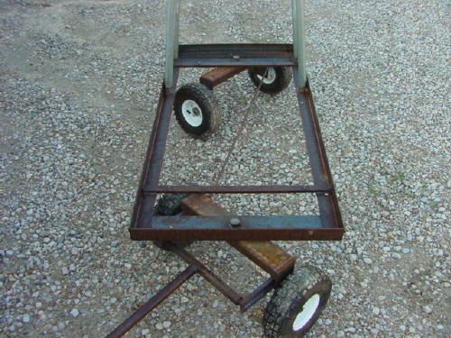

Some time ago I needed a wagon. So I went to TSC and picked up some of their cheapo wheels.
I decided to go with four wheel steer, easy way.
Four wheel steer lets you hang a ninety degree turn, literally. The rear wheels will follow in t he path of the front ones.
Simple to do.

Harv, very clever. Could you post a pic showing the detail of the attachment of the front/rear tie rod?

Don it's just a tab welded to each axle cradle with a rod running between them caddywampus across.
Yes it is tippy.
No I wasn't so much a tearer aparter as I was a tearer upper. /forums/images/graemlins/grin.gif
I believe Northern had or has a four wheel steer wagon that's done right. It has steering knuckles and tie rods so there isn't any tipping problem.
I have a bud who builds stock motors with the correct numbers for restorod people. He does a ton of swap meet and garage sale searching. He built a really trick four wheel steer wagon, again done right. I liked the idea.
The advantages of four wheel steer is the front wheels follow the rear ones exactly. So you just lead and the wagon follows. No running over other people's toes, no fights, no exchanges of bad words, no comments about genetic history, etc.

I took a picture for you Don. I hope it's clear. What I used was clevis eyes on a rod.

Yes, that clears it up nicely. We use spherical bearing rod ends in our race cars for various things, and I have a couple laying around when I get to that project -- number 129 on the list, I think. They're probably overkill, but I have them. Is it harder to back up?

Heim Joints would be the way to go. I have some laying around too.

It isn't harder to back up. This wagon has a three hundred amp Dialarc on it and a plasma. Not a problem moving it around on a gravel drive.
