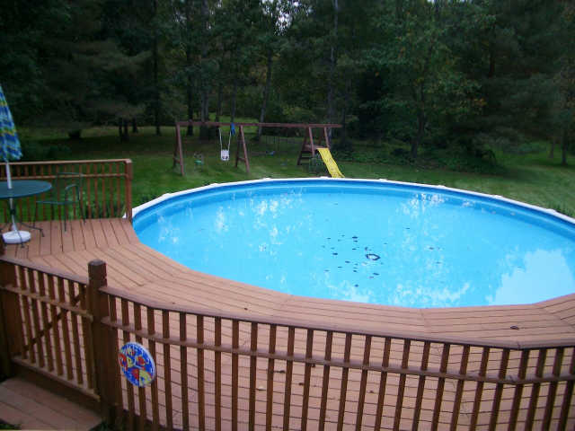

   / Framing deck for above ground round pool? #4
mathey - several years ago at our last home, I added an above ground pool to the delight of the wife and kids. Was able to 'cut' back into the slope and deck out to it, giving somewhat of the illusion of a built in. IMO, the posts and joist supports can go any which way as to make your deck board installation easiest, as they will/can be hidden. Attached is a pic of the decking from above as I laid it out.

   / Framing deck for above ground round pool? #6
I 'cantilevered' the decking over the pool wall top edge as opposed to 'butting' up against it. I made certain there was room to slide the cover between the two, as well as a little post settling fudge factor.

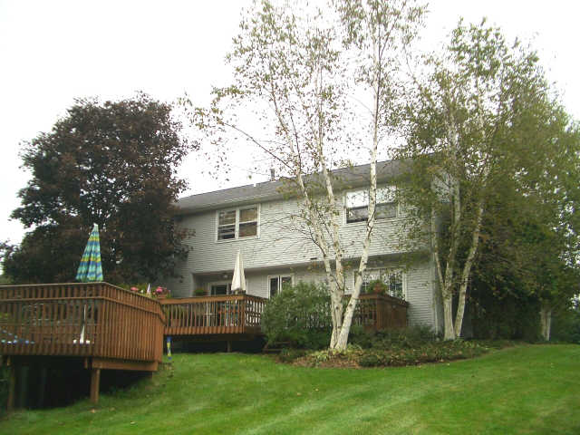

   / Framing deck for above ground round pool? #7
Took me a long weekend to get the deck done, another for the darn railing and staining... Last pic, hope they help.

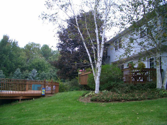

   / Framing deck for above ground round pool? #8
Opps, found one more from a new angle.
