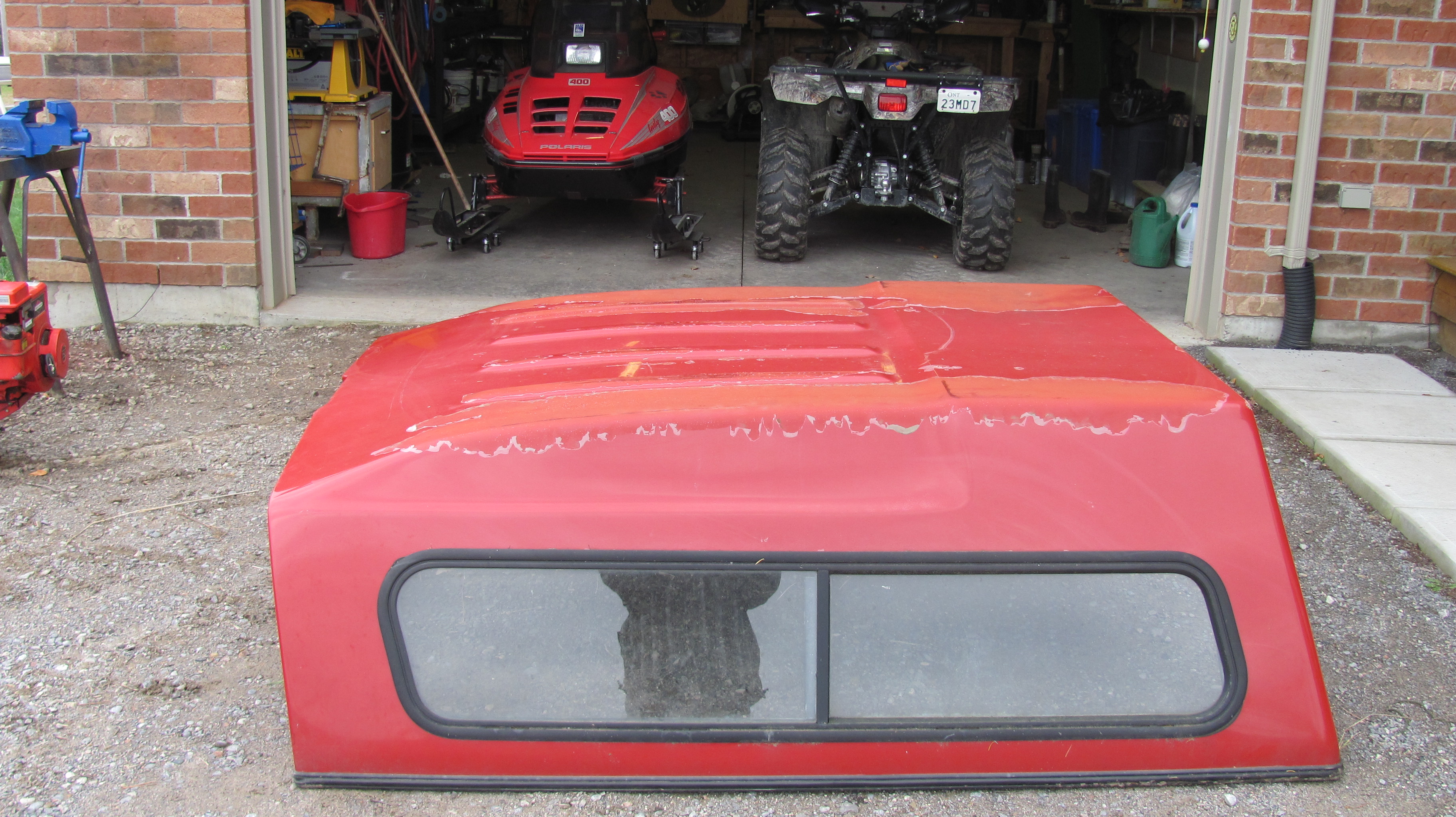

I picked up this freeby Ford ranger truck cap off the internet this morning. I used the angle grinder with a cut off wheel and cut the top off it and am going to make a canopy out of it. I have to pick up some 1 inch square tube to build the frame out of but won't be able to get that until next Friday. I hope winter holds off a bit longer.

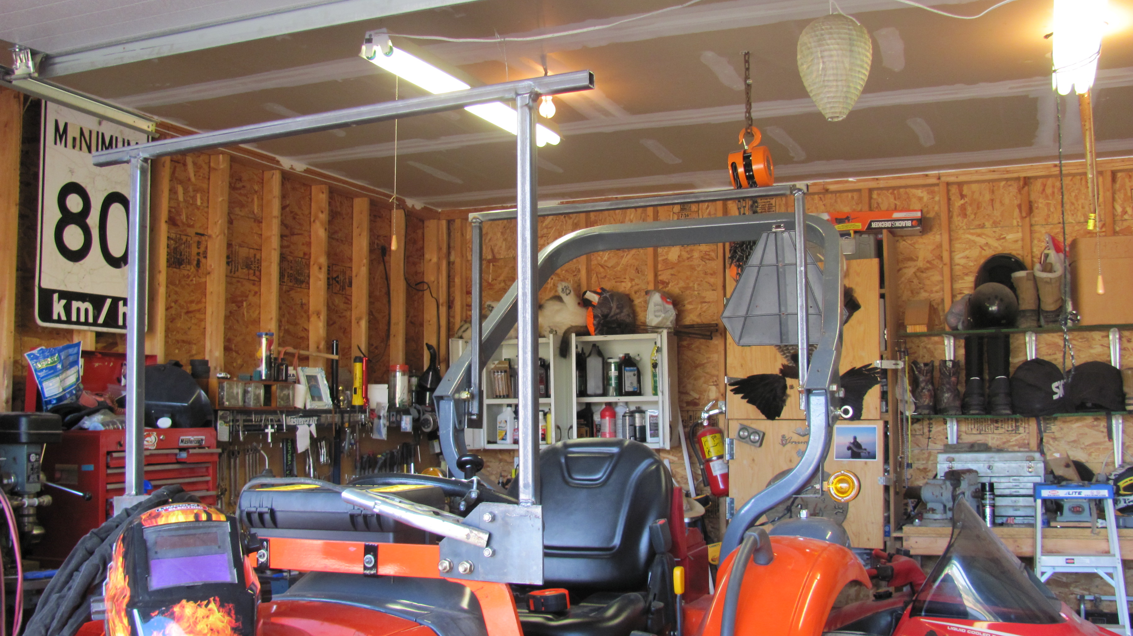

Well I have it mocked up disassembled and and now painted. I tried to put up some pictures as I was going but for some reason (explornet?)
or not I could not get the pictures to load. I will try again.

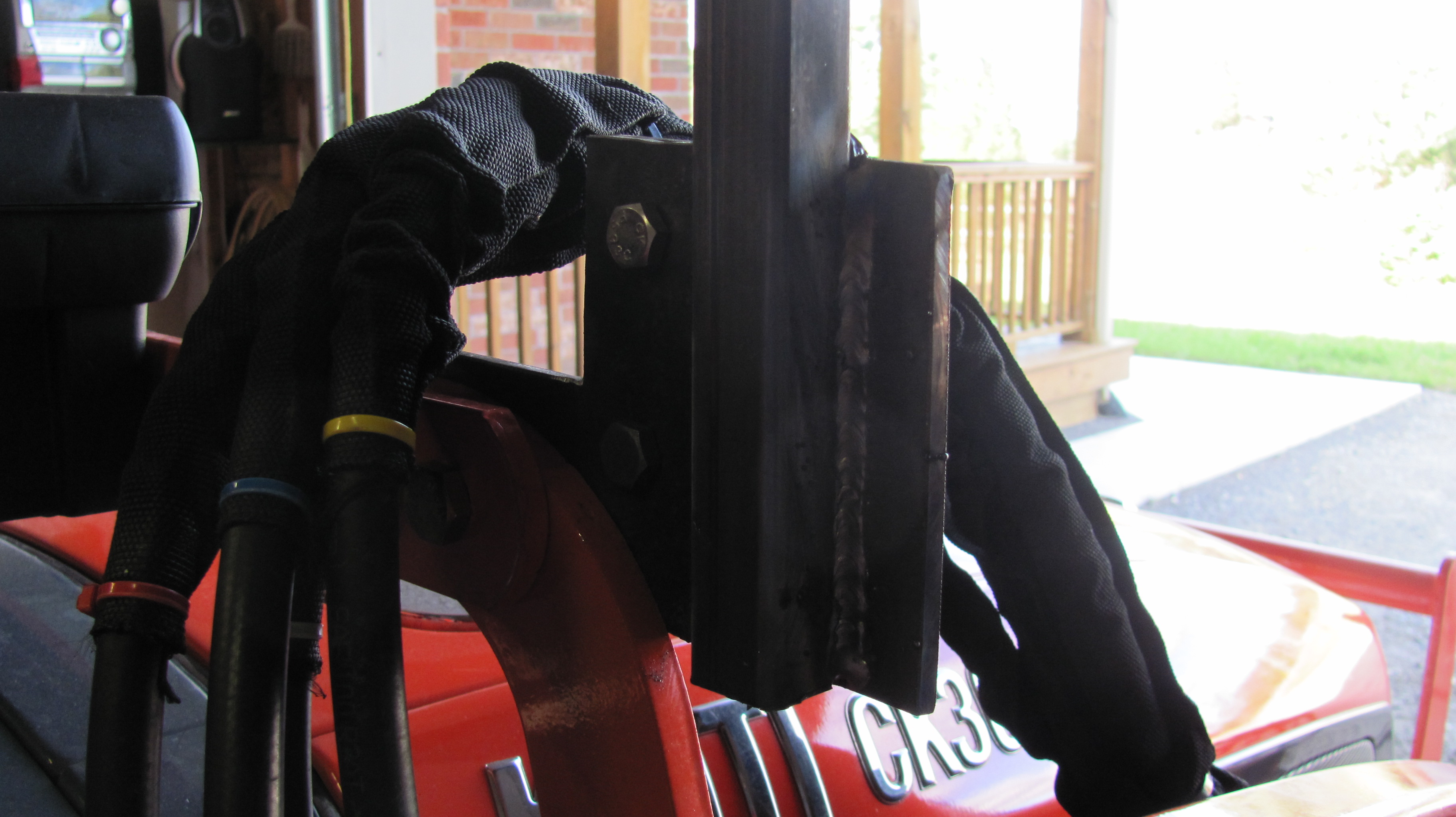

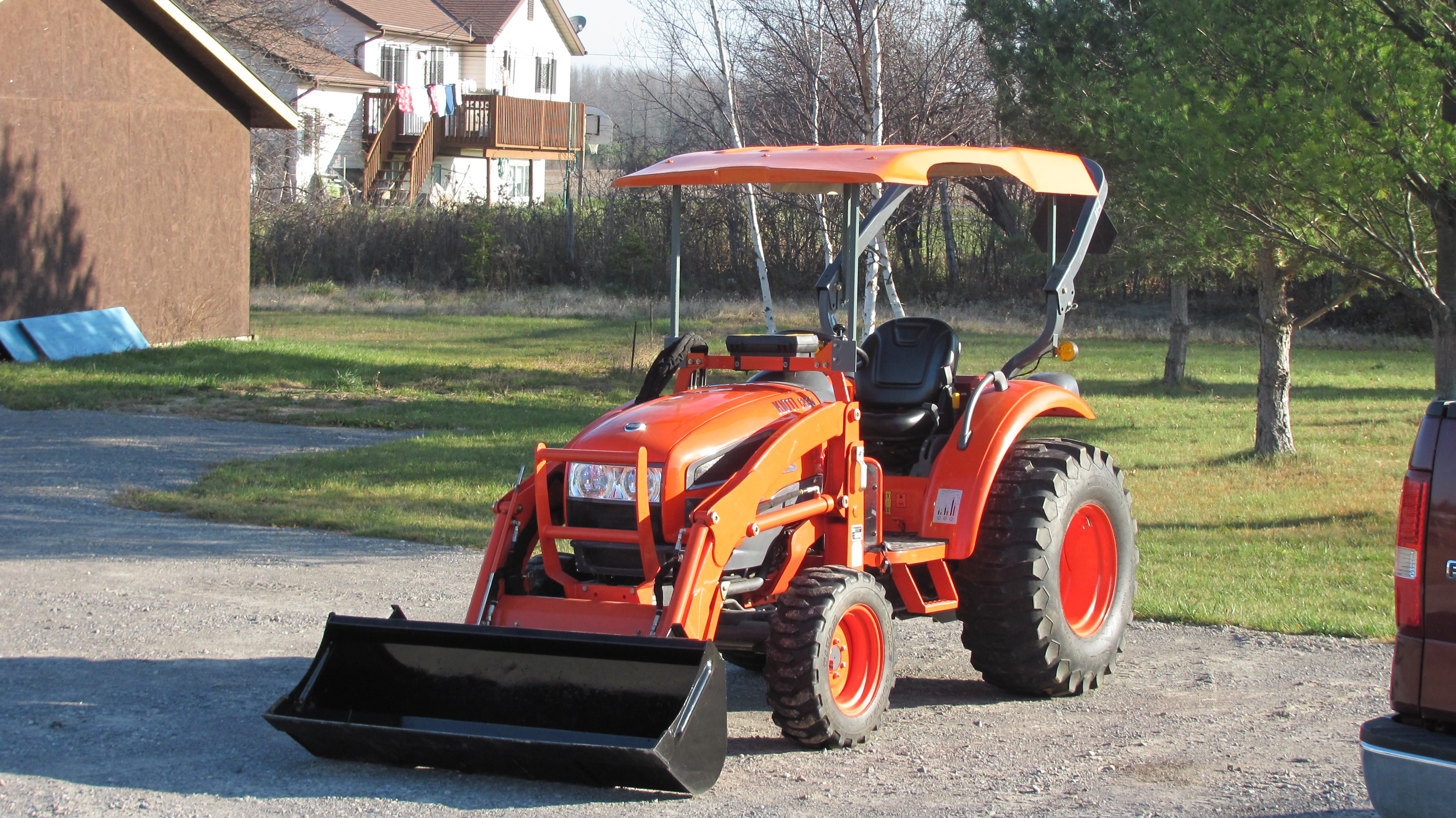

I had to keep it low enough to get in the 7' 3" garage door opening and it fits my 5' 10" stature well. I cut away the sides of the canopy to give a little more head room getting in/out.
   / Free Canopy

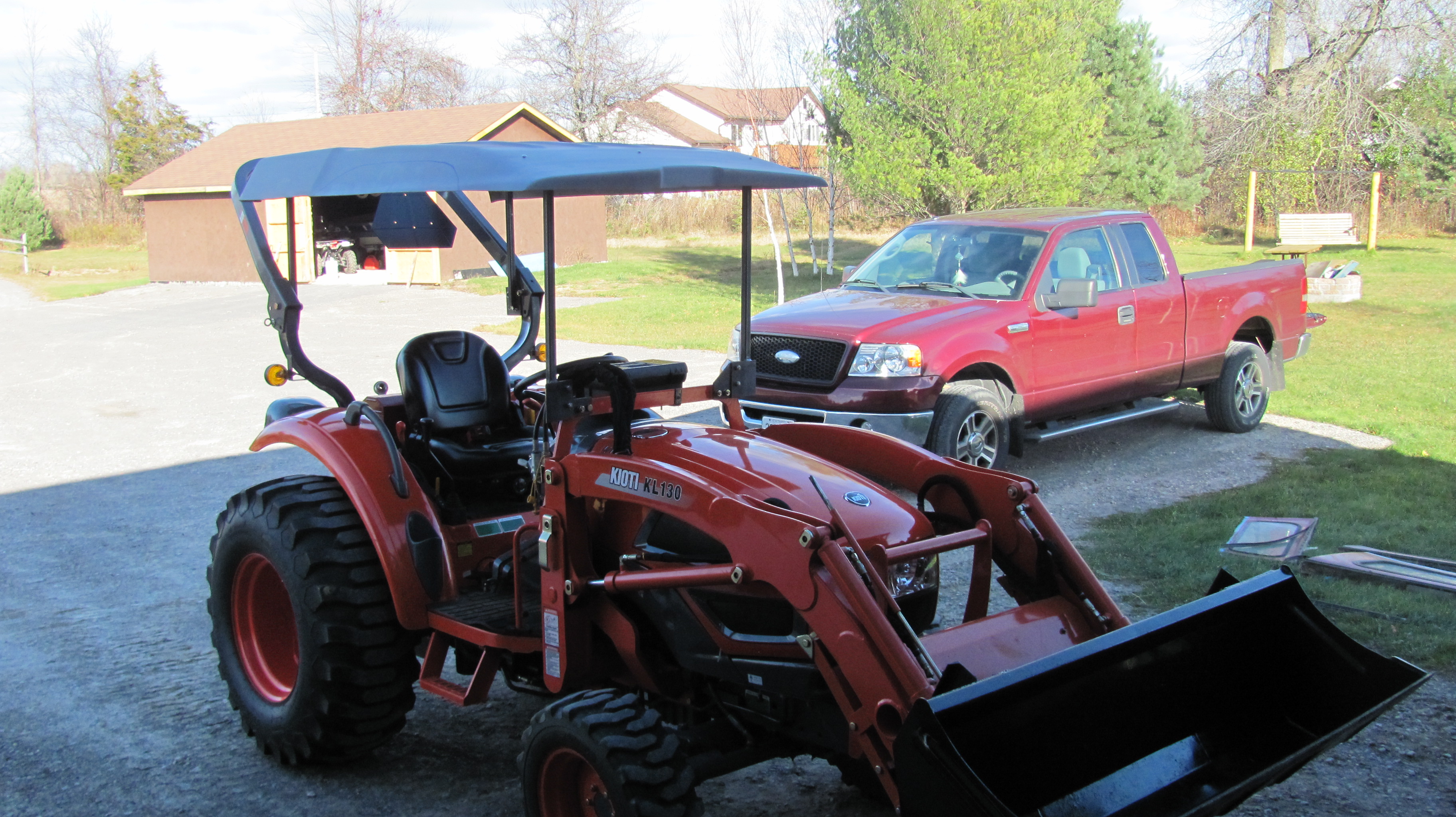

Finished, came in just under $80 for metal and paint.
   / Free Canopy #8
Looks good. I'm sure you will enjoy the shade it provides, as well as not getting soaked if you get caught in the rain.
