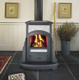

There are some very fine gas stoves out there, a lot more effective that "gas logs"
From this fine manufacturer Soapstone Gas Stoves
DIMENSIONS & SPECIFICATIONS
Dimensions (HxWxD): .......30 x 24 3/4 x 21 1/4?br> Weight: Stove 290 lbs., Shipped 310 lbs.
Fuel: LPG(propane) or Natural Gas
Flue Exit: Rear Flue Size: 6 5/8?br> Flue Height (center): .................................23 3/4?br> Area heated: .................................800-1,200 sq. ft.
Min邦ax Heat Inputs:
NG: 18,691-22,552 BTUs /hr.
LPG: 18,297-21,988 BTUs /hr.
Controls: On/off/adj. output........on stove
Remote Control/Thermostat...??..optional
Efficiency (AFUE): ??..?...................76%
Efficiency(Steady State): .......................?..77%
Clearances: Front 30 Rear 11?br> Sides 8 Corner 4.5?br> Safety tested to UL Standards & ANSI 21.88b-2001
Mobile Home Approved
Now these stoves need proper venting and will operate without any electricity so they are not direct vent (like a pellet stove with a combustion blower). They also obviously work in a power outage. Any stove I buy has to or it does not make the grade.

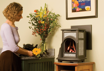

They do have a "mini" that is direct vent
Mini Franklin Gas Stove
Due to the small size I believe it can ship UPS... Good for heating up to 100-400 sq ft.
