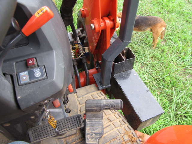

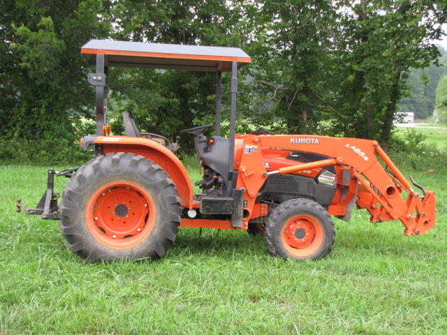

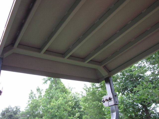

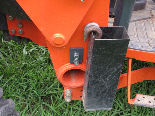

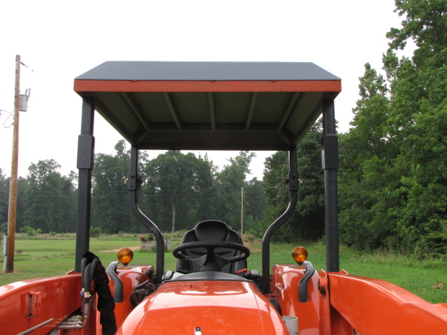

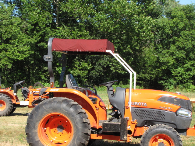

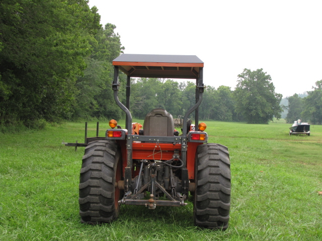

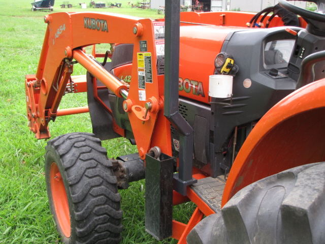

Back in June 2010 I made a rag top just to see if I would like one. Well I did and I made one.
You can see how the legs are made and how I hooked them to the tractor. Also the inside of the top.
It bolts on and if I sell the tractor I can just unbolt and put the oem rop back on.
I have 4 bolts to put on the front uprights and a cross bar goes between them just above the hood.
All the tubeing for the back, front and uprights are 1/4" wall. The 1 X 2 in the top is 3/16" wall. Top is 3/16" flat stock. The mounts at the bottom is 1/2" and 5/8".
It is heavy, so heavy I just might be able to unload my rear tires.
