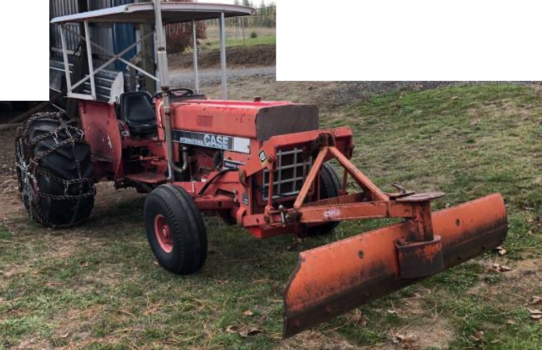

From an ad in CL for the blade.
I think this is the first factory? 3 point front hitch I've seen in the US. And it looks like it may be on an orchard tractor that I've never seen before, either.

Looks like both the front three point hitch and the exhaust are after market attachments. Might as well add the canopy in on that list too. The front three point is a slightly different color and has manufacturer labels on it.
I don't know much history, but front three point hitches are available. I just googled "front three point hitch" and came up with several manufacturers.

Bruce, I can't figure out how that 3pt lifts? Is there a hydraulic cylinder hidden behind the top link that pushes on the tractor frame below??

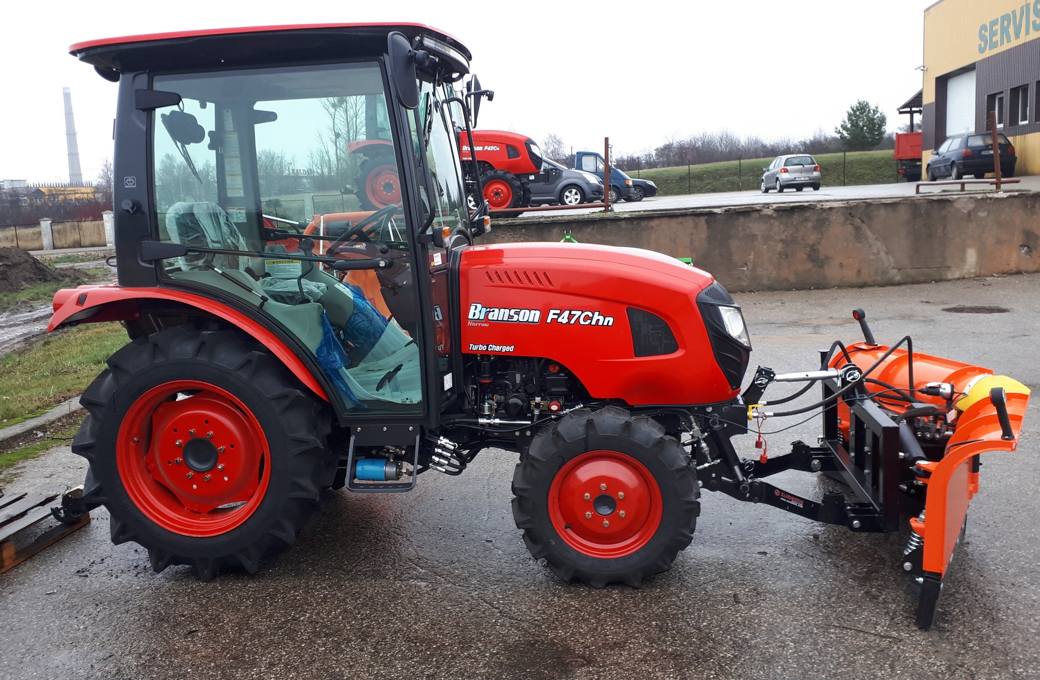

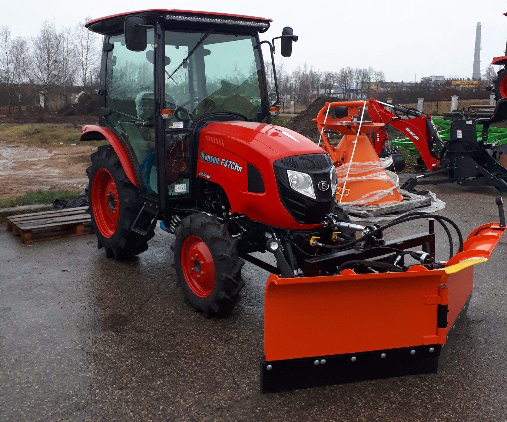

Here a few closer pictures of the front 3 pt hitch. There is also the possibility of adding a front PTO as well. So far I'm only away of Zuidberg making front 3 pt hitches for pretty much every tractor.
You can see how the cylinder is setup there. I've also seen them mounting the cylinder under the tractor on a horizontal position when space is an issue.
61269797_2309471525987784_2832265403948859392_o.jpg78872851_2456555634612705_1864245621574074368_o.jpg79001970_2456555557946046_3613529618767675392_o.jpg
I'm wondering if a setup like that, with the V-plow would work well in the US?
In my opinion, a front 3 pt hitch is a much better solution than the proprietary hitches that Kubota and JD insist on selling those. The attachments would be much cheaper that way.

Follow the hydraulic hoses... they go to a cylinder. The grill has 4 verticals but you can see 5. Well, the 2nd one from the right is the chrome cylinder ram. ;)

I don't think it's an orchard tractor. I think it is a low boy, though, where you straddle the transmission hump. My old IH2500b was like that.

Yep. Thanks Moss!!!

That's not an IH hitch, it's after market. There was never a factory front 3pt on any of those utilities, including in Europe where they were built.
It is also on an orchard 84 series, factory underslung exhaust converted to be vertical.
