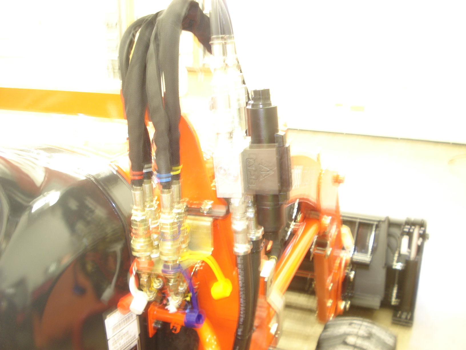

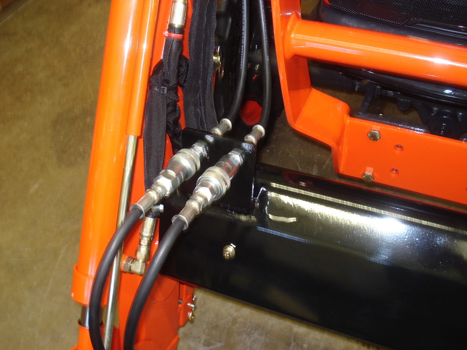

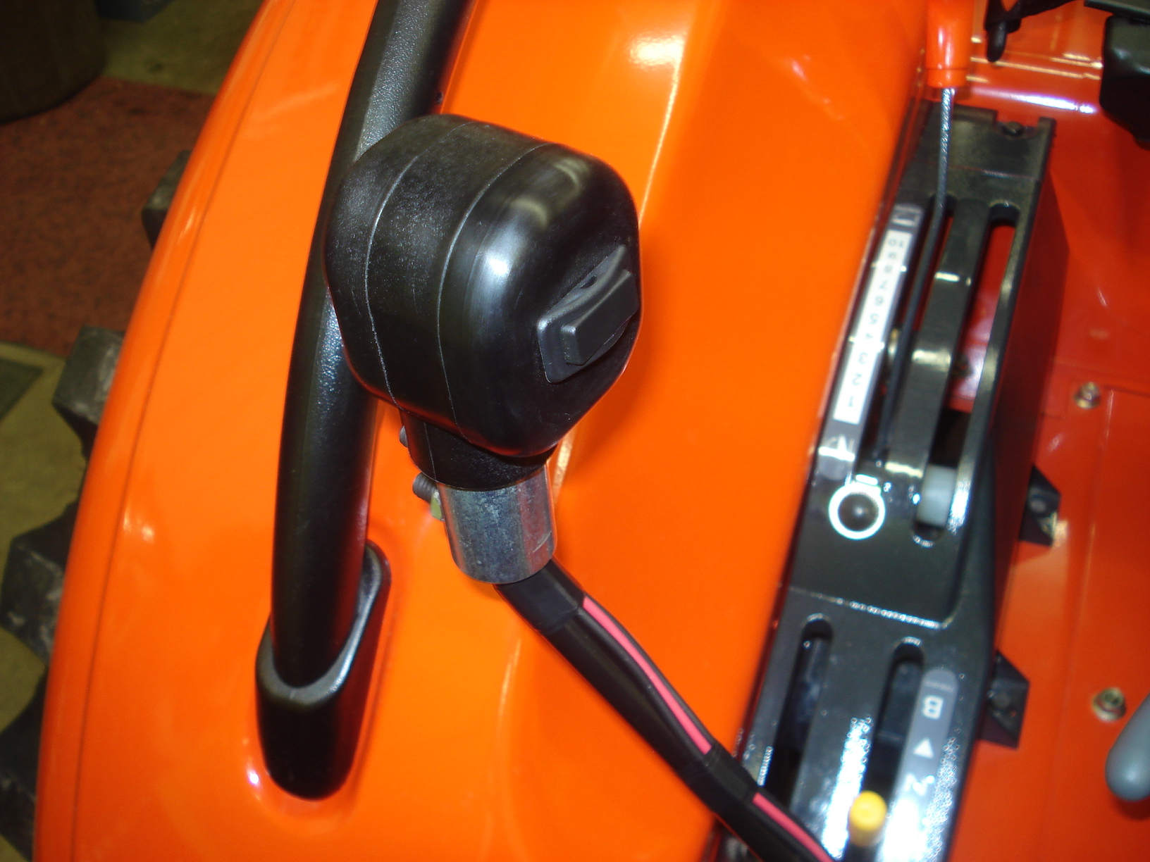

   / Front Aux?? #4
Sorry about the last picture...I know this is a Kioti but it will give ya a reference on what they look like.
The olnly thing you would have to do is build a mount because this is built for the Kioti.
Unless I can get my hand on a Bobcat.
