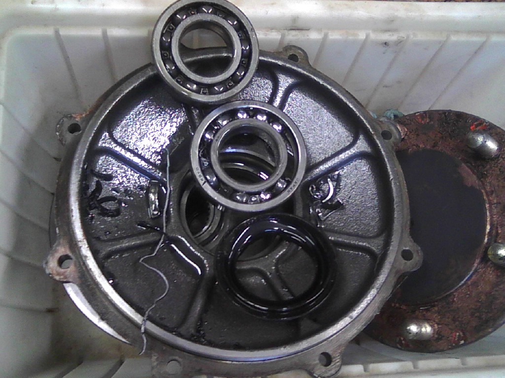

I have a B7610 with the front axle leaking when in 4WD. I've noticed a lot of owners of tractors with a leaky axle have replaced the SUDT fluid with 80W-90 gear oil after replacing the seals. Has anyone replaced the fluid with synthetic gear oil? Will this hurt anything?

I switched the front axle fluid to SUDT2 in my BX1500 and shortly thereafter it started to leak.
After that I switched it back to 85W90 gear oil and it stopped leaking.

Always run 75w-90 synthetic gear lube in front axle, as per dealer's recommendation. If leaking doesn't stop after a change, you'll have some work in front of you by way of a repair. Not the worst thing to have happen.

I had put hydraulic oil in the front of my L4400 at the 50 hr change, because the manual said I could, and it was cheaper than 80w-90. At 440 hrs, I had a terrible leak caused by a bearing/seal failure. Now it has 80w-90 synthetic, and always will. Pay for lubricants or pay for repairs, your choice. Personally, I'd fix the leak first...

Yeah I plan on fixing the leak first, just wondered if synthetic gear oil was ok to put back in.
