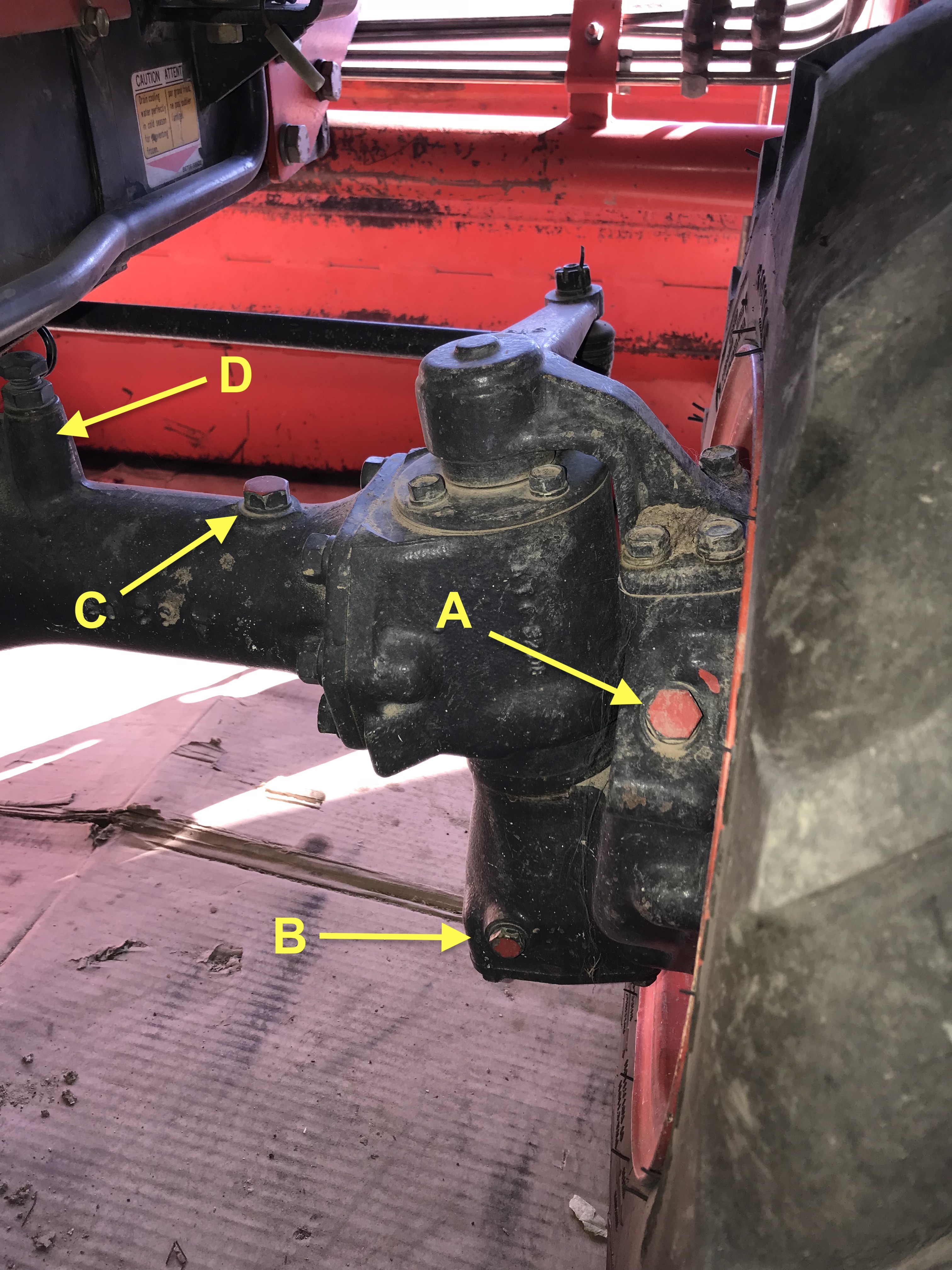

On the front axle of my Kubota B7100 4x4 there is a plug in the top of the axle. Labeled in picture as 'C'. I assume this is where you add fluid. My question is, how full do you fill it? I don't see any other plugs to open to know when it is full.
On the drive hubs themselves, I assume you add fluid at plug 'A'. Do you fill each side till they are full to the plug level?
Hope I explained it right.

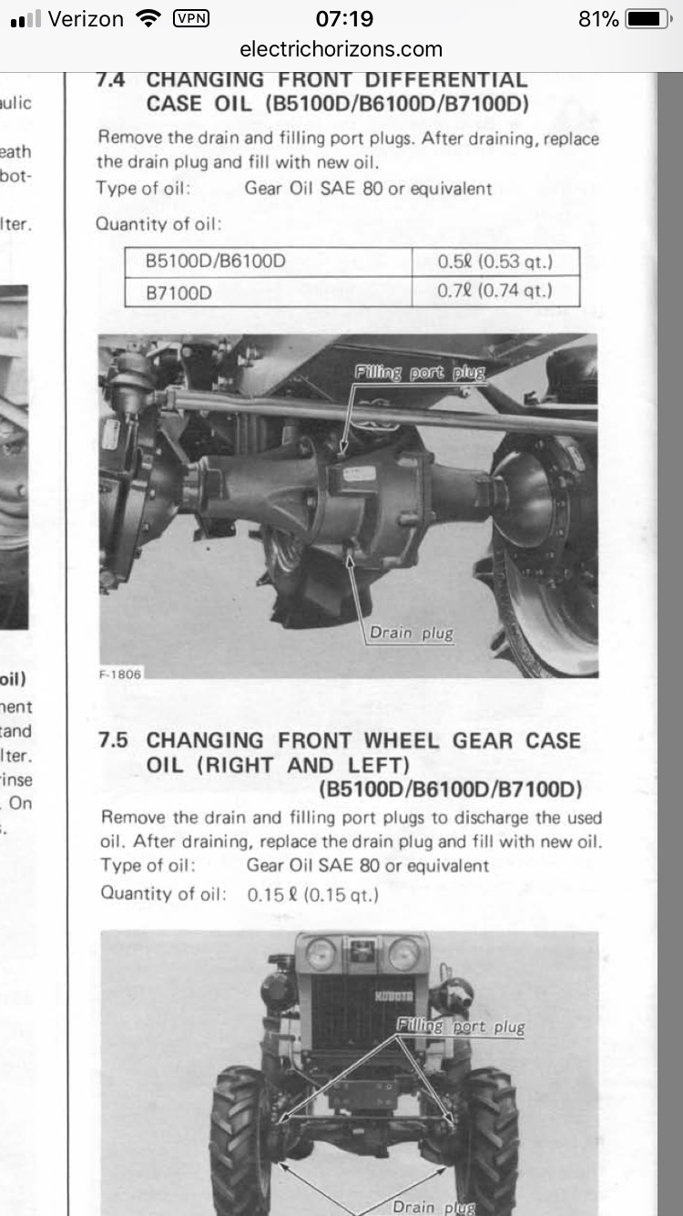

The only thing I was able to find was for the front drive axle for a B7100d
The op manual doesn’t mention a check hole, just drain and fill to spec :

JMHO - "A" - fill to the top of the plug hole. Now on "C" - my front axle has a "check oil level plug" on the back side (unseen side) of the axle. Remove plug on back side and fill(thru hole "C") until it runs out backside hole. You have no backside "check oil level plug" ??? , no dipstick attached to plug "C" - fill to the top of hole at plug "C".
Yes - fill at "plug A" to the top of the hole on both sides.
Regarding plug "C" - you could check with your local Kubota service manager.

Thanks guys. I'm going to look for another plug or hole to maybe indicate when it's full. Maybe I just didn't look good enough.
   / Front axle lube levels on Kubota 7100 HST 4x4 #5
My backside "check oil level plug" is considerably smaller than either the "A" or "C" plugs.
