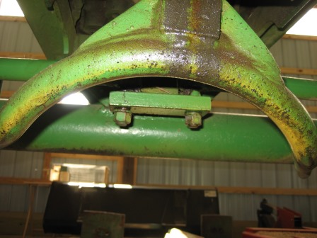

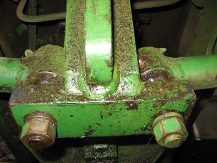

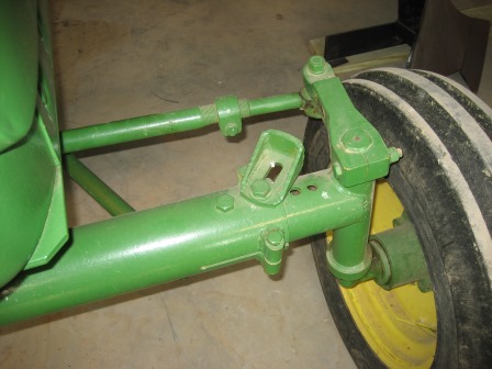

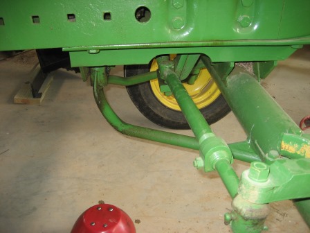

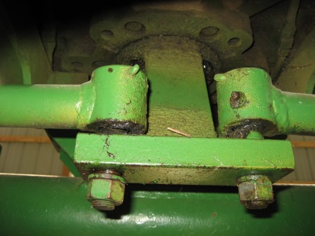

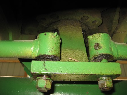

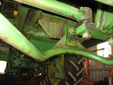

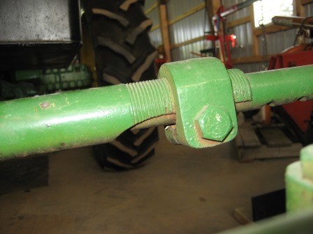

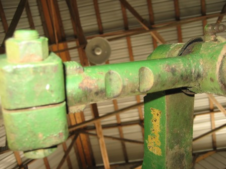

I have owned my '61 JD 3010 for several years. I recently noticed that several tie rod ends were missing grease boots and had some play, so I decided to install four new tie rods. But when I compared what was on the tractor with the shop manual and the Deere parts catalog, I found a total mismatch. A neighbor suggested checking out the aftermarket Schwartz front axle - but that's not what I have either. I am attaching some pictures. Anyone recognize this front-end setup?

I don't ever remember seeing one in person but it could be a "Norton" aftermarket WFE. There were also Speeco WFE's
   / FRONT AXLE ON 3010 - WHAT DO I HAVE?
Tx Jim - that was the lead I needed. Norton was bought out by Schwartz some years ago. The complete diagram of my front end is at the website below. It is a very sturdy unit. Many thanks!

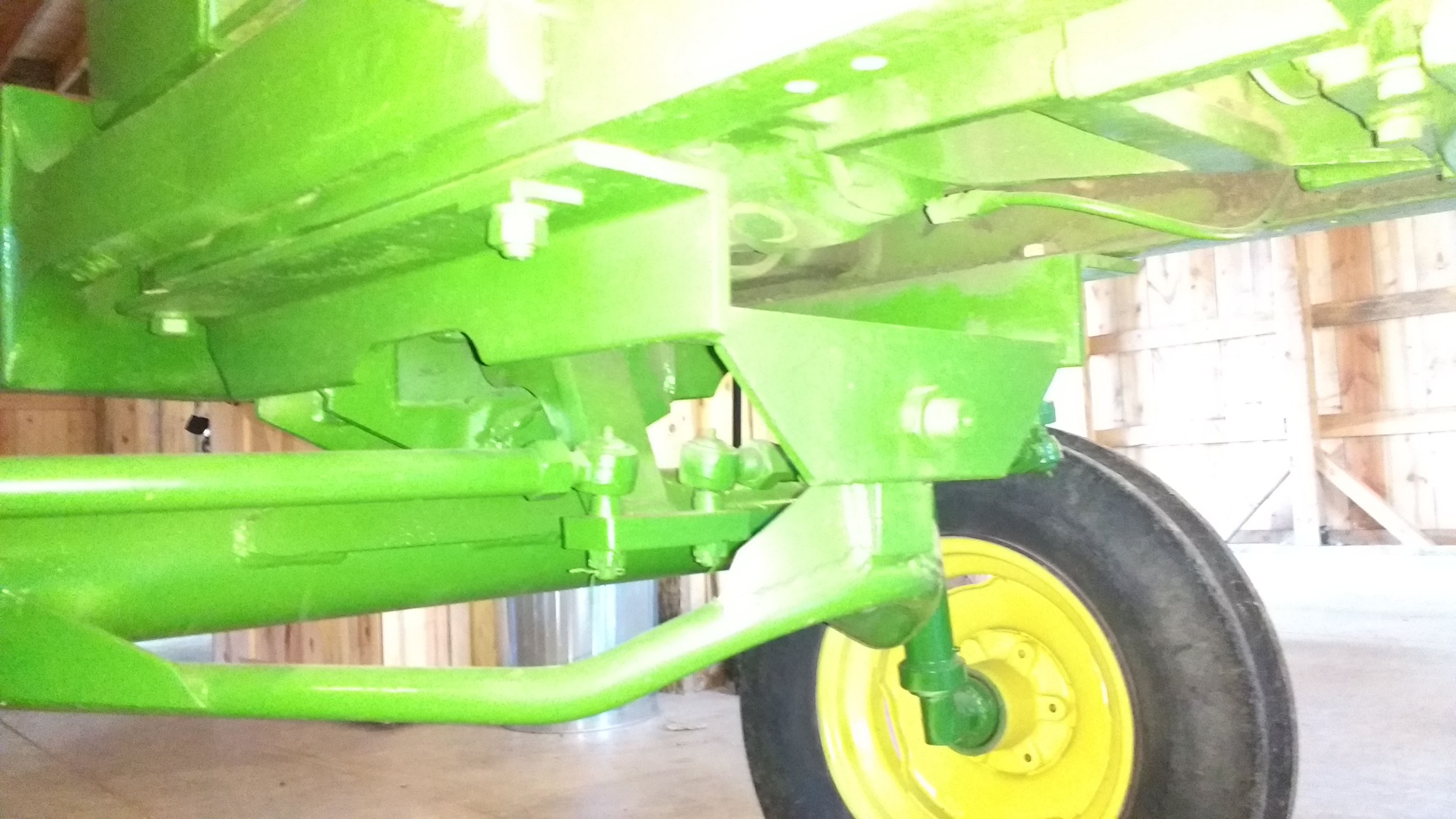

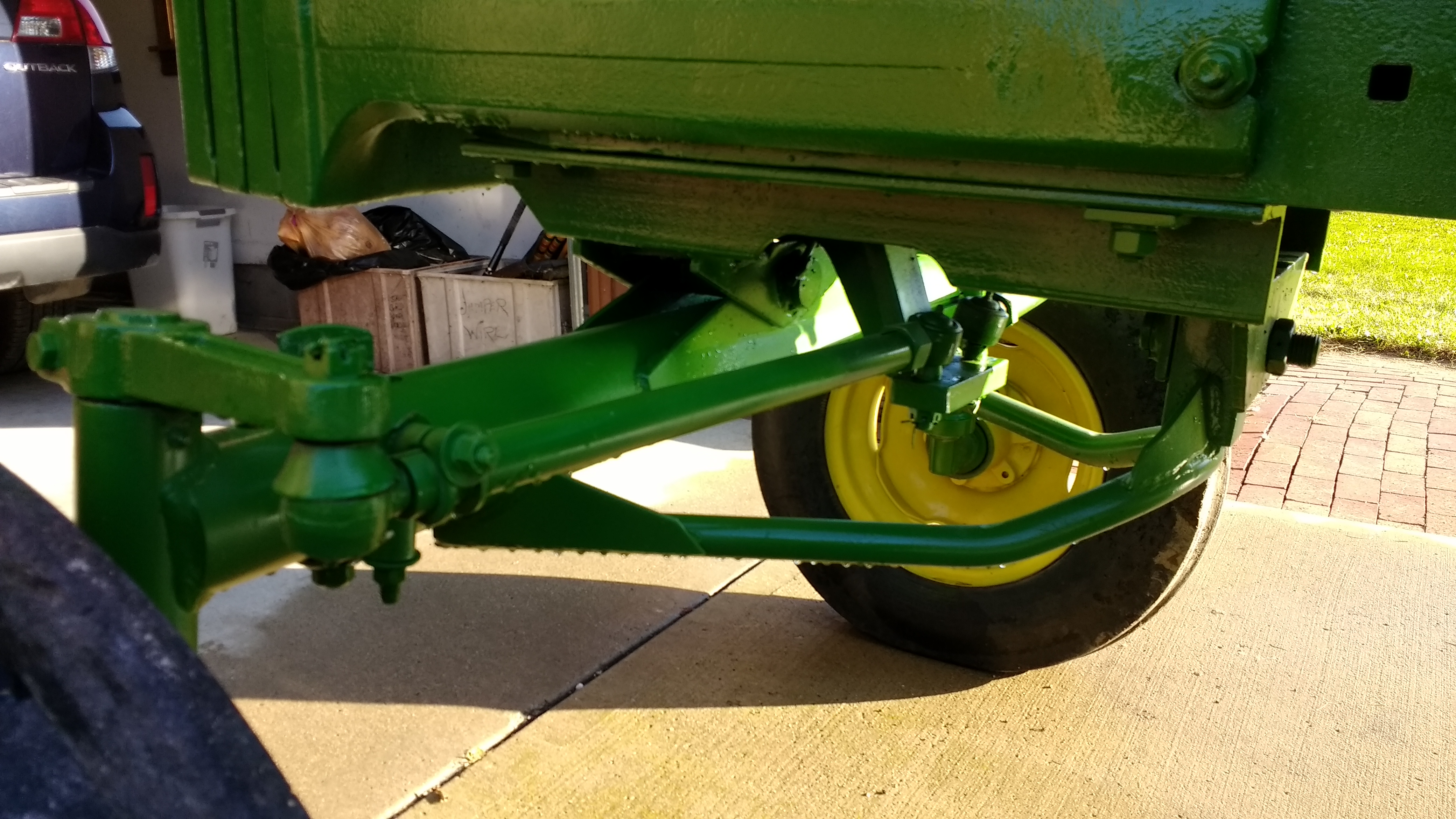

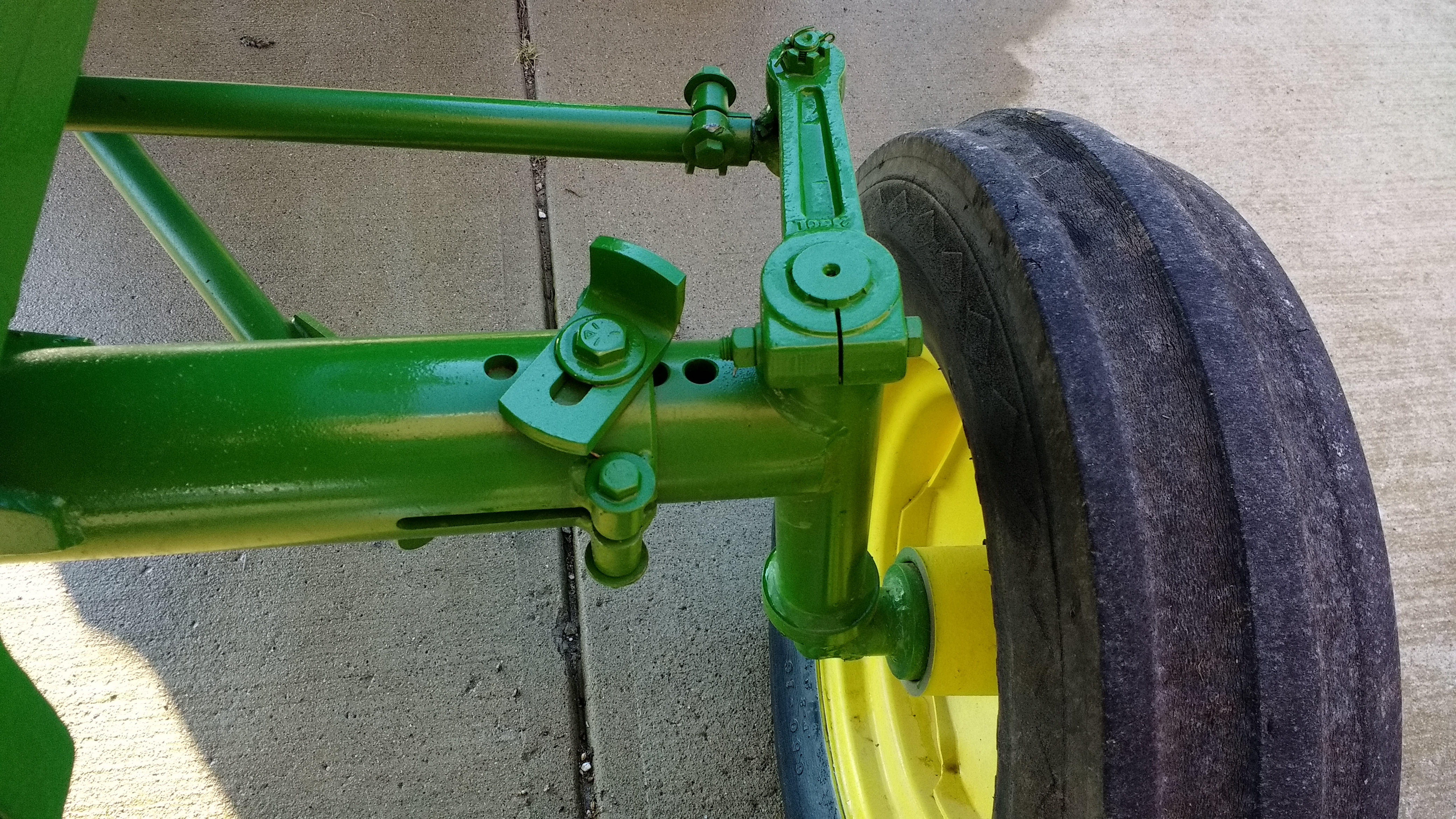

Unfortunately, the "trustytractor" link above is no longer valid. Was hoping to see if this is the same front end as mine. I bought my Grandfather's old 1961 JD 3010 from my Uncle a few months ago, and my Uncle thinks the WFE is a Schwartz model. If anyone has additional info/input, I would be grateful.
