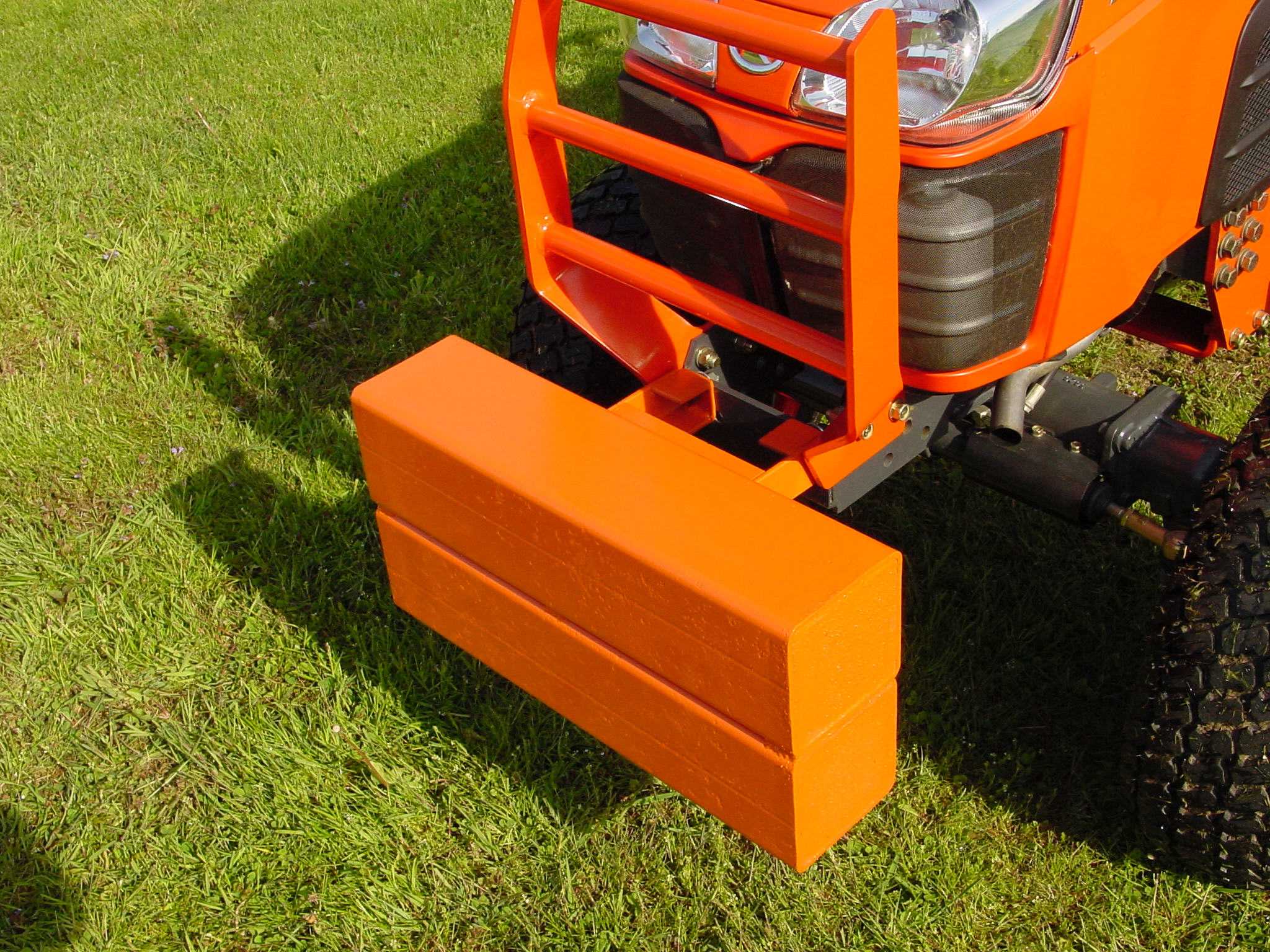

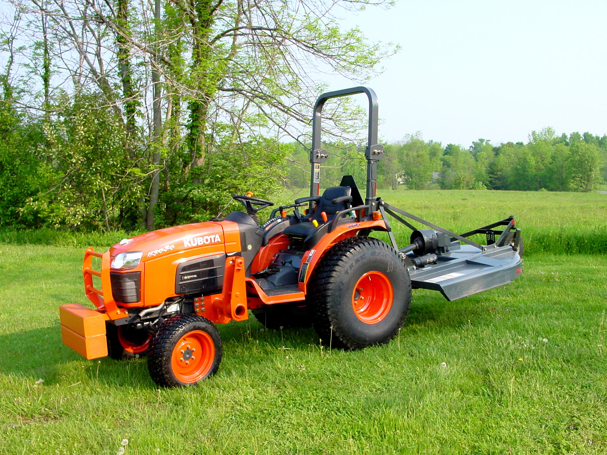

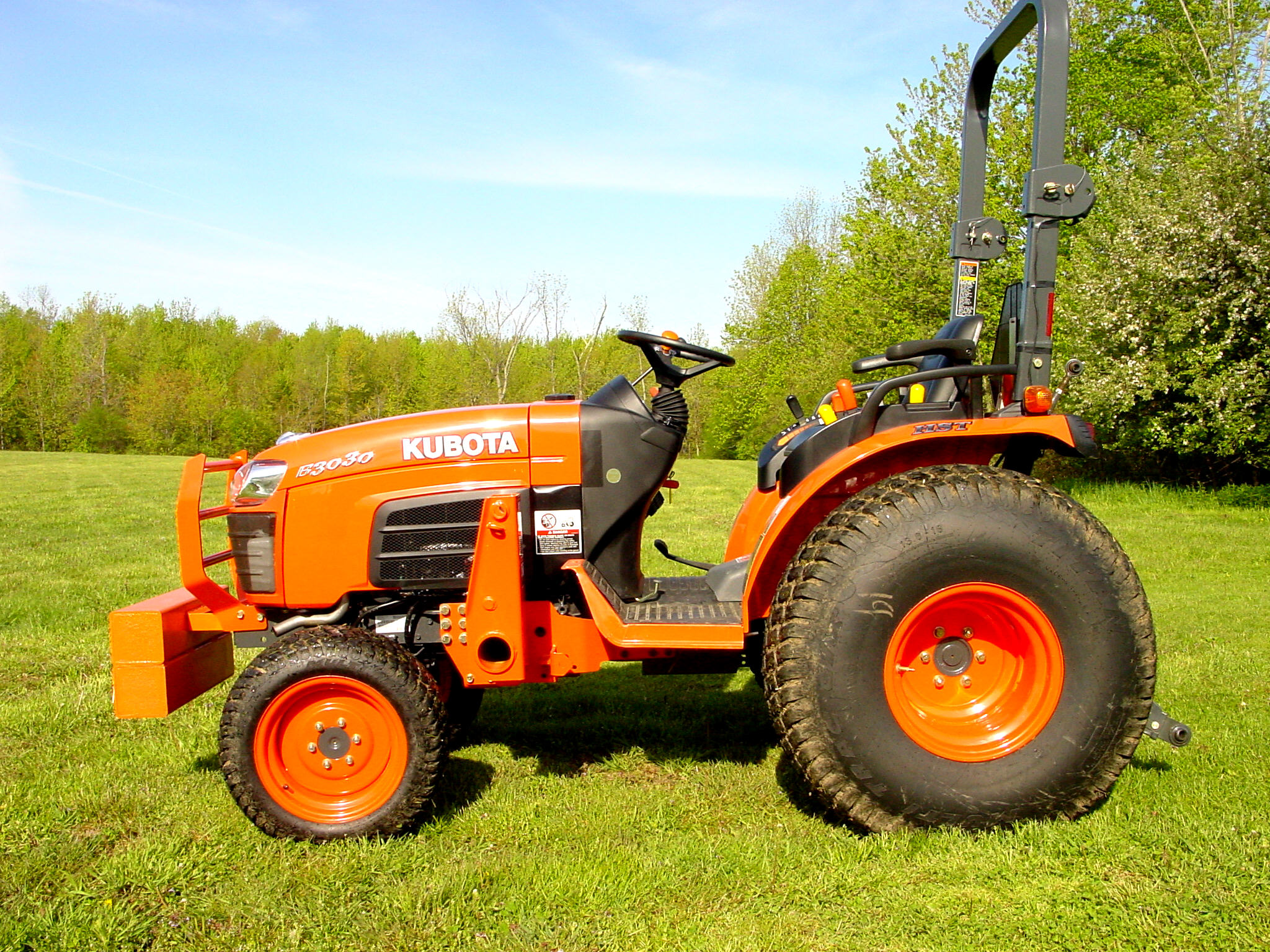

Helps the front end with the cutter attached

Nice job!
Is that a home made brush guard, or did you modify a Kubota guard?
What is that you used for weight? It looks like some big lengths of bar stock. How much weight, do you think?
   / Front Ballast #3
Actually, it looks like square tubing filled with concrete to me.
But looks really good, it does.
   / Front Ballast #4
Yeah...I see the weld seam now. Looks like the square tube was used for a former.
   / Front Ballast #5
That's it? I mean, that's all you have to say? :D
More pics and juke please?
Tell us more about this fine new looking accessory.

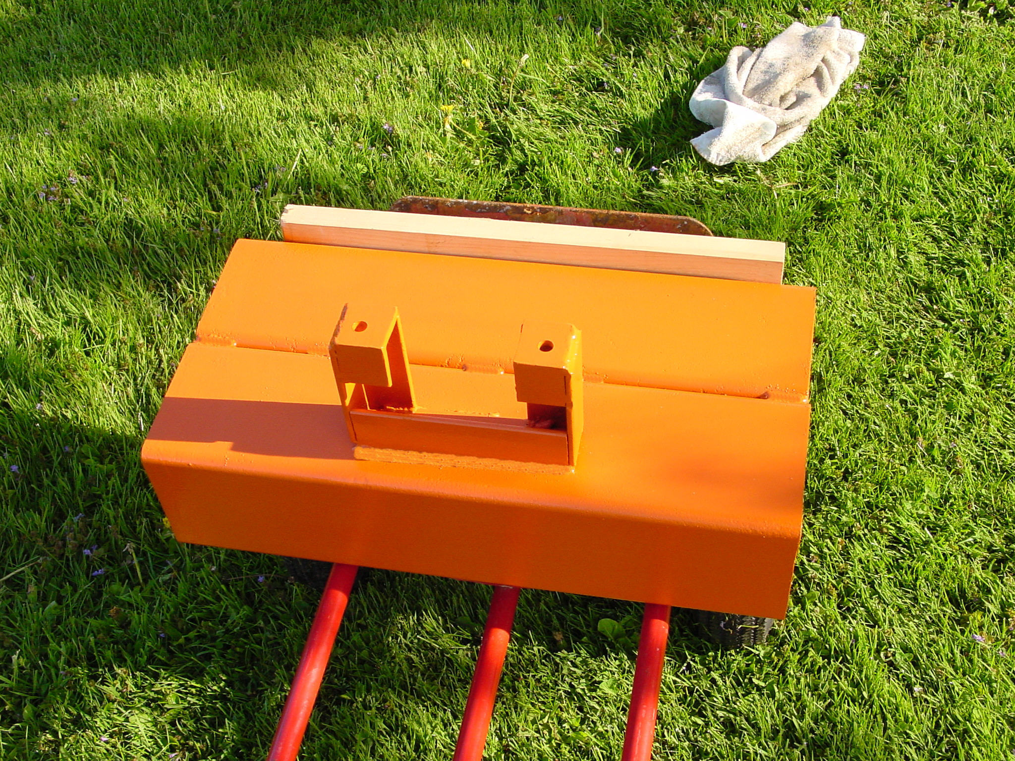

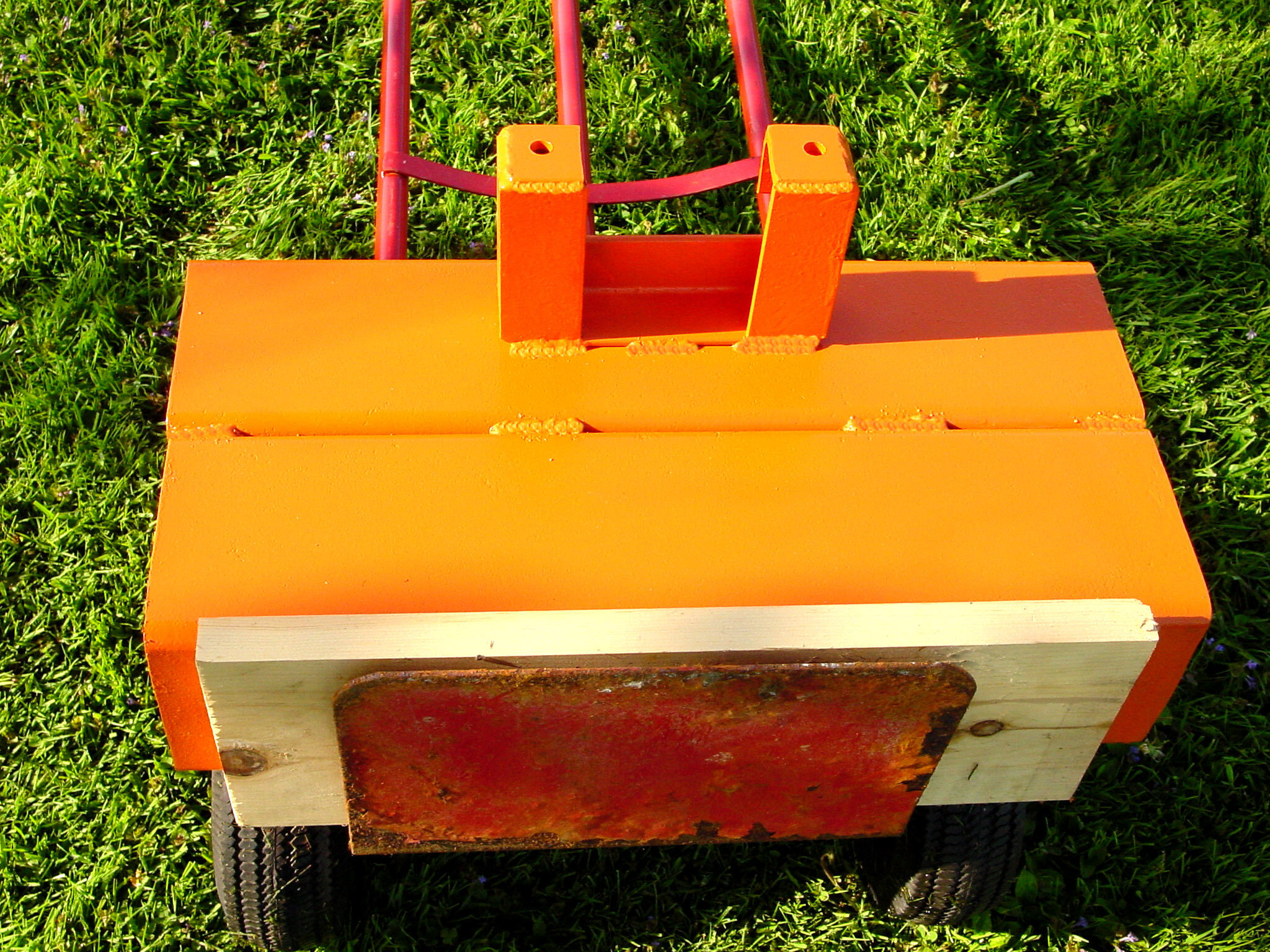

I'd like to see how it is attached.
   / Front Ballast

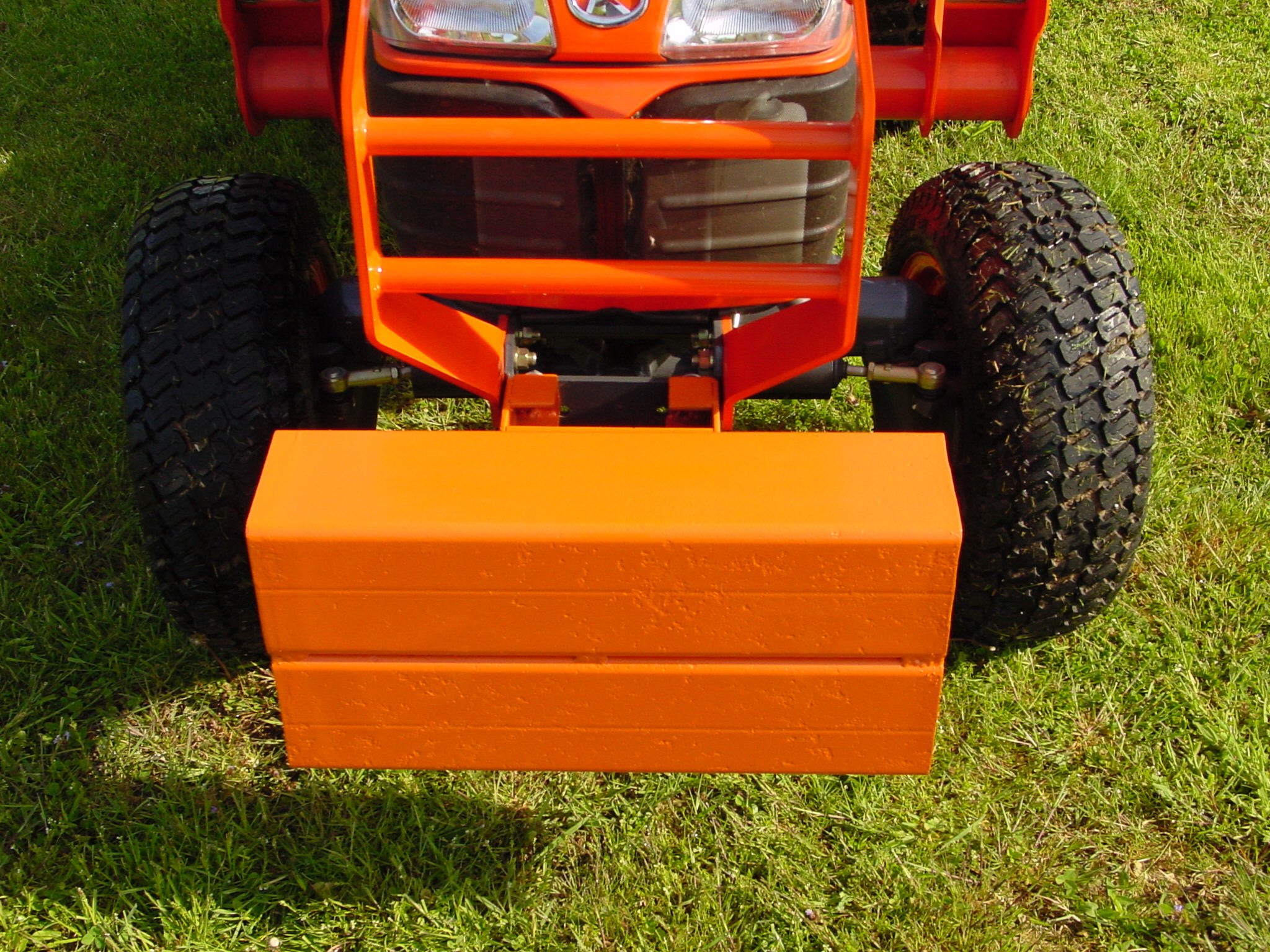

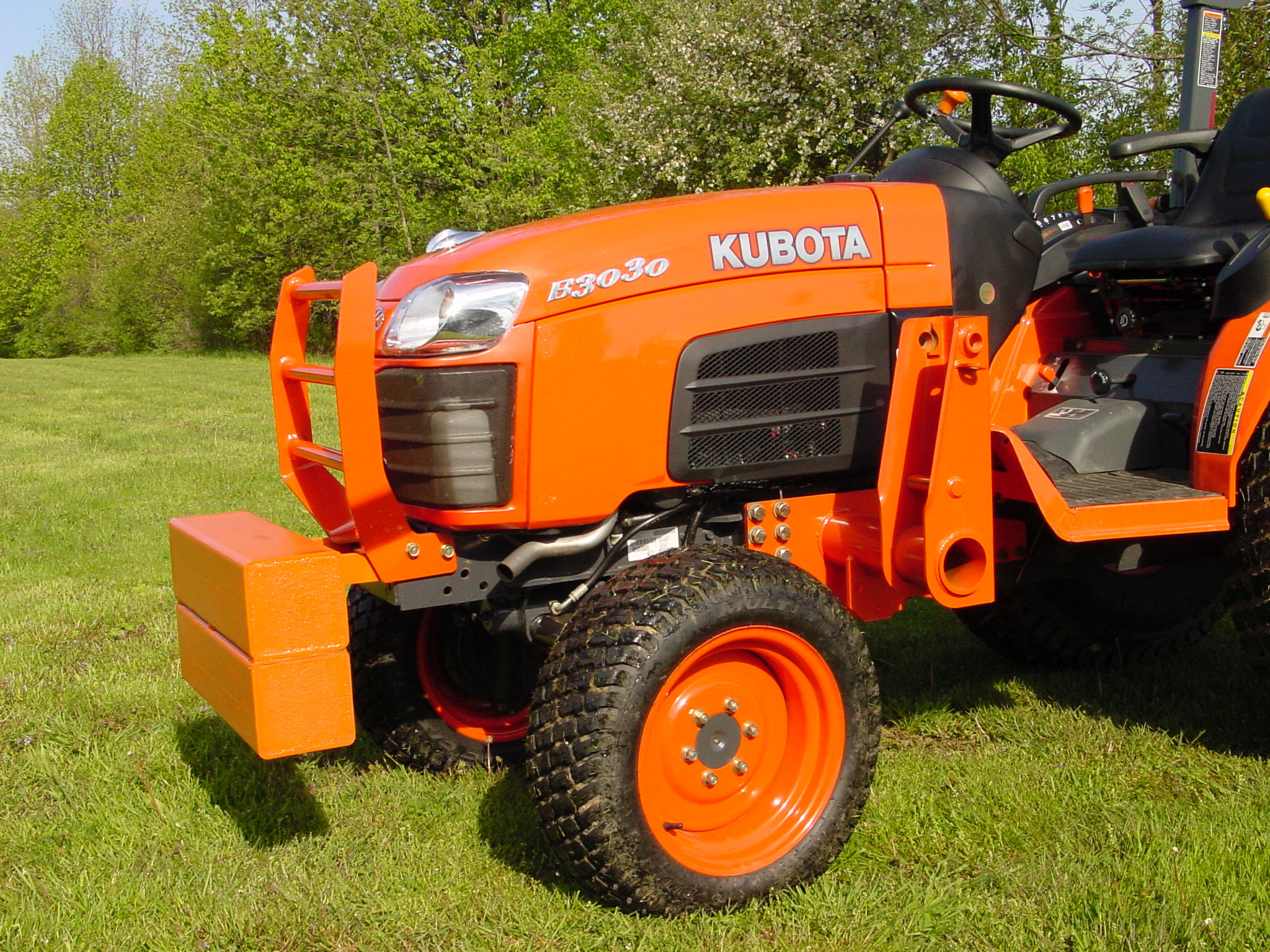

I made it from 1/4" x 6" x 24" sq. stock. It is filled with concrete and comes in at 205 lbs. I can bolt & unbolt it from the tractor (2 bolts) in 10 minutes if need be. I use my floor jack which makes it easy to raise & lower it in position to mount. It really has helped the steering when I have the rotary cutter hooked up. I have about $25.00 invested and a few hrs. of work making it.

   / Front Ballast #7
Nice job & nice tractor too :D
Mount that weight with some good HD bolts, if it comes loose ,
your mower will find it real quick :eek:

   / Front Ballast #8
better be some grade 8 3/4" bolts there!
i know around my yard, id snap them off in a hear beet bouncing around my rutted yard....

With your skills, I'd darn sure add a 2" receiver type setup to the front of tractor and slide that baby in there, secure with a pin, and be done with it in about 10 seconds. :)
