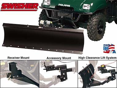

This looks pretty fancy but kind of expensive once you buy the blade, mount and winch. But maybe will give some ideas. Swisher Blade

Modifying an ATV plow would be the most cost effective. You will need to fabricate some mounts but it is doable. If you already have a rear blade just use that for snow. I used a 6 footer on the back of a B7500 to clear a 740 foot very steep driveway and it worked brilliantly. With a rear blade and a drive like you state you should be done in 15 minutes or so.
   / Front blade for a Kubota BX 1500 #6
I put a 42" garden tractor snow blade on the front of my Yanmar gray market YM1301D, used it one winter, then put it on my YM1110D. It had a boom from the blade that went back under the front axle and mounted to the under side of the tractor. I made a mounting plate that bolted to the under side of the YM1110D. For the lift mechanism, I used pulleys and cable from the 3ph. You can see this blade on my YM1301D at my web page.
