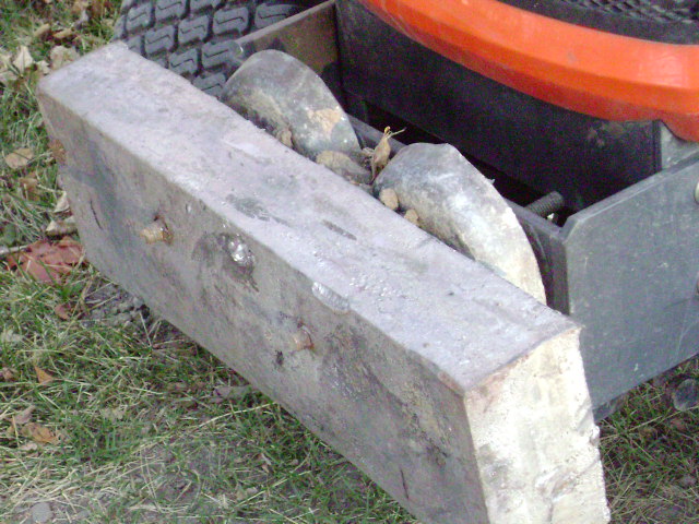

I had the same problem with being light on the front end so this is what I did.
It's a solid block of lead that I melted into an old tool box, I melted old batteries and a pail full of wheel balancing weights that I got from the local tire shop. It ain't pretty but it's compact and it's heavy and doesn't interfere with the loader. I can't remember exactly but I think that it weighs in at around 220 pounds or so.
Unfortunately that is right where my snow blade quick hitch sits. :(
