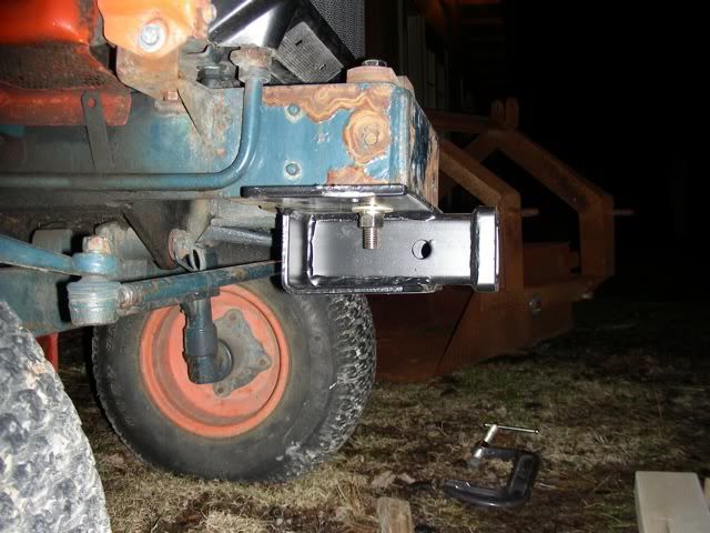

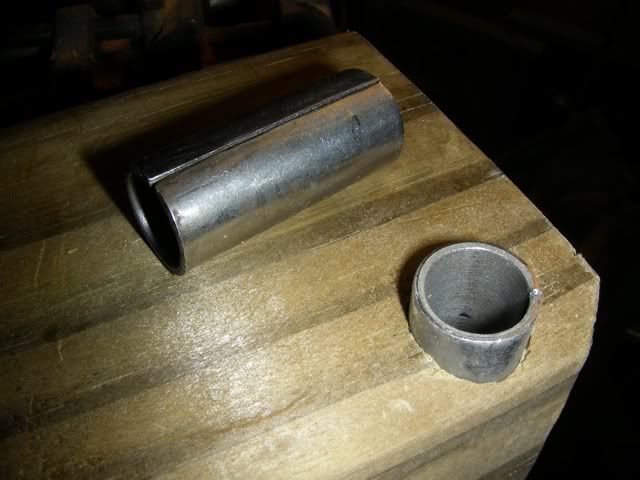

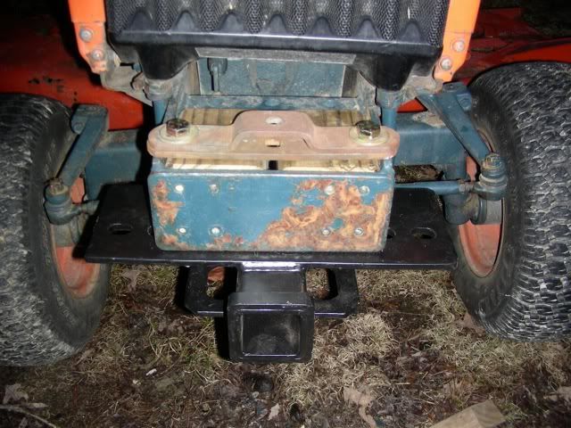

OK, made it through Christmas and finally got back to this project! I got the hitch receiver mounted today. I started by making some blocks to fit inside the front frame extension that would keep the bolts from being able to shift around.
I used 1/2" grade 8 bolts, but the holes in the hitch receiver were 5/8", so I sunk bushings into the bottom side of my wood filler blocks to take up the space.
I used a bracket I had left over (from another hitch installation on a car I no longer have) to clamp across the top of the frame extension. The wood blocks might not have been necessary but seemed like a good idea.
Here is a side view:
I then assembled and mounted the carrier I got at Harbor Freight, which is supposed to be rated for 500 pounds, so with that full of wood it should make a decent front counterweight to my carryall.
By then it was cold and dark, so I'll have to try it all out another day!
One nice thing about the hitch receiver is that now I can easily mount a variety of other useful items there, such as a winch, a trailer ball, etc. Oh boy, more toys!
Happy New Year to all!
