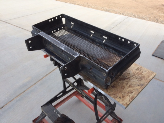

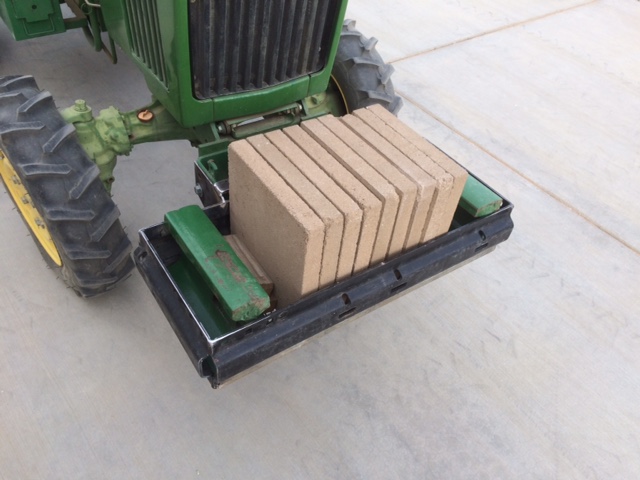

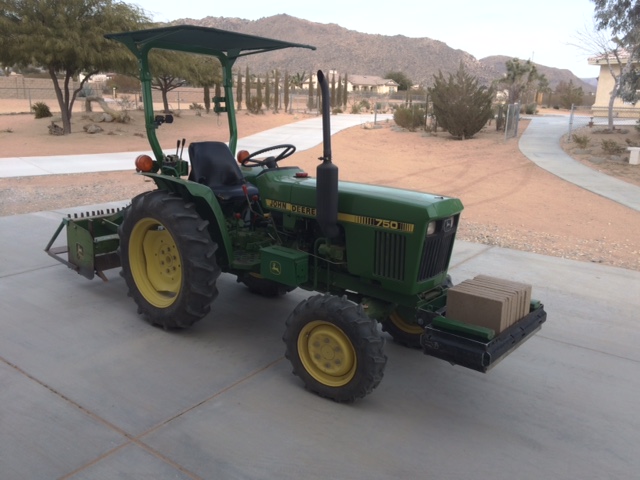

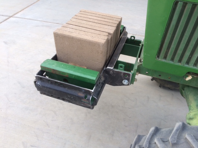

Without a FEL my little 750 gets a little light in the front end so I took a couple old 5th wheel bed rails and fixed that problem. The box weighs about as much as the two pieces of RR track I had hanging off the front before so probably won't need the concrete pavers so there will be room for storage of chains and tools
   / Front carrier/ weight box #2
That's very similar to what we used to use on the front of our 2WD non FEL Universal tractor. We just put in an old D style battery, not as much weight, but it was enough to get some steering with a blower on the back.
Good place to throw a chain or two as well.
