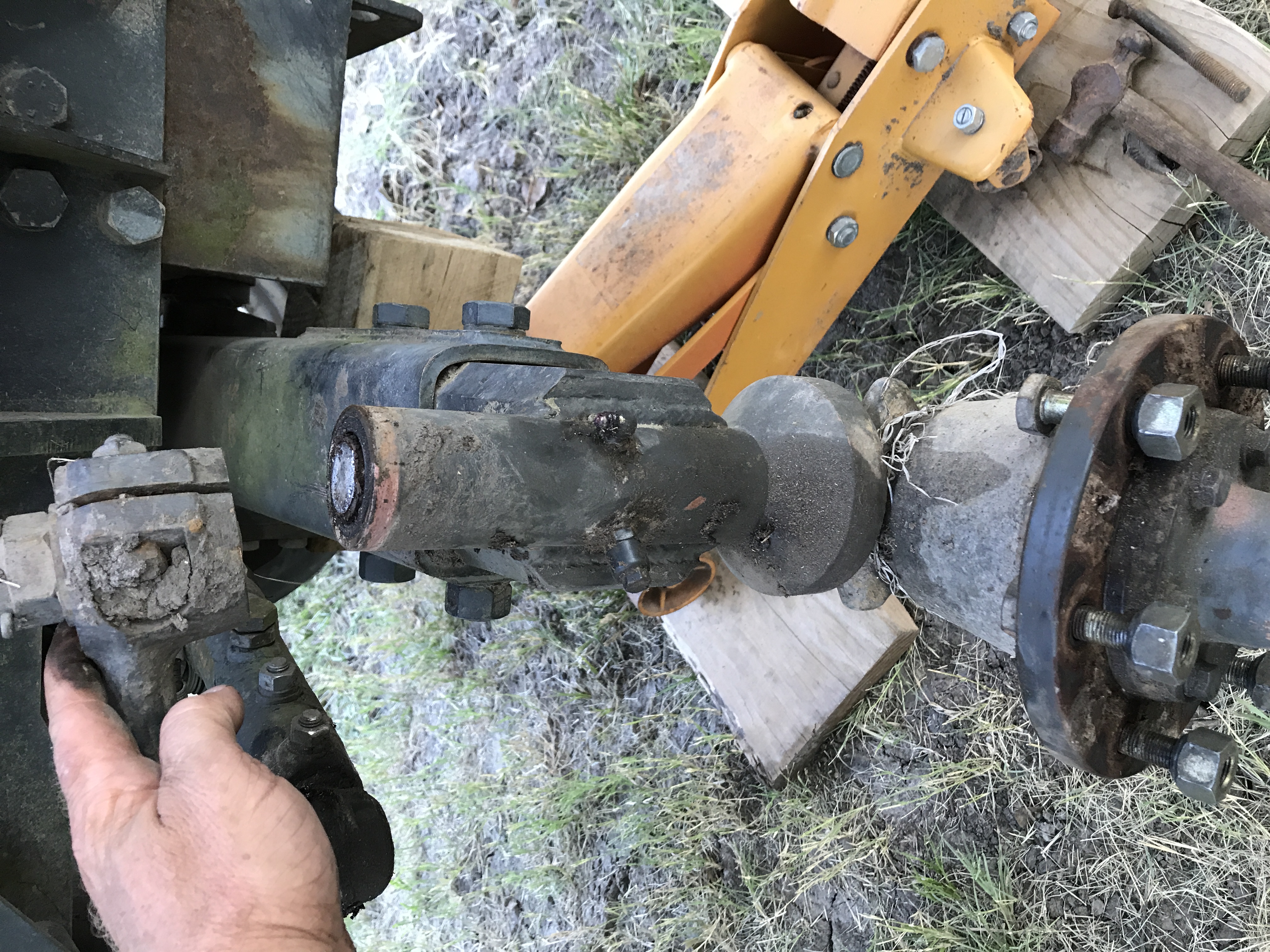

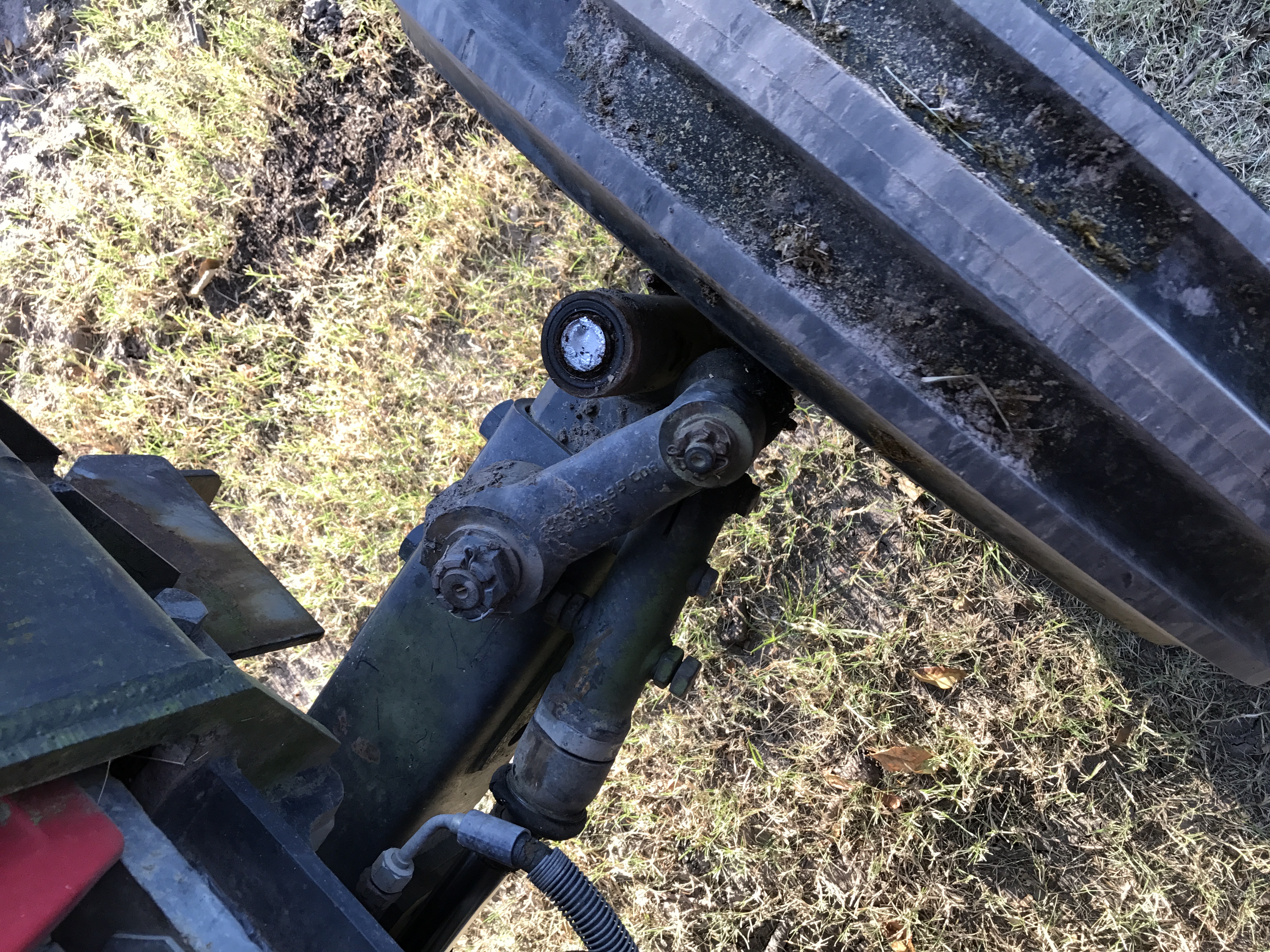

This happened today. I think the part in my hand is the arm steering knuckle. How do I remove the part from there to hub. Do you beat it out like a ball joint? Don't wanna tear anything up. IMG_5380.JPGIMG_5383.JPG

You should be able to drive it out. I have hammered down on the hub with success. What caused it to break?
   / Front end help #3
I'm seeing a seal that is right at the break. You will need to remove the seal and inspect what is below that. I'm guessing it's a snap ring- which would be hard to see with all the grease. Something has to hold that in if the front wheel is unweighted.

Not really sure. It's been screeching some but I couldn't figure out where it was coming from. Greased it all up real good. Moved a trailer with ball mounted on bucket and noticed it broke when headed back to house.
