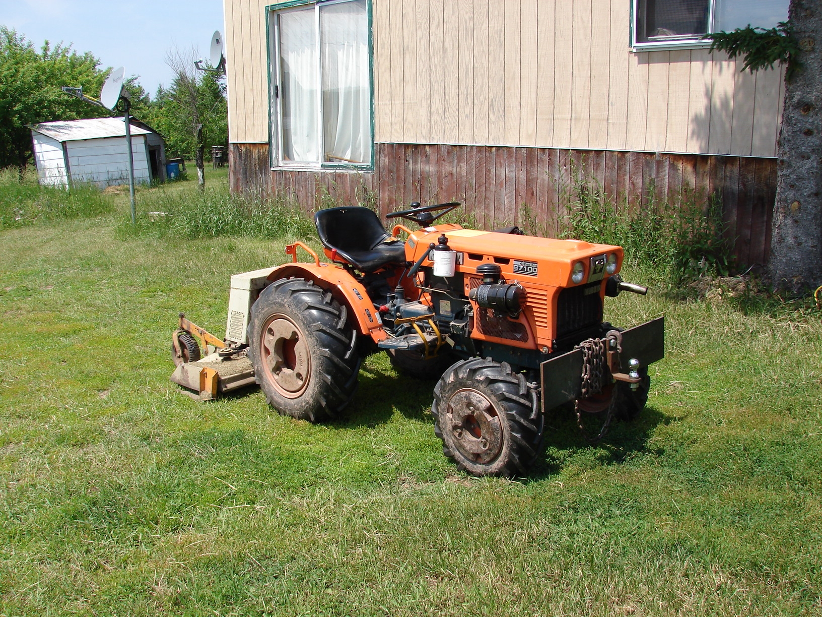

My first 6 years back to the UP of Michigan I put a 50" Buhler rear snowblower on the back of my B7100DT. Don't know how much it weighed, but it was heavy and made the front end very light.
I put a flat steel bumper on the front and hung two 150 lb chunks of steel on the bumper to keep the front end down so I could steer. Worked great and moved a lot of snow with it.
Here's the bumper, no pictures of the weights handy.
