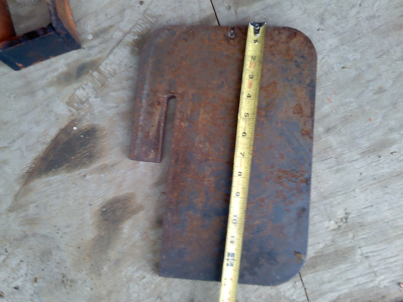

I use front end weights. I made some from some cutouts at work, they are 3/4" thick and weigh about 25# each and have 8. I only put them on when I need to hold the front down then take them off because I dont want the weight while I am mowing (I have a MMM) Used to have front wheels loaded with calcium but never liked the weight in the summer. we had a job the required us to cut a window in the steel that was about 10"x14" and I grabbed 8 to make the front weights. I cut out the corner and milled a slot to fit over the bumper on my B7510 and they work great! :thumbsup: I would never go back to loaded tires!

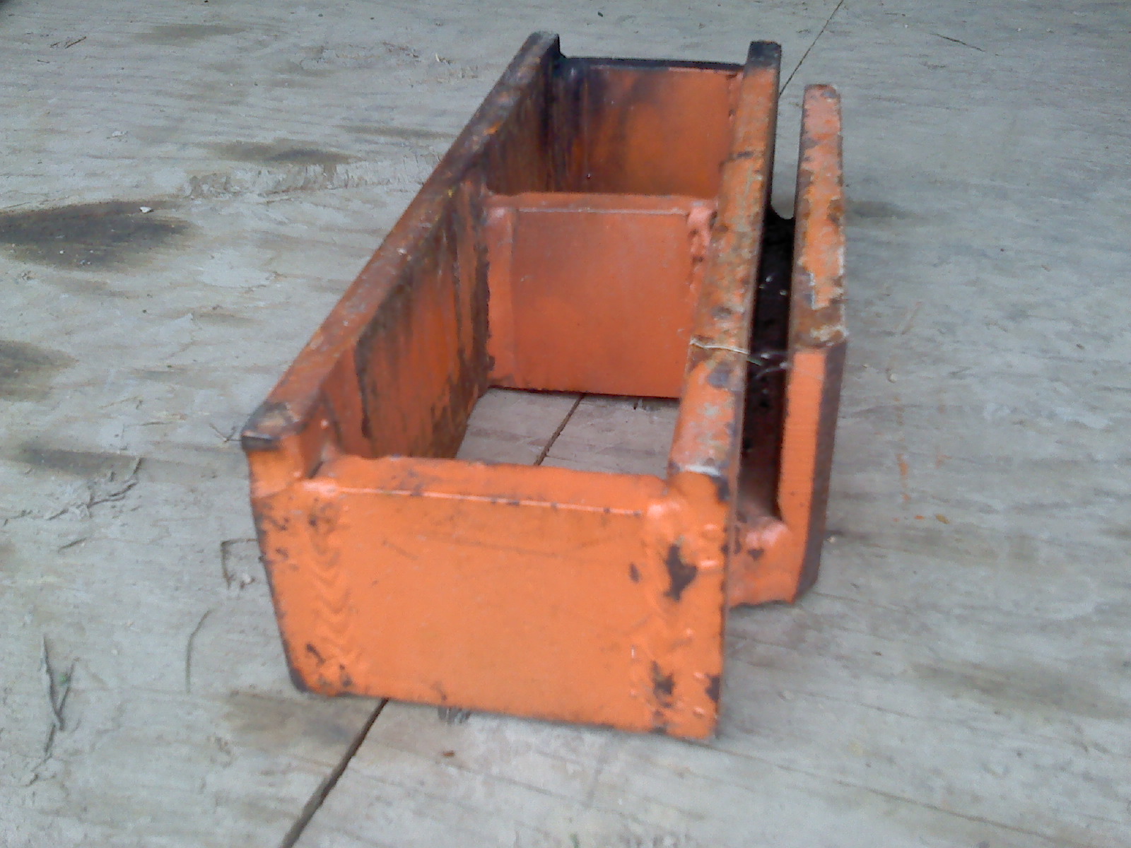

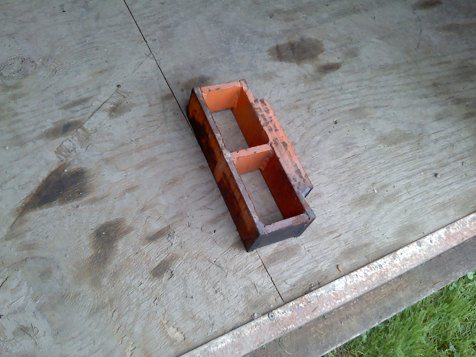

Here are some pics of my weights and a bracket I made.
The first pics are of the bracket. It just slides over the bumper and then I put the weights on it. No bolts or fasteners of any kind. Simple!!

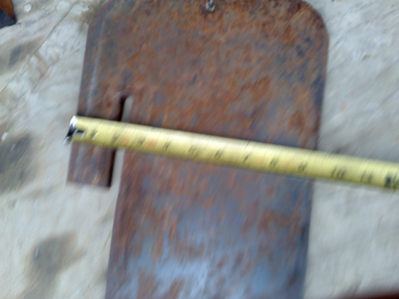

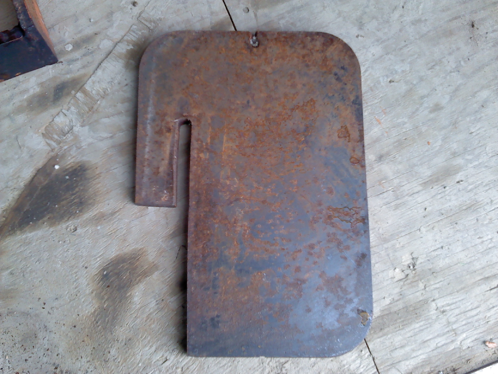

Here are the weights cut from a sheet of 3/4" thick plate. These were actualy scrap cut-outs and were being thrown away and I grabbed 10 of them. I have a friend that ran the machine right next to me (horizontal mill) cut the notches for me. They just slide over the bracket that slides onto the bumper. Again no fasteners just gravity to hold them on. I have had them 6 or 7 years nad never had a problem with them falling off. :thumbsup:
