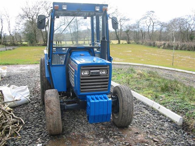

Recently posted a 3ph pallet fork on "build it yourself"
To balance the load, I needed front weights. Called into local 2nd hand tractor dealers for some ideas. Showed me out to his rear yard, about 60 complete sets of weights for every "common" tractor make. "Something there should fit"
Had the measurement of the front weight bracket. These "Ford" weights fit perfectly - a snug fit.
Once home, cleaned and painted in Iseki blue, et voila!! /forums/images/graemlins/laugh.gif
Goes to show. No need to always look only for "badged" parts. Look around, there are plenty of options available. /forums/images/graemlins/wink.gif

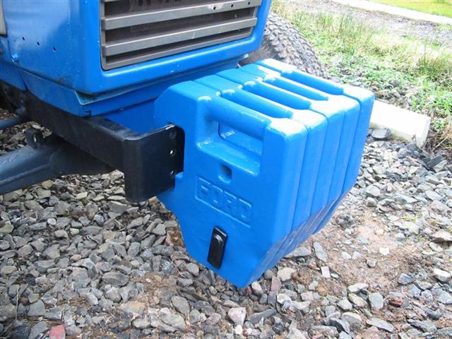

Close up view of weights.
See what I mean about snug fit /forums/images/graemlins/smile.gif
