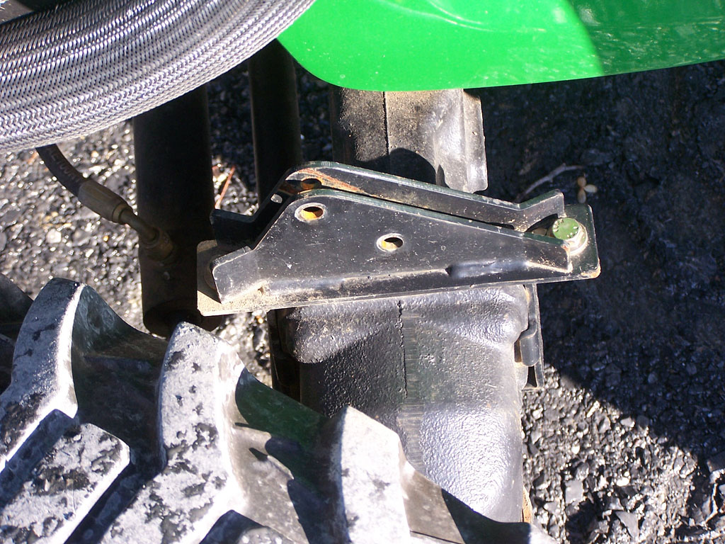

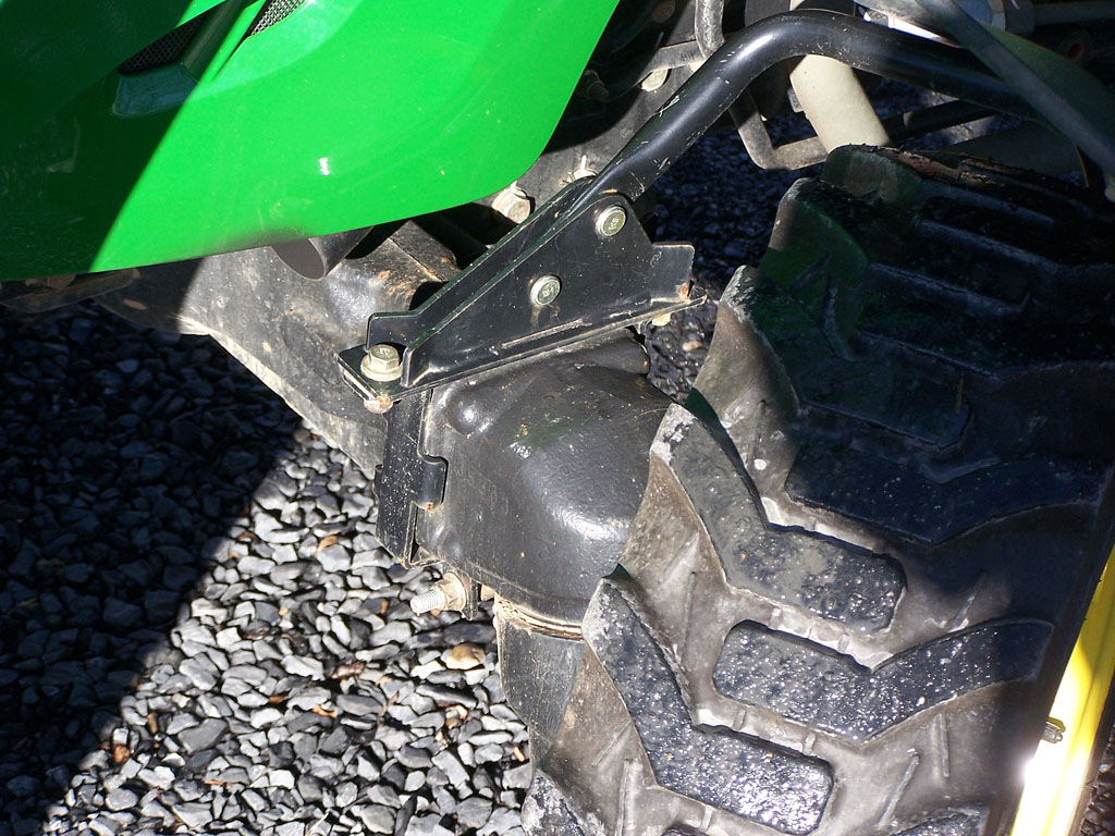

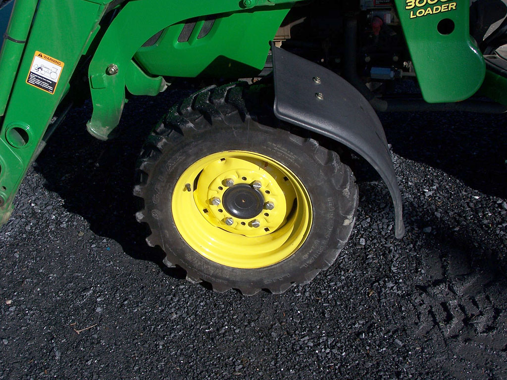

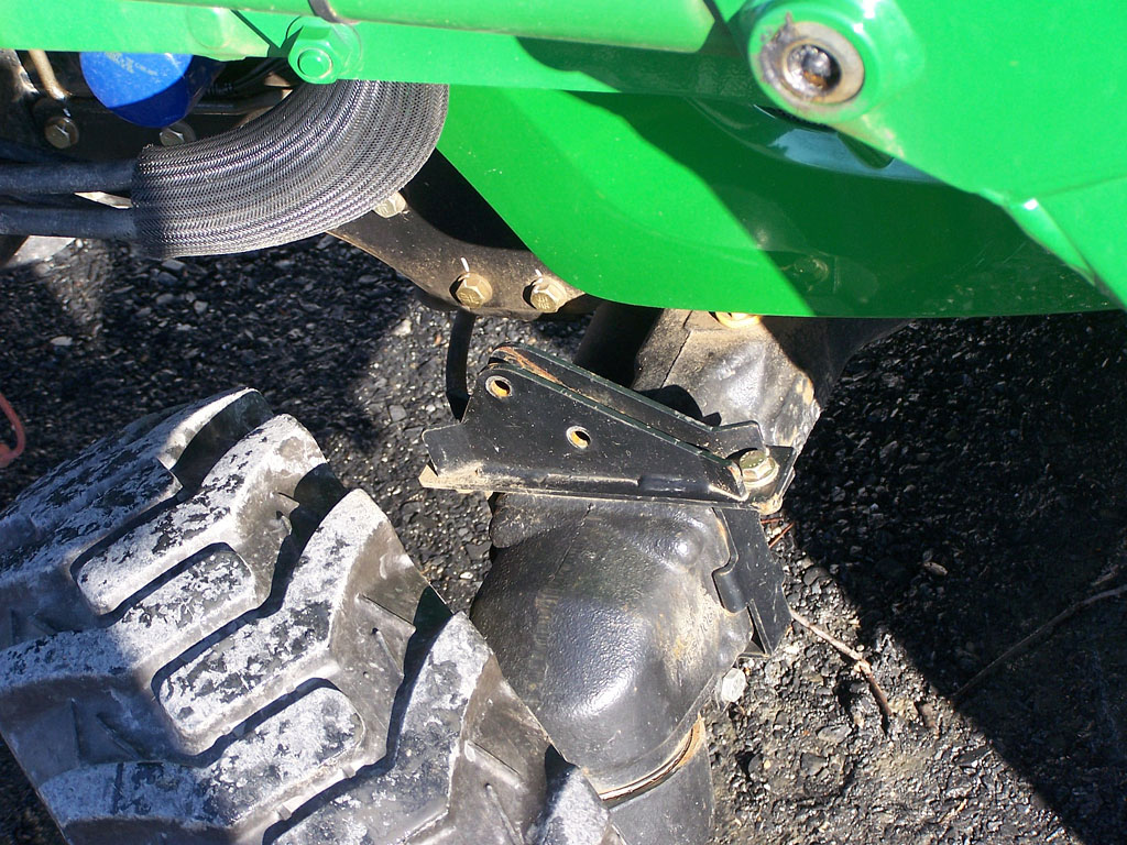

Does any one have the front fenders on your 3XXX series? I want some for my 2520 but they dont offer them. I think the 3XXX series would be too big. I know I would have to modify the mounting. Also the 500 series garden tractors are to small. If anyone has the fenders could you post some close up pictures so I can see how they mount. The lit. books dont show much and I have never seen any in person. Thanks!!!

I have a 3120 with front fenders, which I absolutely hate. I'll see if I can't get some pix posted for you later...
   / Front fenders on 3000 series #5
OK, here are some pix of the brackets and the finished assembly. You may notice that the right fender is missing. It always got caught in my R-4's when I made a sharp turn, emanating a pleasant WHAP - WHAP - WHAP sound, and I finally made one sharp turn too many and it got all twisted up. Another thing is you have to keep after the mounting bolts as they'll loosen up over time.

Thanks for the pics...Those pics probably will save a lot of guys from spending the $300 and some odd dollars of adding that option!
