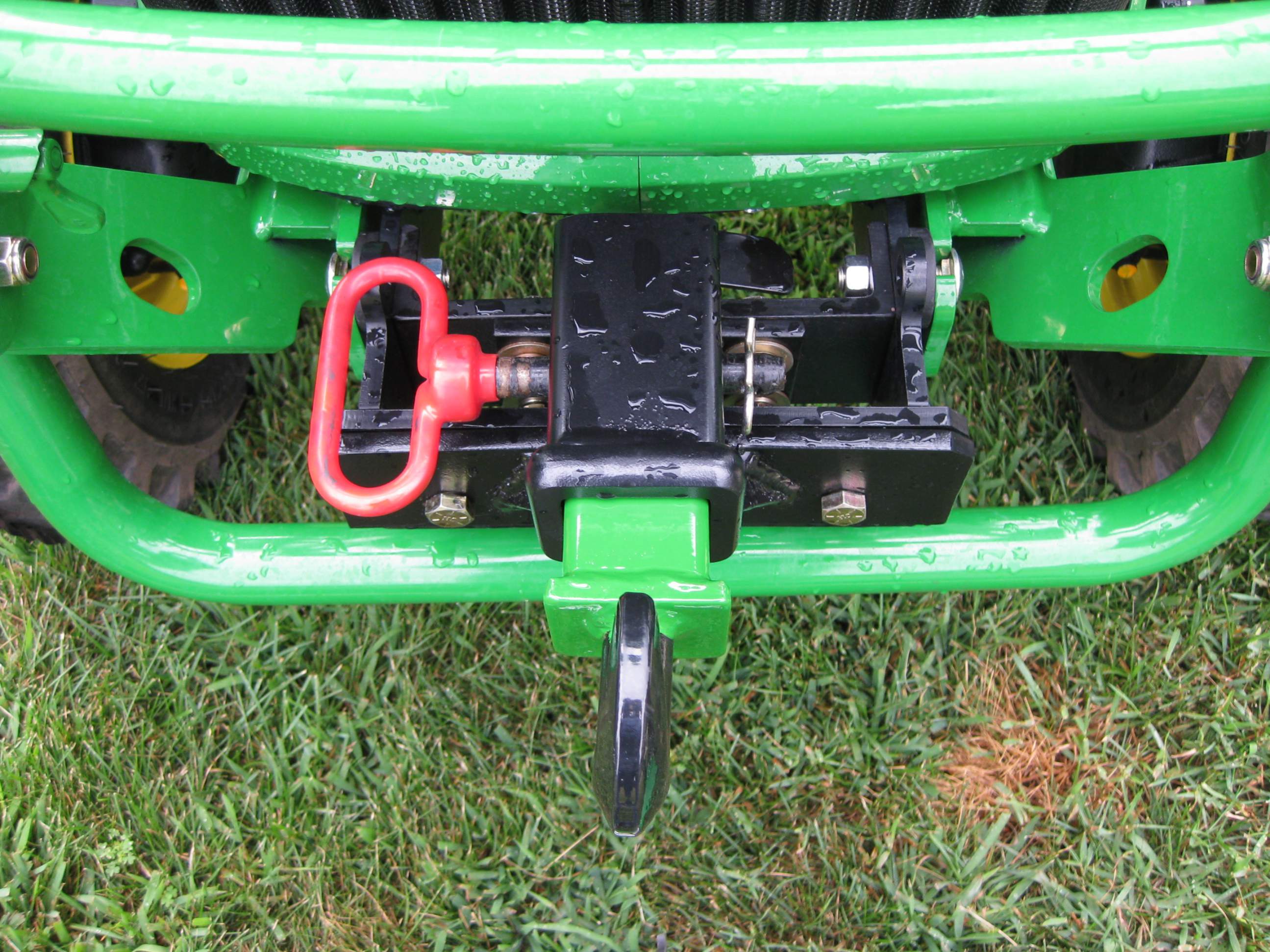

IMG_1749.jpgIMG_1747.jpg Needed a way to be able to move my trailer when I had my cutter on back so I added a receiver to the front of my 2720.

I made one out of 4 x 1/4 inch angle iron for my BIL. Just be careful about where the wink link is. My BIL bent the angle and tweaked the frame a small bit with too big of a camper trailer he was trying to park.

Did you buy the receiver assembly or make it? It looks very hand. Thanks Bigtiller

I built this hitch. Trailer is my landscape trailer, used to haul the tractor. It weighs about 2000#. The flat stock attached to the frame is 3/8". I purchased the square blank from the local fleet farm. IMG_1754.jpg Back of receiver is attached under it to a flat piece bolted to the grill guard bolts.
