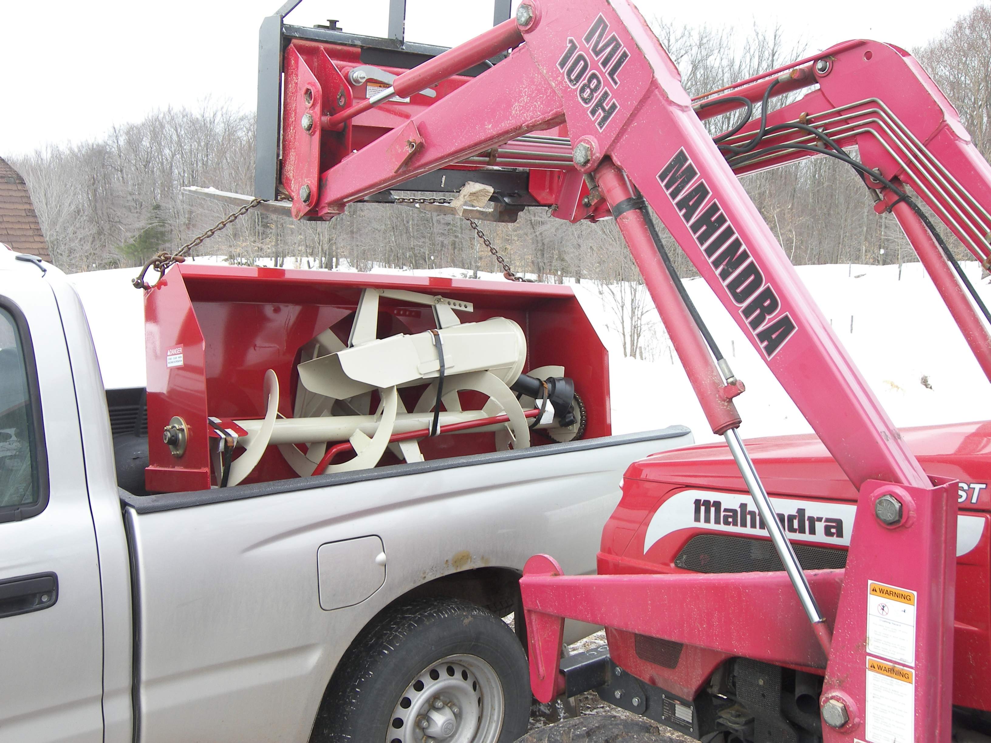

I'm probably wrong on this but i thought the ML 106 and the ML108H were the same frame, 106 had smaller cylinders though.I got a "tool Carrier" from my Mahindra dealer about 4 years ago. I have 2 tractors now and it is a MUST! ! ! heres the only pictures i have and i have my forks on and transporting one of my buckets to a job. . .
I know there are companies that custom build tool carriers for tractors, all you need is to fill in the numbers for loader arm distances and dump cylinder pin in relation to loader pin and away you go. Internet search will help. Good luck . . . John
