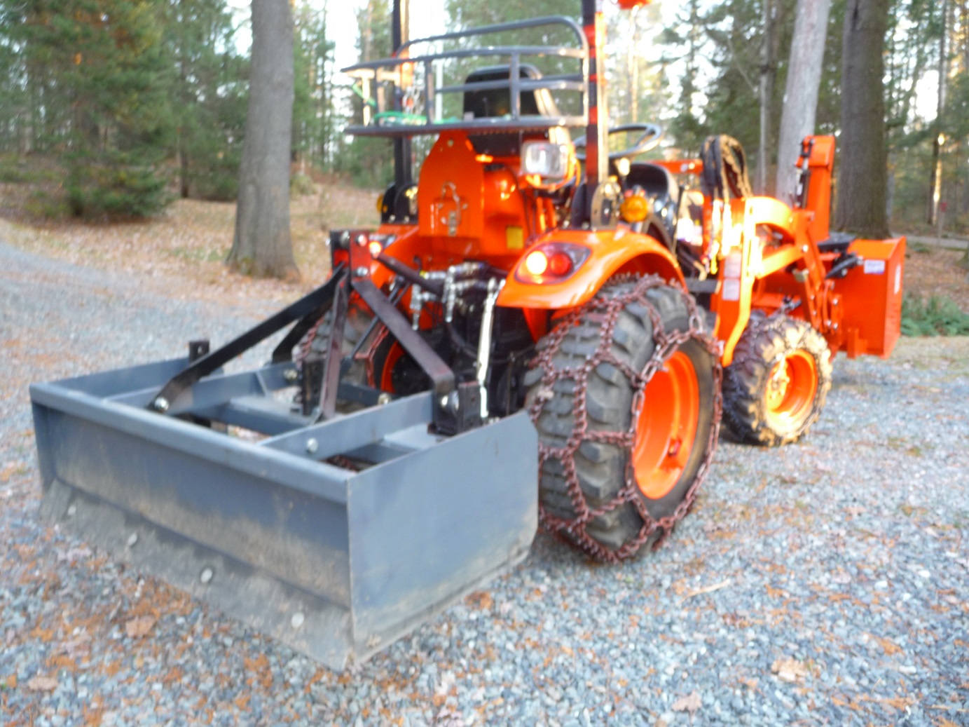

Here is a side view of the subframe with the black pin that holds the front up.
The second pin is just behind the step.
If you cannot see I will try and get better pics.
   / Front mount Kioti snow blower #22
Thanks for Pics K man, that definitely looks like more than a 1 man install. I think I'll stay with the rear mount until my neck can't take it anymore.

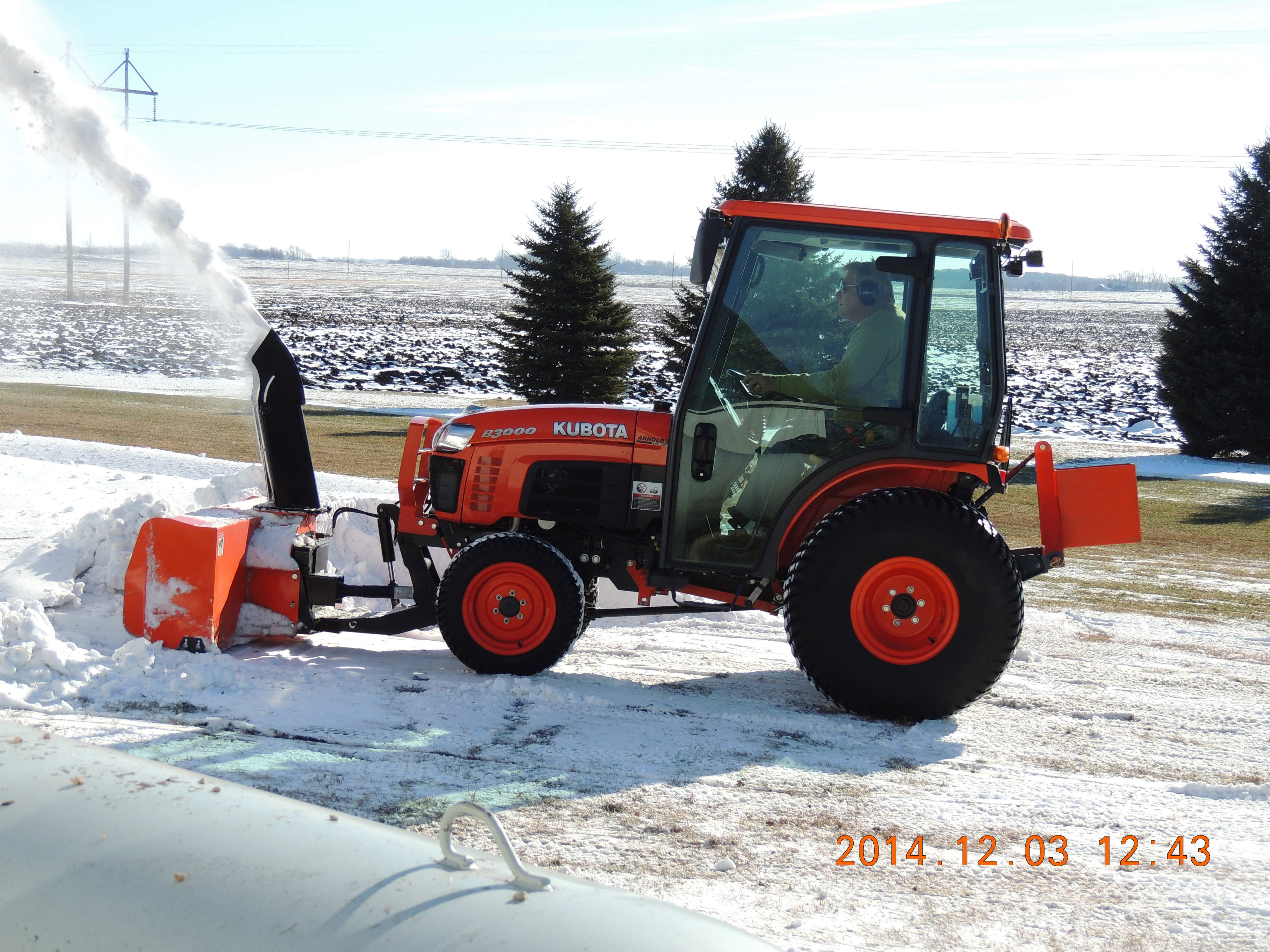

Don't feel like the Lone Ranger, the Kubota B-3000 has an undercarriage that the Front mount blower is attached to.... first couple of times it was a real hassle mounting it by myself. But it's well worth effort once it's mounted and up & running. Now it's a piece of cake to put on . :thumbsup:
Get my Drift ! :D

That picture says it all as far as cab / no cab . Nice pic , like the headset .

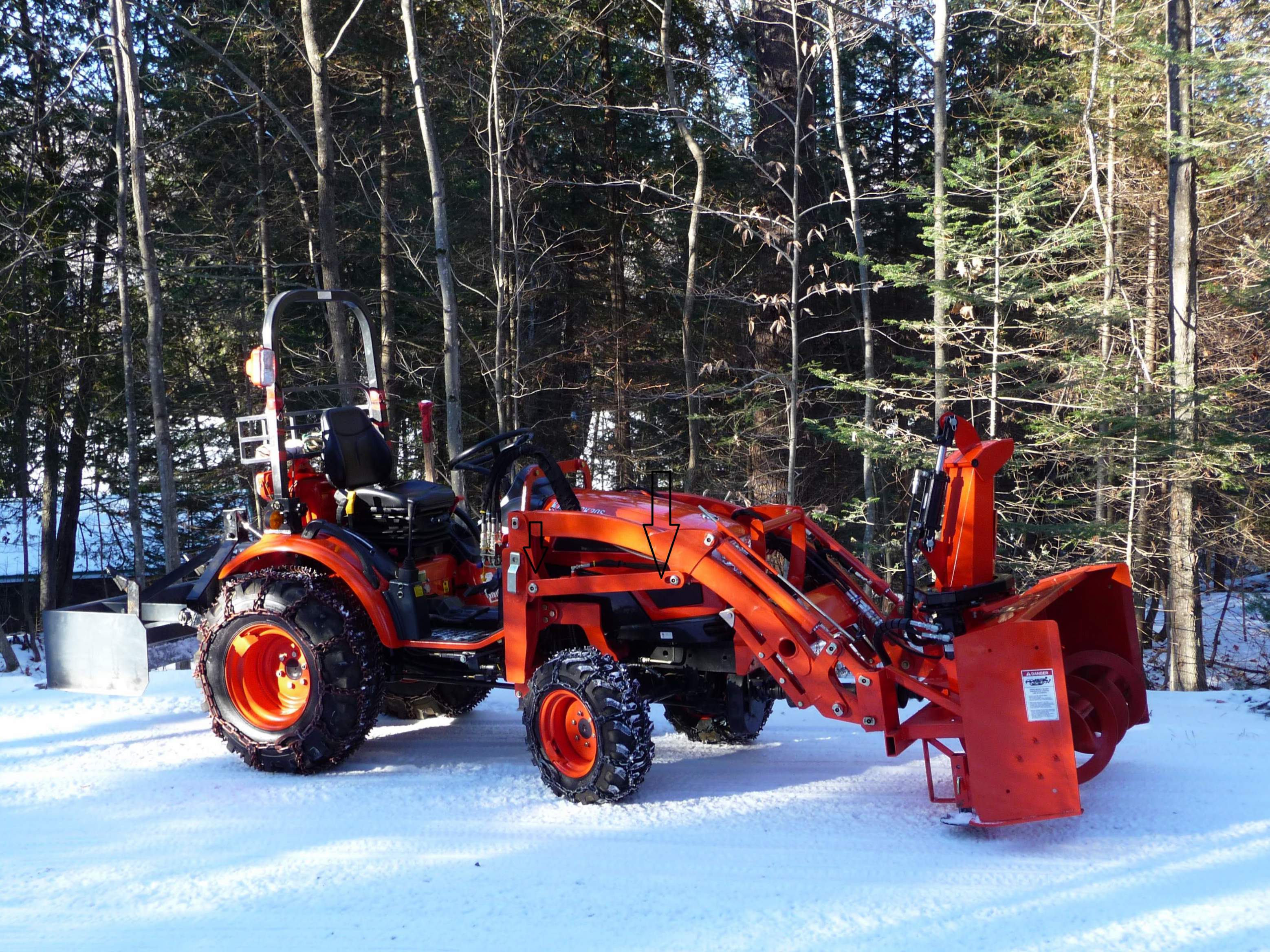

It's a heavy set up... But with weight comes reliability! It have never failed, but it's on the heavy side. I have a friend who combined in a late fall: oil change - maintenance - chain installation - front mounted snow blower on the same service call. Make sense to me.

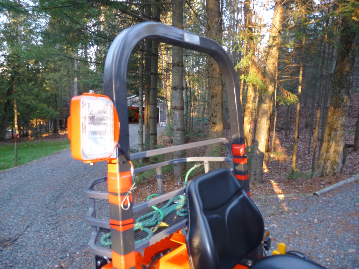

Nice looking setup. What is that behind the driver seat? Is it a carry bin or roll cage?
   / Front mount Kioti snow blower #32
Thanks, it's a carry bin, "chainsaw special, very handy!
