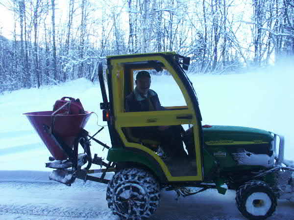

I installed the flood JD worklights on the front of my cab under the roof. I've blown snow 6 times in the last 2 weeks and they have provided superb lighting.
   / front-mount snowblower & worklights #8
Off subject , but I saw the 2 bay garage in one of the pictures, I'll call it temporary for lack of a better name. How has it worked for you. I can't afford to build the pole barn this year and did alot of research and came close to buying one, unfortunately it wasn't warranted aganst snow and we get a fair amount here in WNY. Any and all comments are appreciated.
