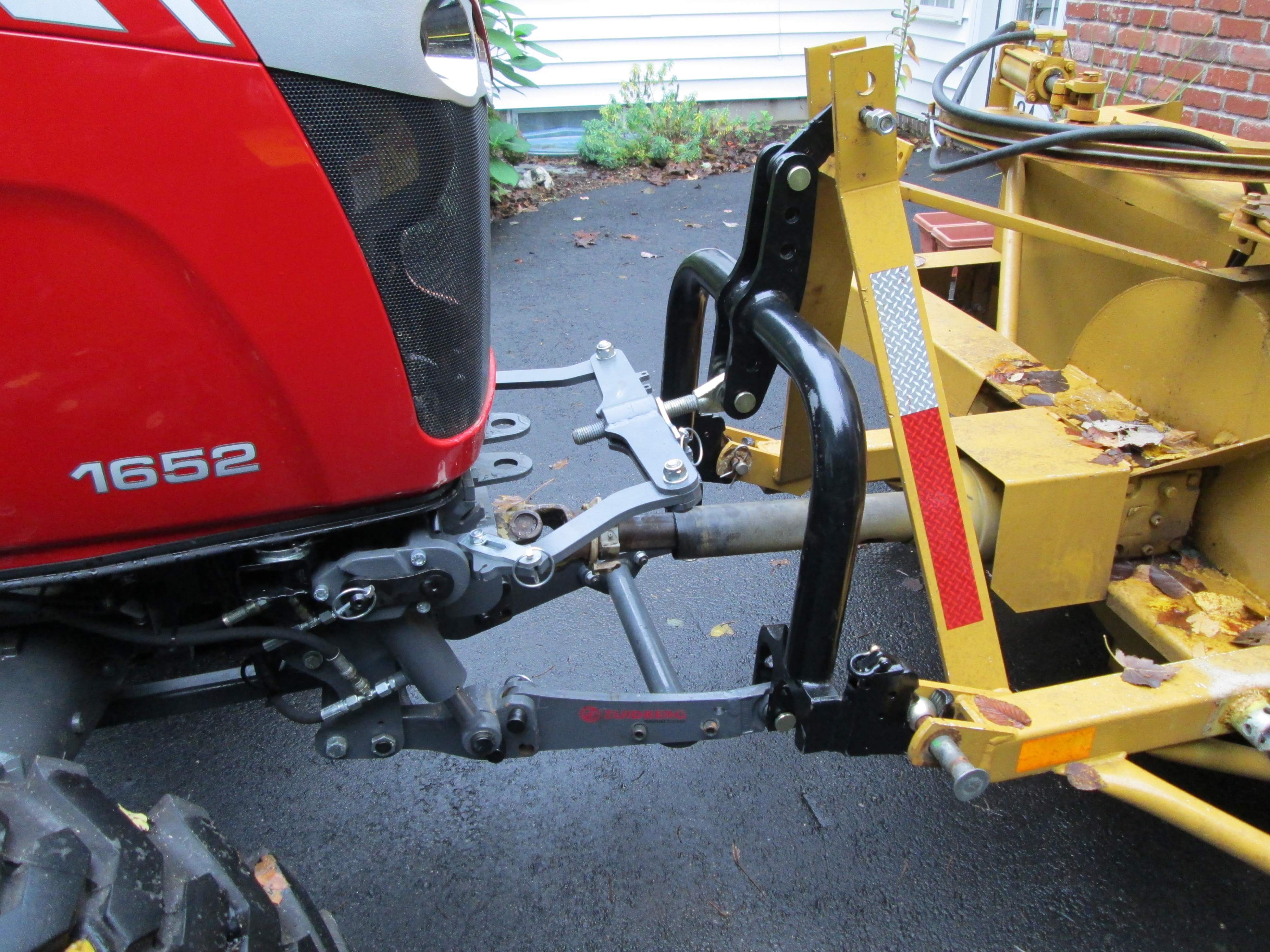

i just installed a front pto and 3 pt hitch on my Massey 1652 called Frontlink...it is awesome no more backing up if i get prolonged snowplowing duties....work for my town. anyone interested let me know and i can share pics etc. Gravelman

Of course we're interested. Post away!

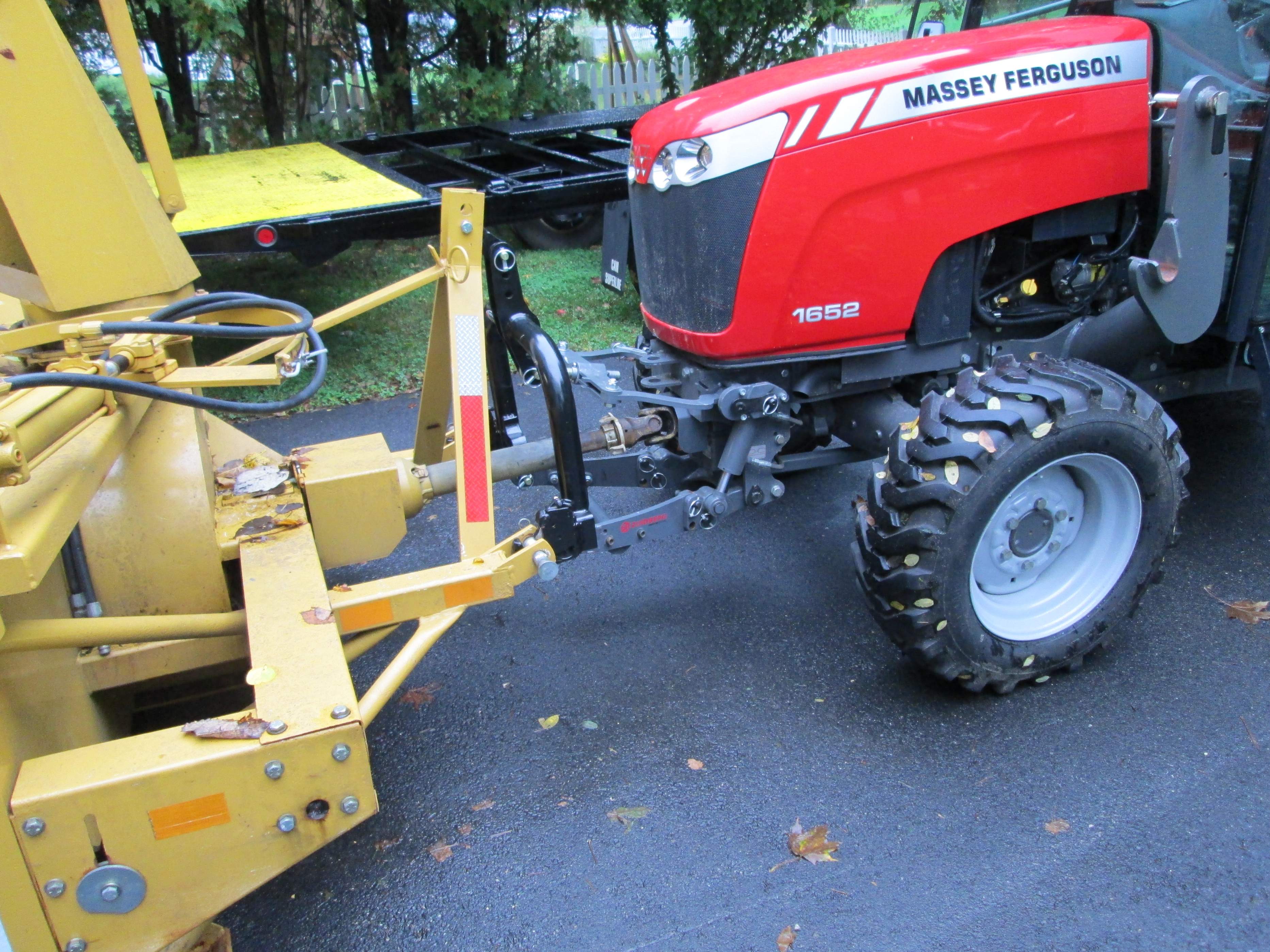

quick hitch 004.jpgThe best way i can describe it is for all of you to go to www.zuidberg.com It is a 3 pt hitch and front mount pto. Cost me about $11,000. but i can tell you it is a very very rugged piece of gear. i will try to include some pictures of my setup but their website describes it best. I plow for my municipality and two years ago...snowblowed several miles of road...widening 5 weeks, 7 days a week BACKING UP No more of that. The up and down i contolled bu the bucket hydraulics and the chute turn control is also controlled by the bucket roll out, roll in control stick. It is a very slick setup but i certainly would not recommend the expense if you do little blowing... in my situation, it is well worth it.quick hitch 001.jpg For general plowing i use the rear blower and a power angle plow on the front of the loader with my quick attach connection. If im going to switch over to the front pto, i dorp the bucket and use the frontlink system. Hope this helps. Now all i need is SNOW and lots of it.

That looks pretty sweet. Make sure to post some video footage in action if you have the means to do so. If I ever hit the lotto I'd buy a New Holland Powerstar or something similar and equip it with a front 3 point and PTO so that I could run a blower such as you've done. It looks like a really great setup.

In a lot of ways it's like my Deere hitch. The front arms even disconnect at the same spot. Because of this the loader can be attached with 90% of the hitch still left on the tractor. I also like how they use 2 hydraulic cylinders instead of one, very well built!

Nice set up. How long was the install time for hooking the system up? And when you switch from FEL to Zuidberg , approx how long to do that?

nice lineup of equipment and yes, i will take some vid... good luck, nice to hear from you
