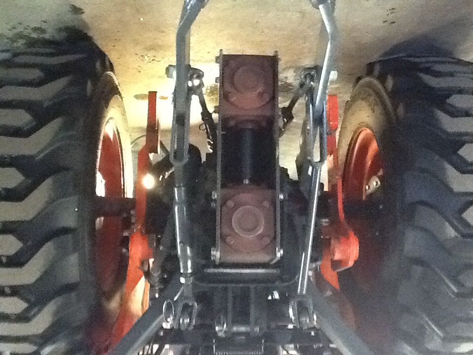

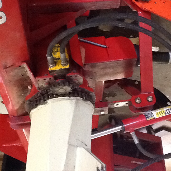

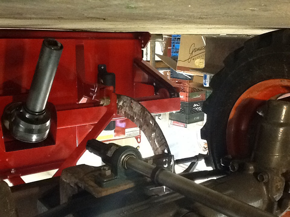

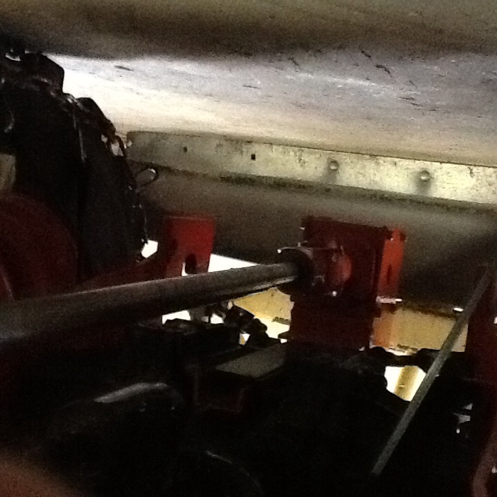

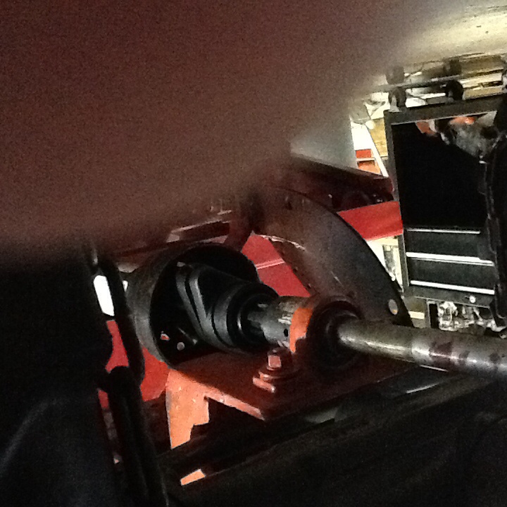

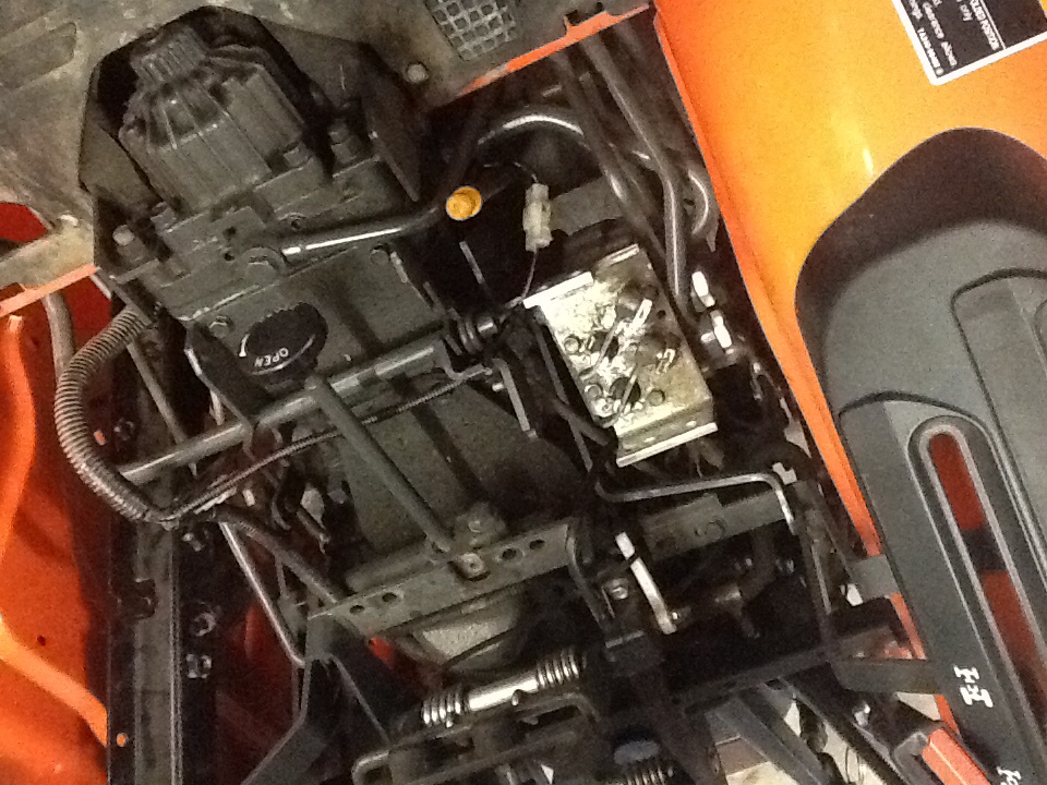

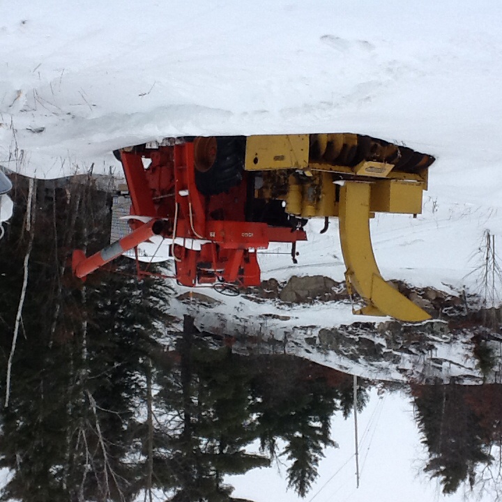

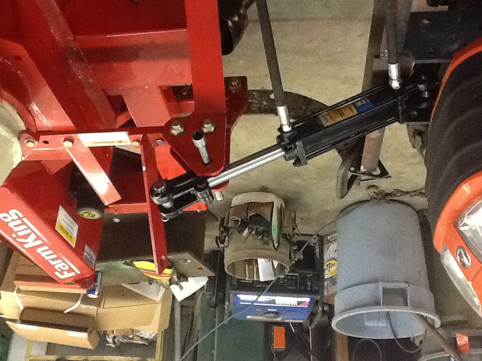

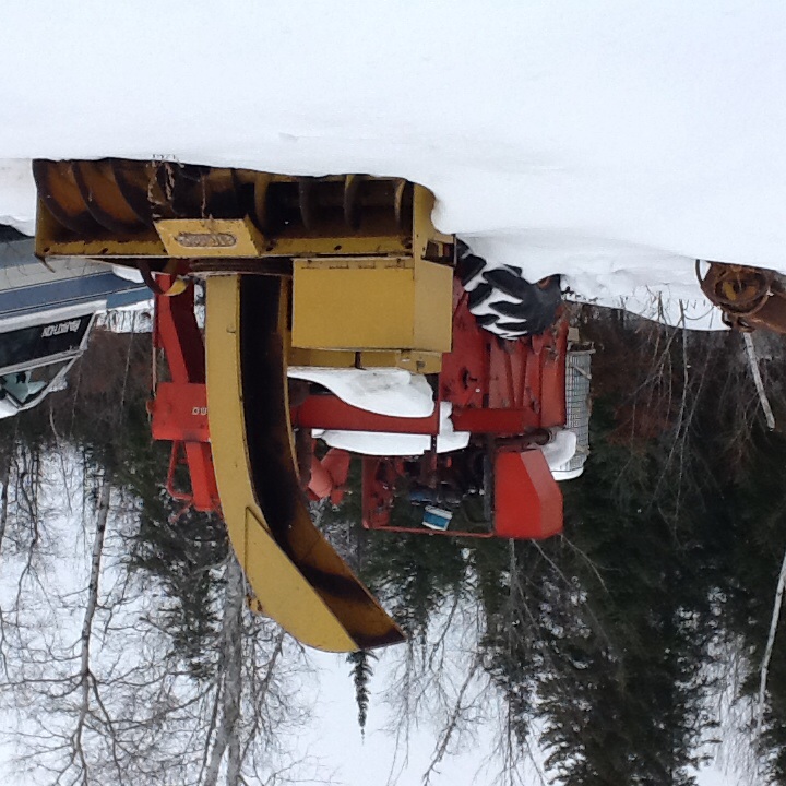

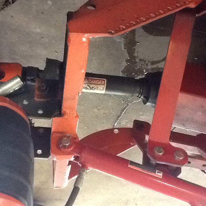

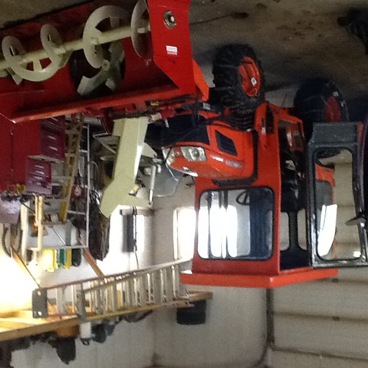

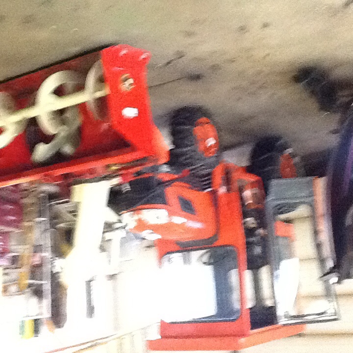

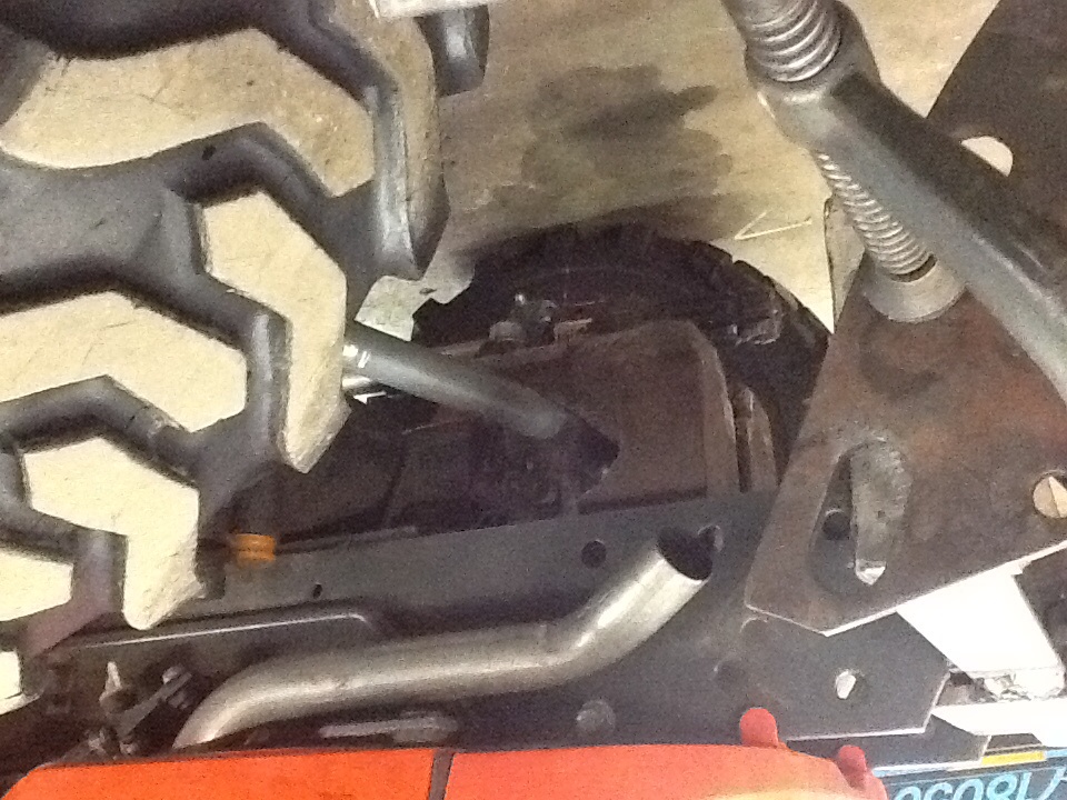

Here are a few pics of my three point hitch blower mounter on the front of my kubota image.jpgimage.jpg
Sorry they are all upside down ???? I will post some pics of completed job tomorrow

   / Front mount #2

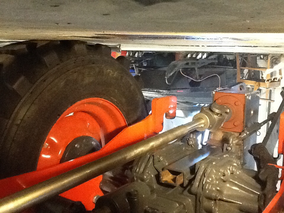

That is a cool project. Do you think the driveshaft need a carrier bearing?
   / Front mount
Roger
No the only bearing I need is at front, I have put about four hours on it now and it runs perfect

Just realized I didn't get pictures for you, my apologies for that but I see you are making out ok looks good. If there is any info you need don't hesitate to ask, now that the snow has slowed up I can get more done.
   / Front mount #5
Looks good, Lea,
when you get a chance later, let us know where and how much those gear boxs were,
and how you did the shaft etc, etc etc.:thumbsup:
   / Front mount

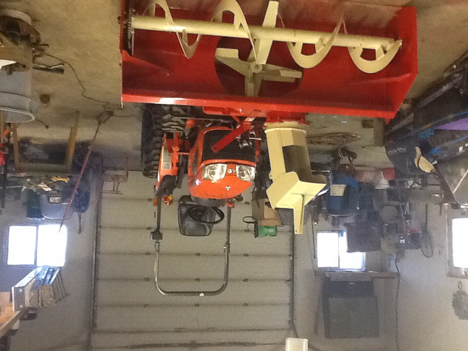

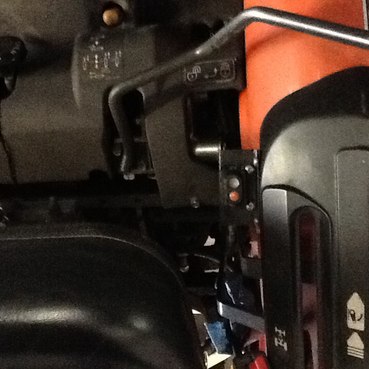

Here is more pics of finished blower. This blower is a 66" Farm King that I bought new for $1950 and then mounted on the front, all together I have around $3200 invested in the blower and the cab. The big blower is one put together last winter only to find auger was bent , I vibe rated so much I couldn't use it .

   / Front mount
Skyhook
I bought my gear boxes and most every thing else at surplus centre , they r clockwise rotation both of them and 1/1ratio since a snowblower turns counter clock wise and the rear pto turn clock wise u want your shaft out the front turning clock wise this will make the snowblower turn counter clockwise which is what u want. They cost around $145 apiece and I got all the shaft ends and couplers from them to, the had everything I need.
