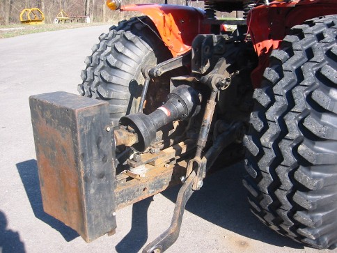

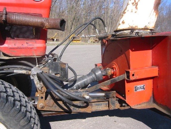

I've got a front mounted/rear driven blower on a 186D. Look at photo section under Skinman for the parts before installing for winter. Look up Ducksjunk post from 4-9-05 for a front PTO install he did (don't know how to link you there), he made a nice setup. I'll try to post some installed photos if I remember how. First one is of the front end.

This is the rear gearbox. There is more detail in the Photo section.

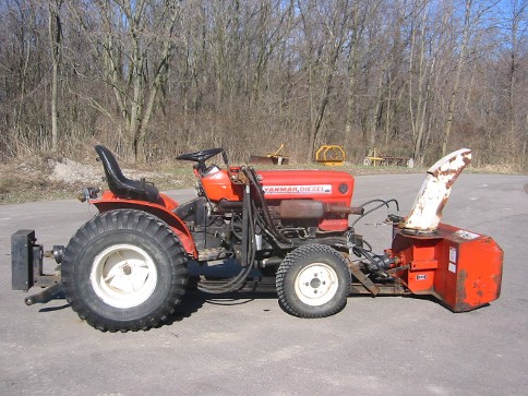

This is the side view. I replaced the clutch this summer and it turned into...I'll paint a few parts...I'll fix some other stuff. 4 months to replace the clutch. Work on your snowblower only before winter so you don't loose track like I did. Ask any questions on this post and I'll try to answer them. Good Luck, snow throwers are fun when there is no wind, you'll find out.

Sorry, but I couldn't find your directory in the photo section. So the pto comes off the rear and then travels forward? Is the driveshaft a single piece supported by the frame? This looks like a easier method for powering the blower than what I was planning so I'm very interested. Can you give me a link to your photo section?
   / front mounted snow blower Q's #9
Re: front mounted snow blower Q\'s
Cord, I'm at work and can't get to photos for a link, but it's in the Member Photo Galleries - pick "S" from the alphabetical index thing on top and scroll down to Skinman. There are a number of pictures there with some notations. A single 1" (?) dia. shaft runs from back to front. The frame is 3 or 4" channel with the webs facing out. 3 or 4 pieces of welded flat stock keep it together and the shaft goes through the flat stock. Holes are drilled through the center of each flat piece and a flanged bearing is mounted to each to support the shaft. I'll try to get the link later tonight if the kids cooperate and mom is tended to (arthroscopic surgery yesterday). Let me know if you would like any dimensions.

Oops, the web of the channel is facing inward, just looked at my own pictures on this post.
