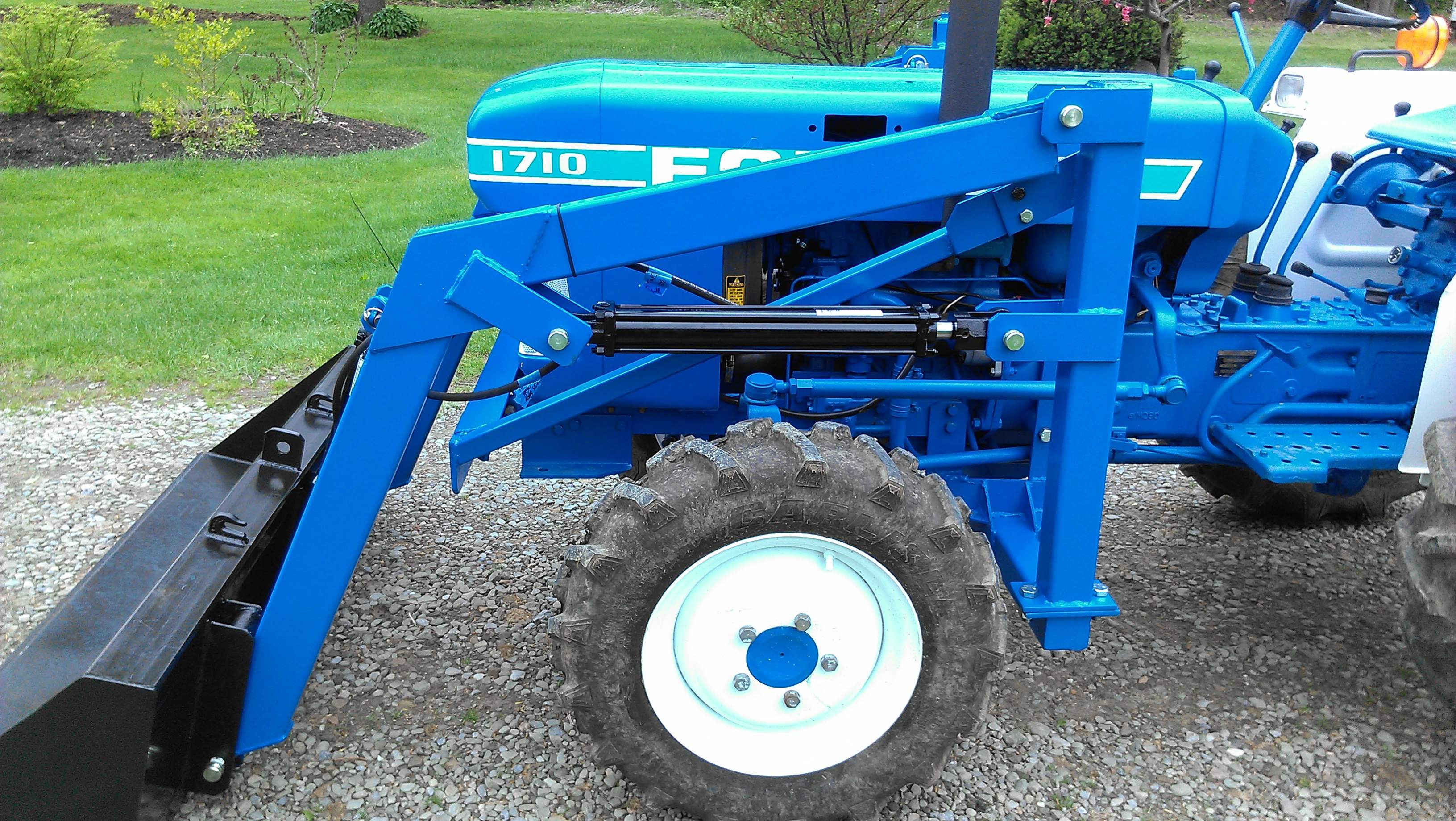

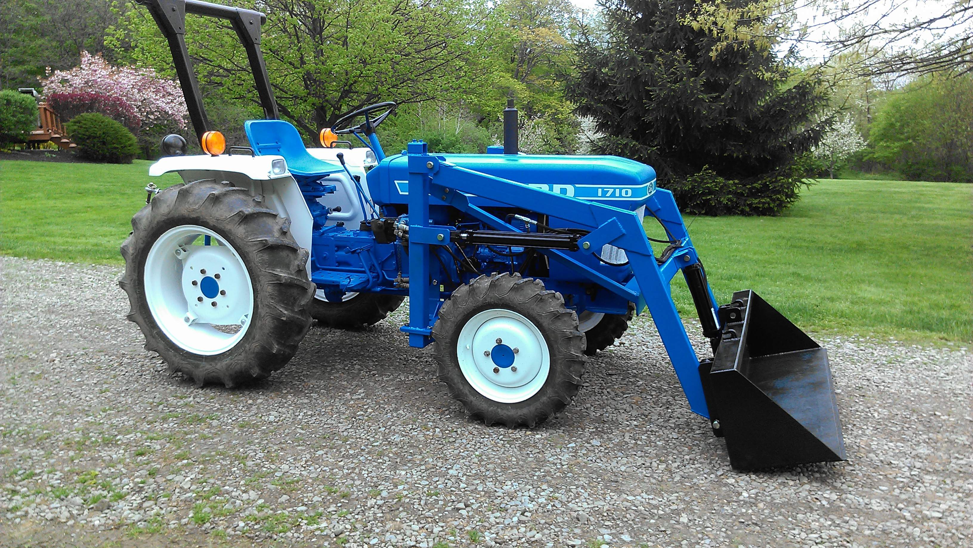

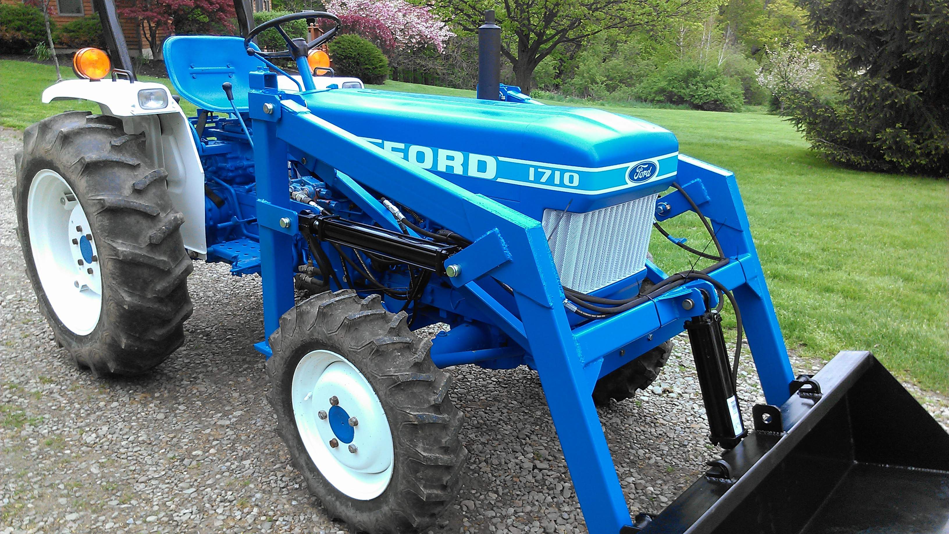

Thanks for all the replies. I would post pics but i have the whole thing disassembled for painting. I found a previous post where the dealer said that the purpose of the chain/sprocket was to reduce the speed to 540. I guess thats why they are saying that the 715A blower was the same front or rear mount, the only difference is the mounting kit. I attached photos of the tractor and Coldwater loader if anyone is interested. I will post pics of the blower once its finished.
