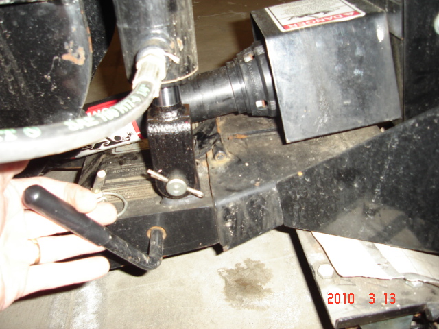

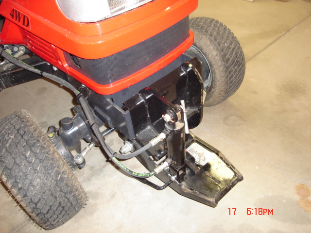

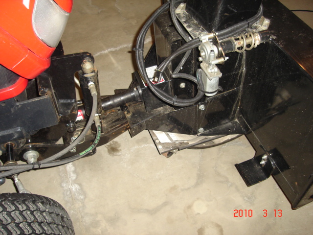

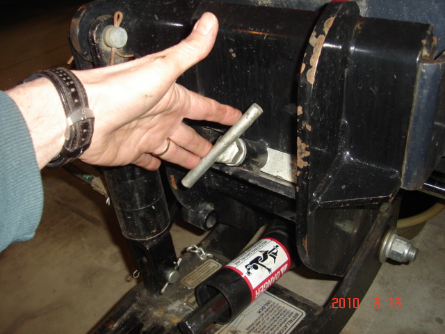

Paystar-- removing blower & quick-hitch:
1. Unlock locking lever by flipping up, after removal of lynch pin safety.
2. Disconnect hydraulic lines (2) and electric feed --for chute controls-- if necessary.
3. Slide blower off front, using a dolly w/rollers
4. Remove mid-PTO driveshaft (quick-disconnect at rear).
5. Loosen large "T" nut at front of quick-hitch.
6. Tilt forward, lift, and remove quick-hitch assembly. (It just "hangs" on front of frame.)
That's it; about 6-7 minutes, if you're slow like me!:D
FEL operation does not interfere at all with the quick-hitch assembly, but the Q-H does hang down pretty low on the front.
