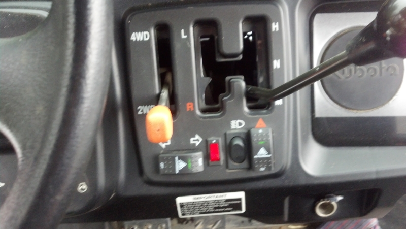

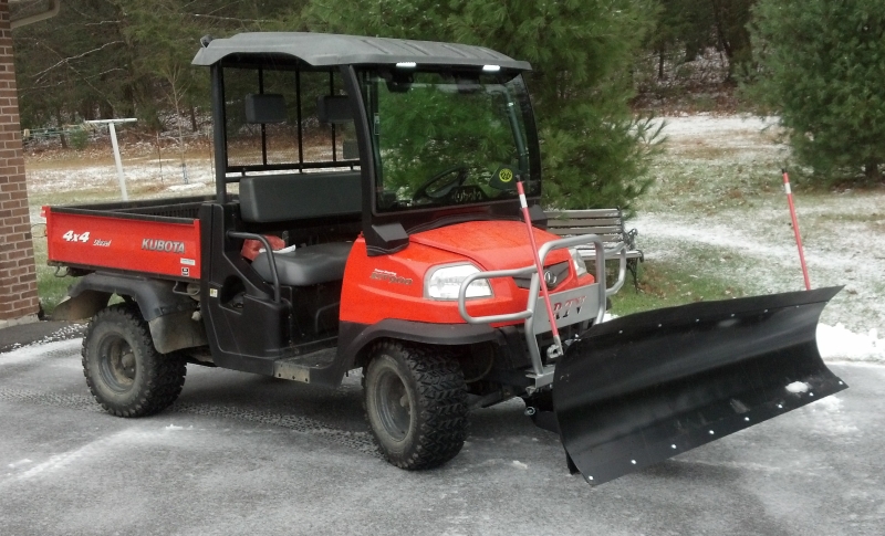

Update on my RTV-snow plow. I went ahead and purchased a 72 inch Denali Pro country blade package from MotoAlliance. This included everything I needed - plow, custom mount tube for the RTV900, plow markers, rubber top flap, skids, winch snow strap, and all the hardware. I couldn't resist the HydroTurn option (electric-hydraulic right-left control), so I added that, as well as the dash switch. I also got one of their winch packages, the Viper Elite snow winch and mount plate for the RTV and dash switch.
I am not the most experienced mechanic, but I am happy to report that the installation of the blade and winch and mounts went very well. I was not aware that I had to drill a few holes in the bottom of the bumper support for the mount tube, but it turned out to be pretty easy and it was nice to see the blade mount so well-attached to the RTV.
The electrical was a little more stressful for me, but the instructions were good and I got it all done. I was pleased to see that the optional illuminated dash switches fit perfectly into holes in the RTV dash. I used the 'horizontal' turn signal blank for the right/left control and the 'vertical' hole for the winch up/down. The plugs just popped out and the switches fit right in.
The quality of the gear and the fit and finish are excellent, IMO. Service was great too - the first plow became lost at a UPS facility and Motoalliance got a new one on its way within a day. Impressive.
I have a 2005 Worksite RTV900 and am trying the blade without the optional RTV heavy duty front springs. I don't see any problem so far, although I do feel the front settle down a little when the winch lifts the blade.
Operation: I had a chance to plow some snow today. To sum it up - what a dream! I am used to a little 'excitement' with my B7800 on the inclines that I have to deal with, and I was really wondering what the RTV would be like out there. Well, I never even bothered with 4WD and it went down and UP the hills with plow down with no slipping. Now this was a test run with only a couple of inches of dry snow, so it is not a real serious test. But my B7800 tires always tended to ice up the driveway by compressing a thin layer of snow, and this makes it nasty getting up and down the inclines. The RTV does not seem to do this, so far. I went up and down multiple times and there was no icing up. What was really nice was the speed and maneuverability of the RTV compared to the B7800. And the cab! And being able to adjust the blade side-to-side with a dash switch! And having the blade in front so I could watch my direction and plow at the same time without hitting any curbs. With that rear blade on the B7800, I would tend to go off the road at the front (if I was watching the blade and curb way back there) or the hit the curbing with the plow if I was facing forward and watching where I was going. So I had to go pretty slow to keep on track. With the RTV, I can plow darn fast. I think I can even use the country blade to throw the snow pretty good, but I need a little more of it to find out.
The only downside so far is my desire to really scrape that snow down to the pavement. I have to look at the blade angle to see if I can tilt it forward a little to get the best contact between the blade and asphalt. It is not bad, but I feel that the drive is not quite as clean as it would be with the rear blade on the B7800. I am not using the skids, so the blade is resting on the pavement when I plow.
Overall, I am very happy right now, so bring on more snow!
