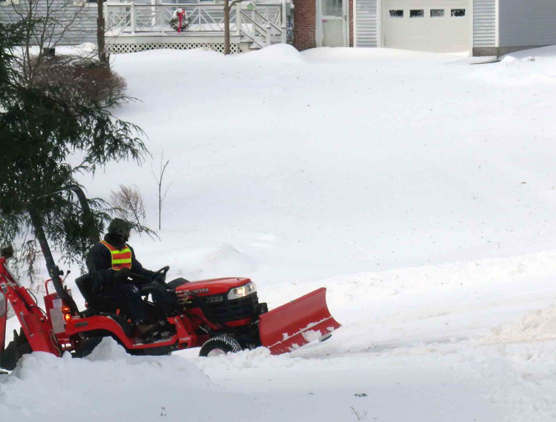

I have the 60" Front 4 Way Hydraulic Plow (BX2763) with Quick Hitch (BX2751), & skid shoes on a BX23. I keep the backhoe on (tires loaded) and have no trouble plowing a 450' drive. The upper part is trap rock & the rest is process stone. I have to back blade the trap rock until it gets a layer of frozen snow on it, but the rest is plowed normally. Once everything was frozen I took off the skid shoes. I have turf tires & the traction is no problem at all. If I'm pushing a lot of snow with the blade angled the front will sometimes slide over a bit. Just back up and push it again. My dealer is looking into a set of front AGs (loaded) w/rims that I can put on for winter use that should stop the front from sliding. The front sliding doesn't happen a lot, but if the front AGs aren't too much I'll give them a try.
If it's windy the snowblower will kick up a lot of snow in your face that you don't get with a blade. As you can see in the attached pic, there is a bit of a hill, but the turf tires have better traction than I thought they would. It easily pushes snow the way I'm facing.
