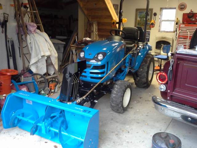

I rec'd some (wise) advice to look into the LS Tractors so I've been looking at the J2023. Looking at the Mahindra and the Kubota, I see that they both have a front snow blade available but I don't see one mentioned anywhere for LS on their site and nothing came up on Google. If I went with LS and wanted a front snow blade, am I out of luck?

No you are not out of luck, you can use any blade with a quick attach. (Sized for your tractor of course!)
Something like this: HLA Snow

E3A. I've been researching subframe mounted front blades for a few days now. I have a BMX184H front blade and subframe. The MF 1550 and the Kubota L2184 are the same blades, with hose length and couplers maybe different. I found this information from the company that makes these blades and subframes. For me the thing to consider is the cost difference of a front loader and bucket vs front blade and subframe. I asked a local LS dealer about their front subframe mount snowblower and have not heard back. lt190b
